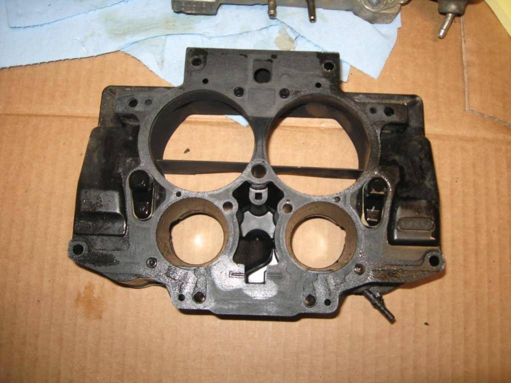

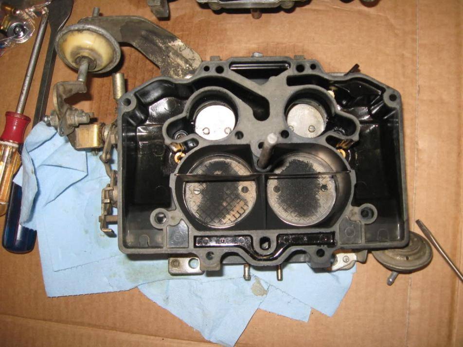

    My guess is one of the O rings are bad or misaligned where the body connects with the top. Another possible problem is a cracked body on the underneath. I tried to circle where I am speaking of but could not get the program to work. The O rings are in the wells of the first pic located by the front butterlies. In the second pic on the body you can see white compond where the body has two pieces glued to it. The glue wears out and leaks sometimes.
