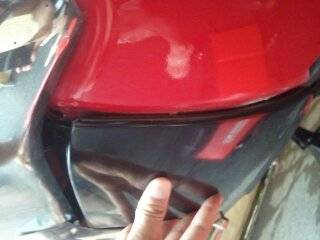

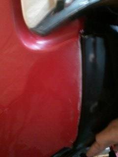

Just got the valance and the right side is too long and the bolt dosent line up.

Are you comparing it to the other valance or to the mounting holes on the fenders ? Pictures sure help. Too long and doesn't line up really don't tell us much.

I put the valance on the car and on the right side where the quarter meets is not lining up.

Is it a small amount or a large amount? We can't see what you see. Even original factory sheetmetal sometimes needs to be fitted. No two cars are exactly alike.

Right side
This is the side that I'm having problems with.

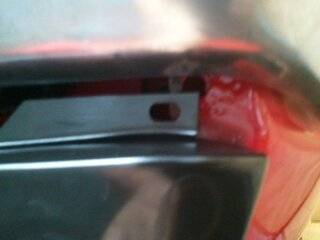

07-20-2012, 02:47 PM #9Senior Member
- Join Date
- May 2012
- Location
- Canada B.C
- Posts
- 111
- Thanks
- 0
- Thanked 1 Time in 1 Post
left side
This side is fine.

Thanks. Much better with a picture. You say it is too long. How does the new panels' contour compare to the original valance? If it looks the same, the contour of the r/r fender may need work. If it looks different, the new panel will need work. Do you have much body/fender experience ? Has the car had possible repair to the fender in the past ?
