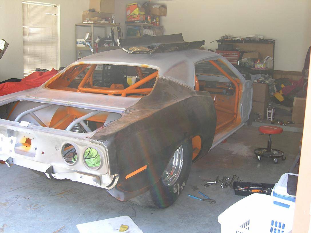

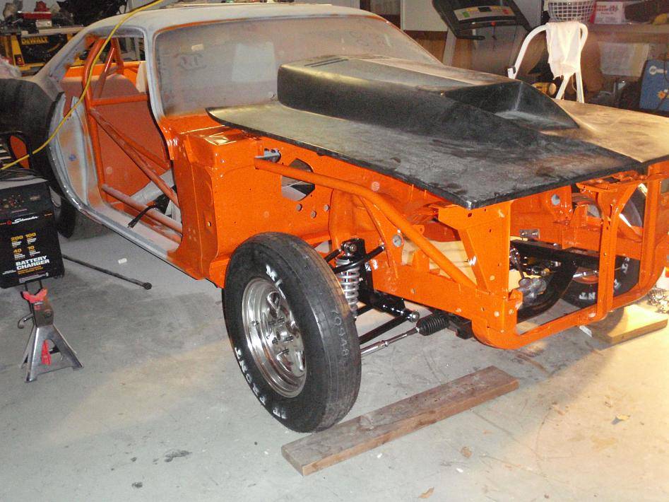

Old 10-12-2009, 04:02 AM   #13
Mr.Mopar
Junior Member
Mr.Mopar's Avatar
Join Date: Feb 2009
Posts: 9
Default
updated pics. plugging right along. should be finished by feb 2010
Mr.Mopar is offline   Reply With Quote

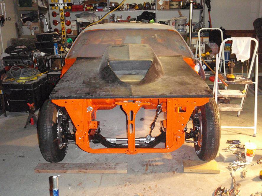

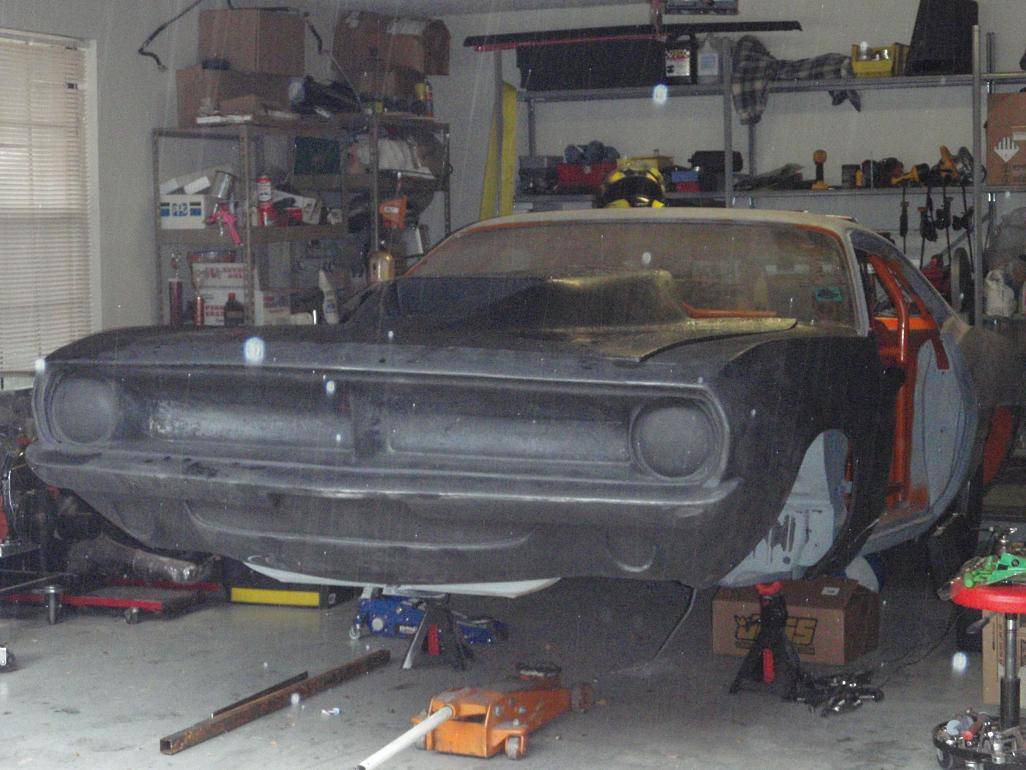

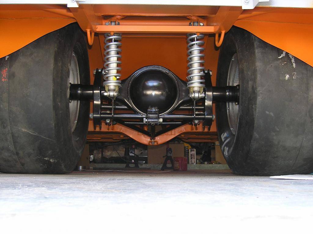

Old 02-16-2010, 04:45 AM   #15
Mr.Mopar
Junior Member
Mr.Mopar's Avatar
Join Date: Feb 2009
Posts: 9
Default roll cage requirements
To answer your comment on the roll cage requirements, read below. thanks for checking out the old hotrod. I have attached a few updated pics . its coming alng slowly.
9.99 1/4-mile (6.39 1/8-mile)/ 135 mph or quicker:
-Roll cage is required on all vehicles at 9.99 and quicker or any vehicle running 135 mph or faster (regardless of e.t.). The roll cage must be constructed of a minimum o.d. mild steel or chrome moly tubing (moly can be a smaller o.d and is lighter but more expensive), see diagram below for specs. Roll cage must be padded anywhere the driver's helmet may contact it while in the driving position, see diagram below for specs. Roll cage must also be certified by NHRA every 3 years and have a serialized sticker affixed prior to participation. This style of cage is good til 8.50 1/4-mile times, then a funny car style cage is required.
See diagram below.
Roll Cage Diagram (good to 8.50 1/4-mile elapsed times):
