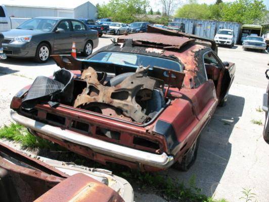

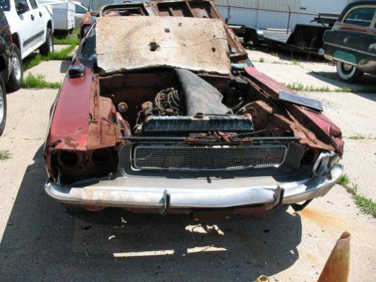

Here is what she looked like when I answered the ad. Brace yourself!!

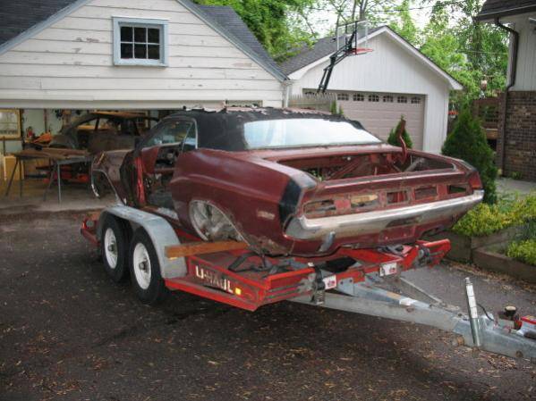

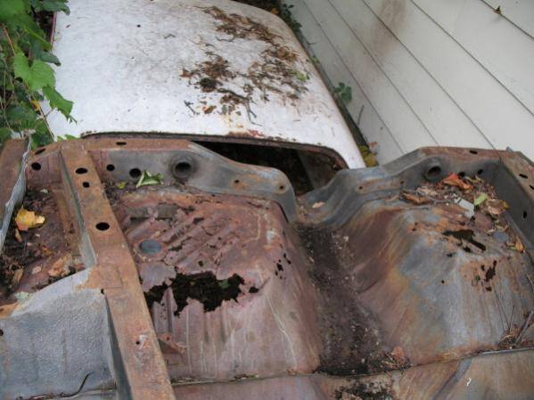

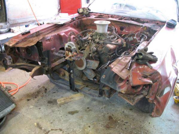

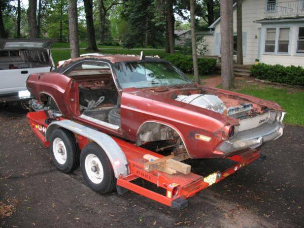

Most of the interior was missing along with the hood and trunklid and the top yoke of the radiator core support. The guy that owned it also didn't include the rear end and the front spindle/hub/drum assemblies, which were removed after the previous pics were taken. I had a couple of weeks to come up with the parts to make it a roller again before I actually went and picked it up. Loaded onto the trailer with a fork lift, got it home, installed the replacement suspension parts while on the trailer so I could roll it off in my driveway. Luck would have it that the doors had been stored inside the car for a lot of those years and are in pretty good shape as far as rust is concerned. The 15" ralleys were long gone as well and at this point the engine was siezed, but I was VERY happy with the deal I got on it. More soon.:D

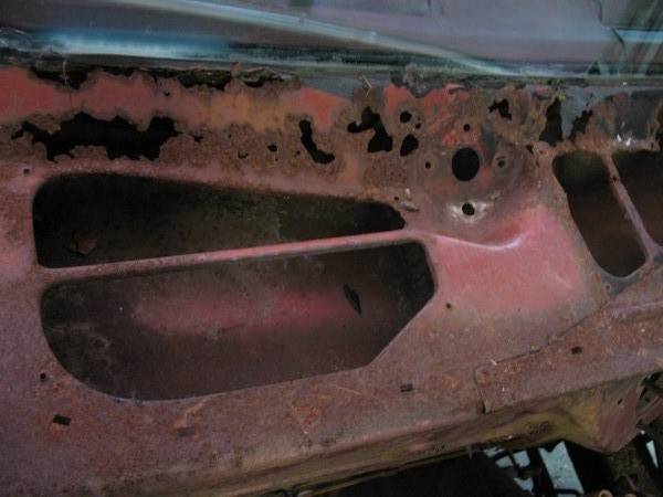

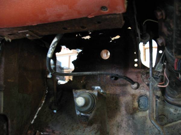

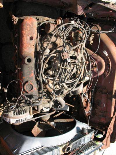

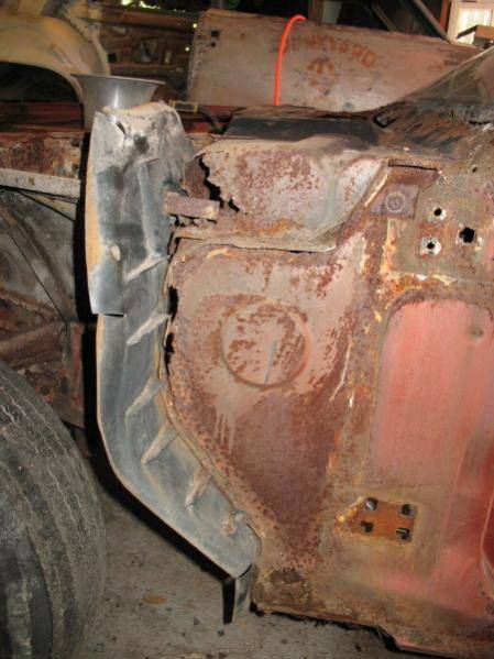

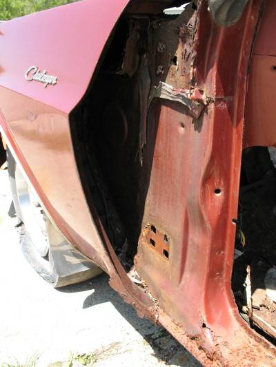

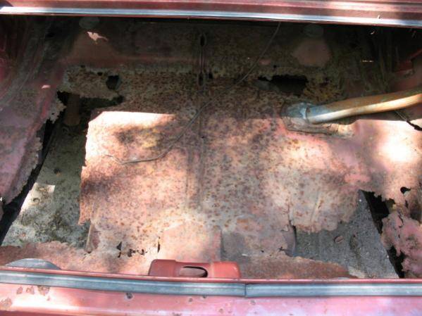

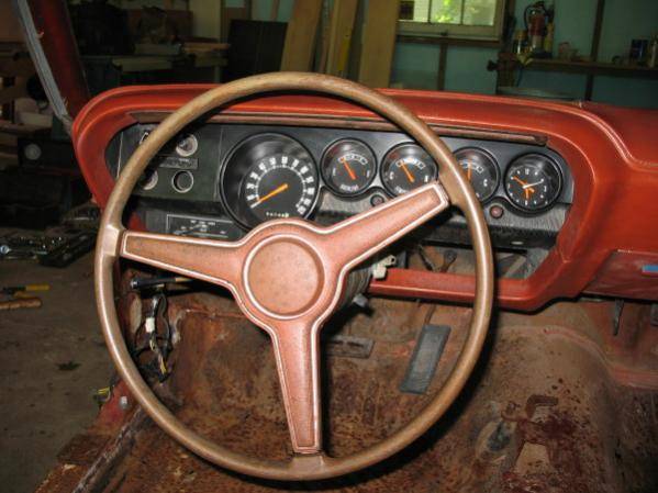

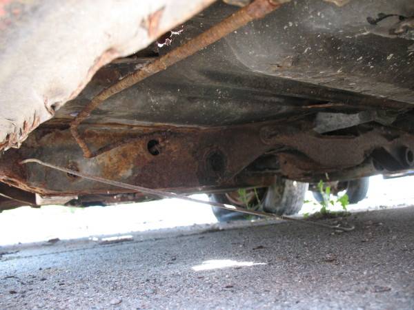

I spent a little time dismanteling it and cleaning it up to see what I actually had and just how badly rotted it is. 974 radiator was still with it and in really nice shape and it was amazing to see so little missing in the engine compartment. It was missing the air cleaner, the exhaust manifolds, windshield wiper motor and the master cylinder.

When was yours built? Unfortunately the dashpad has cracks in it and will have to be replaced, but I don't see me actually needing one for a few years.

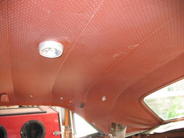

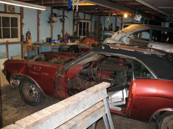

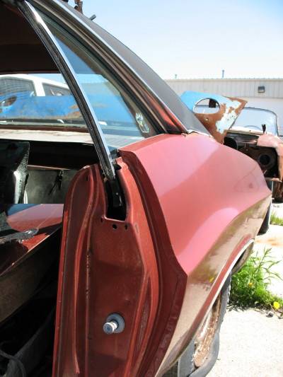

The doors ended up being in nice shape save for the crease in the drivers doorskin, they were stored inside the car for the last several years at least and have very little rust. I acquired a set of hinges and installed them on the car so they weren't taking up shop space and I could also start filling the car with parts that I have been accumulating. It actually started to look like a car again.:D

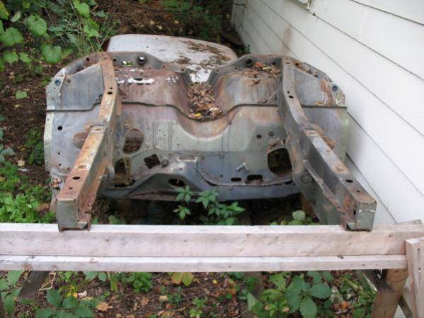

The first part that I accumulated for it was a structural front clip which included front frame rails, torsion bar crossmember, the other panels still attached to it aren't in great shape but might be useable for patches. Also picked up a doner roof for it.:D

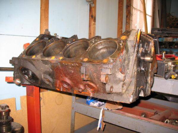

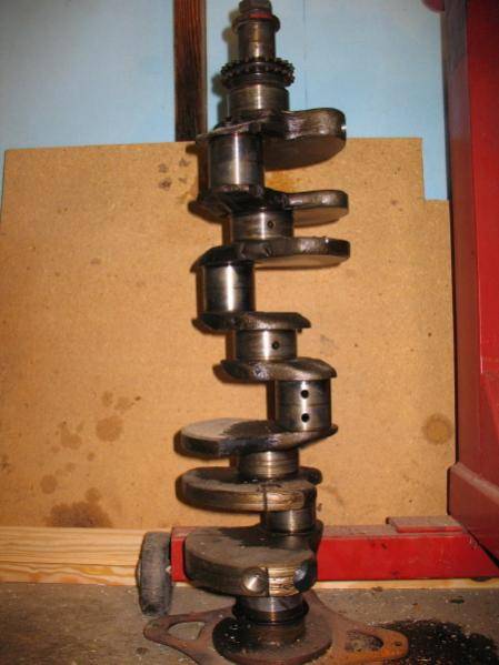

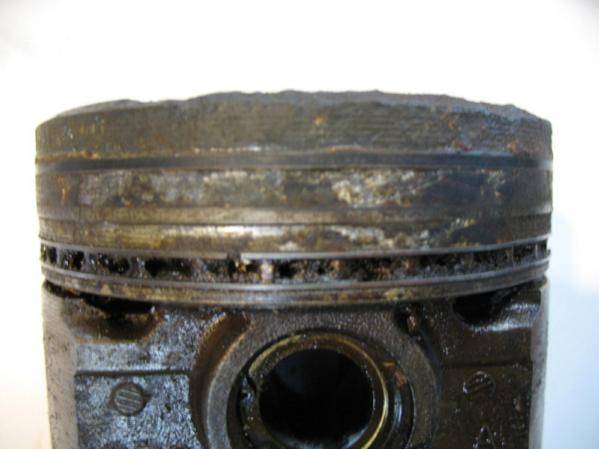

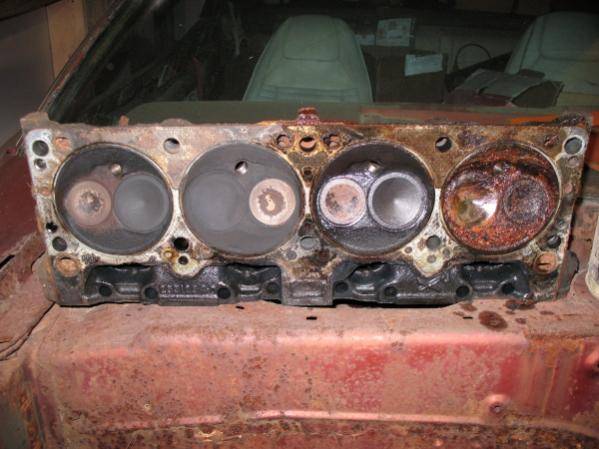

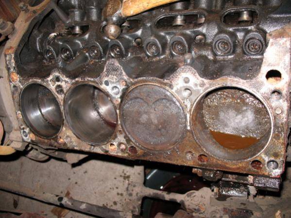

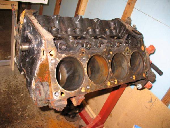

I've known this for a while, but I didn't want to post about it until I had it completely apart. I needed to move the car out of my shop because of a big concrete countertop job that I recently started so I found one of my neighbors had an empty garage and was willing to let me keep it their for a couple of months. Before I moved it I wanted to pull the engine and trans for 2 reasons, first I didn't want anything leaking on there garage floor and I had been filling the cylinders with the concoction to try to free it up, so it was kind of a mess and second I really wanted to get the engine apart to see why it was stuck. I had recently pulled the heads to see if I could get to the bottom of it after which I did get it to turn over a little. I had found one of the cylinders was filled with a rusty, sludgy sediment, but couldn't really determine why, so out it had to come and on to an engine stand. I got it pulled apart without any issues except for the one stuck piston. None of the bearings were in that bad of shape and the other 7 cylinders showed signs of a crosshatch pattern from the last hone it had. It had been apart before which was a bit of a suprise, I thought that with only 60 some odd thousand on the odometer that it might never have been apart. Rod caps were all stamped and you know they didn't do that at the factory. Today I got the last piston out of the block along with the cam and I can now confidently say that there is nothing seriously wrong with the original engine and I am very relieved because that made the allready smokin' deal I got on this car that much better!:D I will take it to the machine shop to have it cleaned and checked, oiled and bagged for now.

Good news on the engine, bud. Even better that you're working at it. Some folks would have simply given up and found another.
