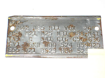

Do you have a fender tag or broadcast sheet? V6X or other is what you are looking for.
kenneth
Nov 20, 2023
7
Nc
i have the fender tag, I can't get a picture that you can read but it is
N85 R22 V5X Y05 26 EN2
M21 M25 M31 G31 G33 J45
V1X A01 A05 A36 A62 B51
FC7 HRX9 000 B16062998
E63 D32 JS29 NOB

Your R/T SE looked like the advertising brochure car without any stripes. No stripes on fender tag, so no stripes on car.
We can decode your fender tag if you post the codes or a picture of it. Sorry, I needed to scroll up further to see your fender tag codes.

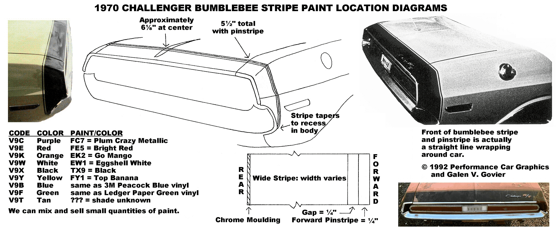

This is a great option so you get the look you want and no consequences. The deck lid emblems are over the wrap.
Not to hijack the thread but my Cuda is Purple and the complementary color to FC7 is Lime Green. The Joker cars (Plymouth Furys) from Batman had this color combo.
That being said, the FC7 Challengers were allowed a limited number of colors for the Bumble Bee rear stripe and Lime Green was not one of them. See chart.
If I had a 70 Challenger in FC7 and no other stripes, I would consider putting on a "never-built" Lime Green Bumble Bee stripe in the wrap material.
It would look unusual and cool.

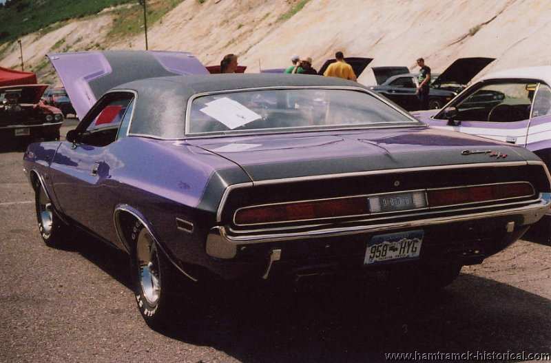

Also, I believe they introduced more Bumble Bee colors mid-year so the chart would have been updated via a service bulletin. Pictured FC7 with YELLOW stripe.
I will look for that or if someone else can post it, please do so.
