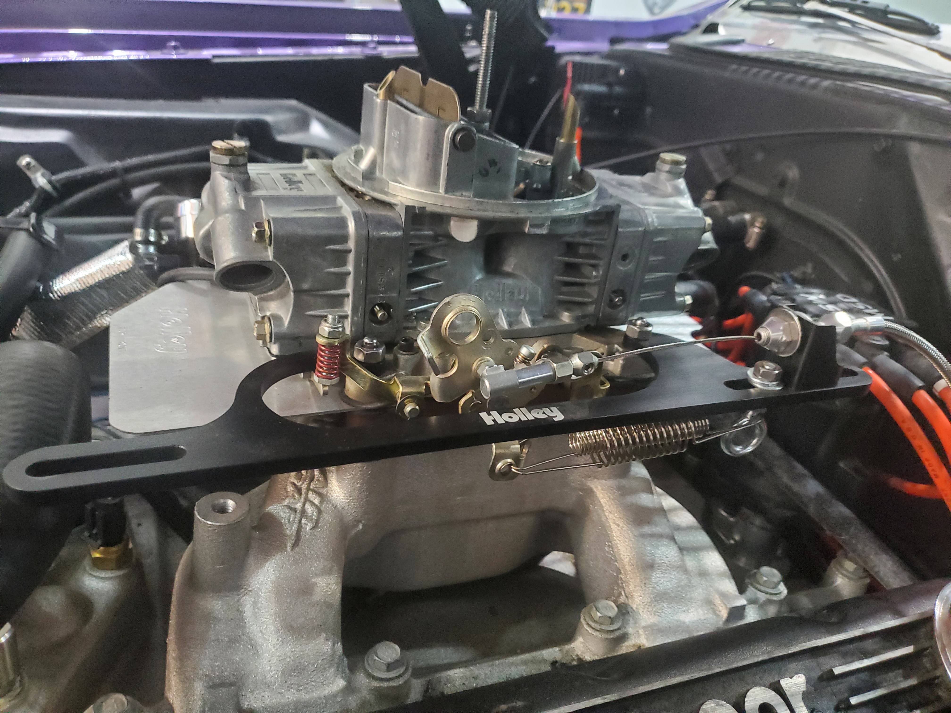

i used a Lokar cable with a Holley J shaped base plate. The Lokar bracket I first used kept rotating backwards.

Finally got to shop and remembered to take photo!
