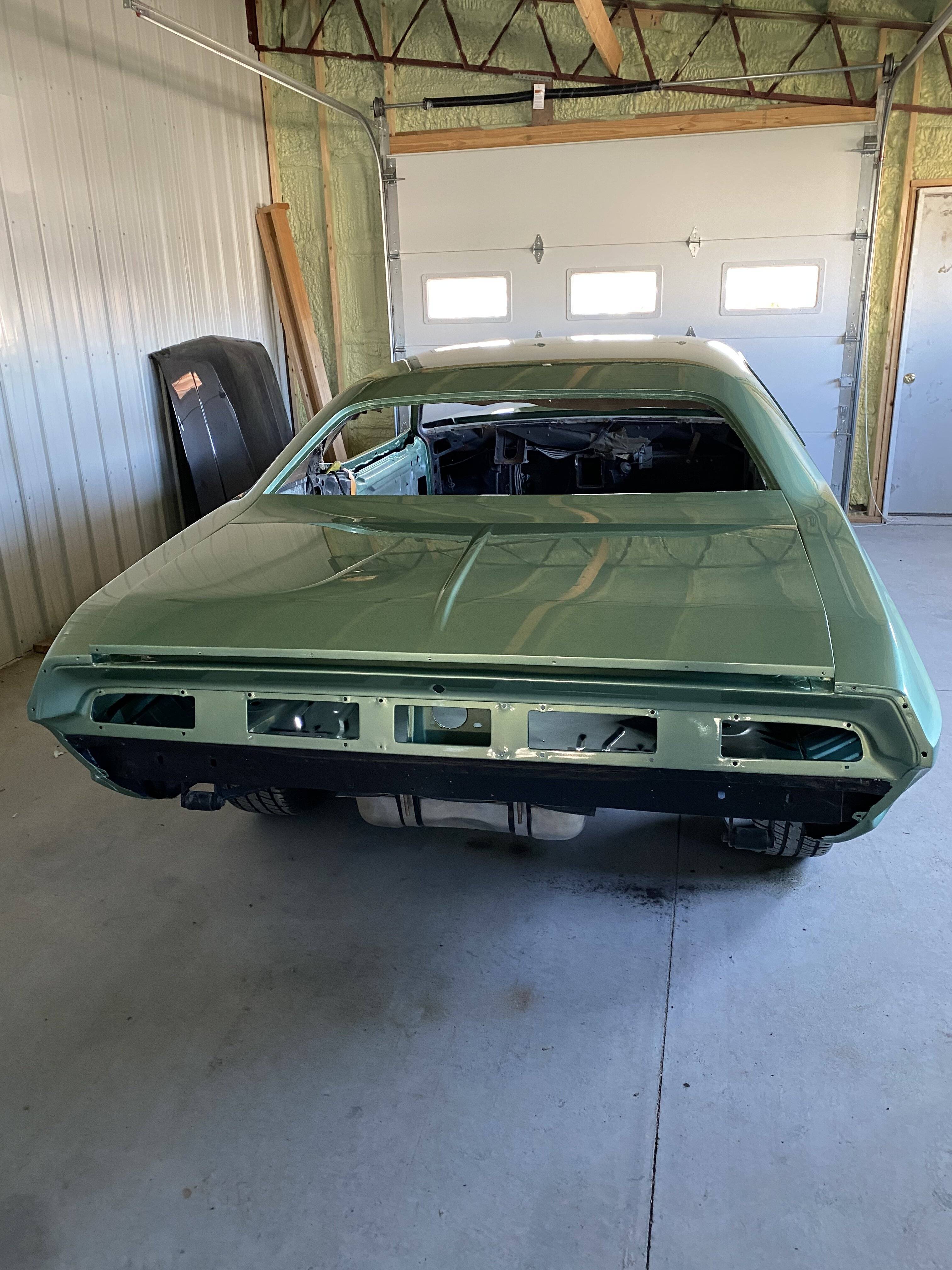

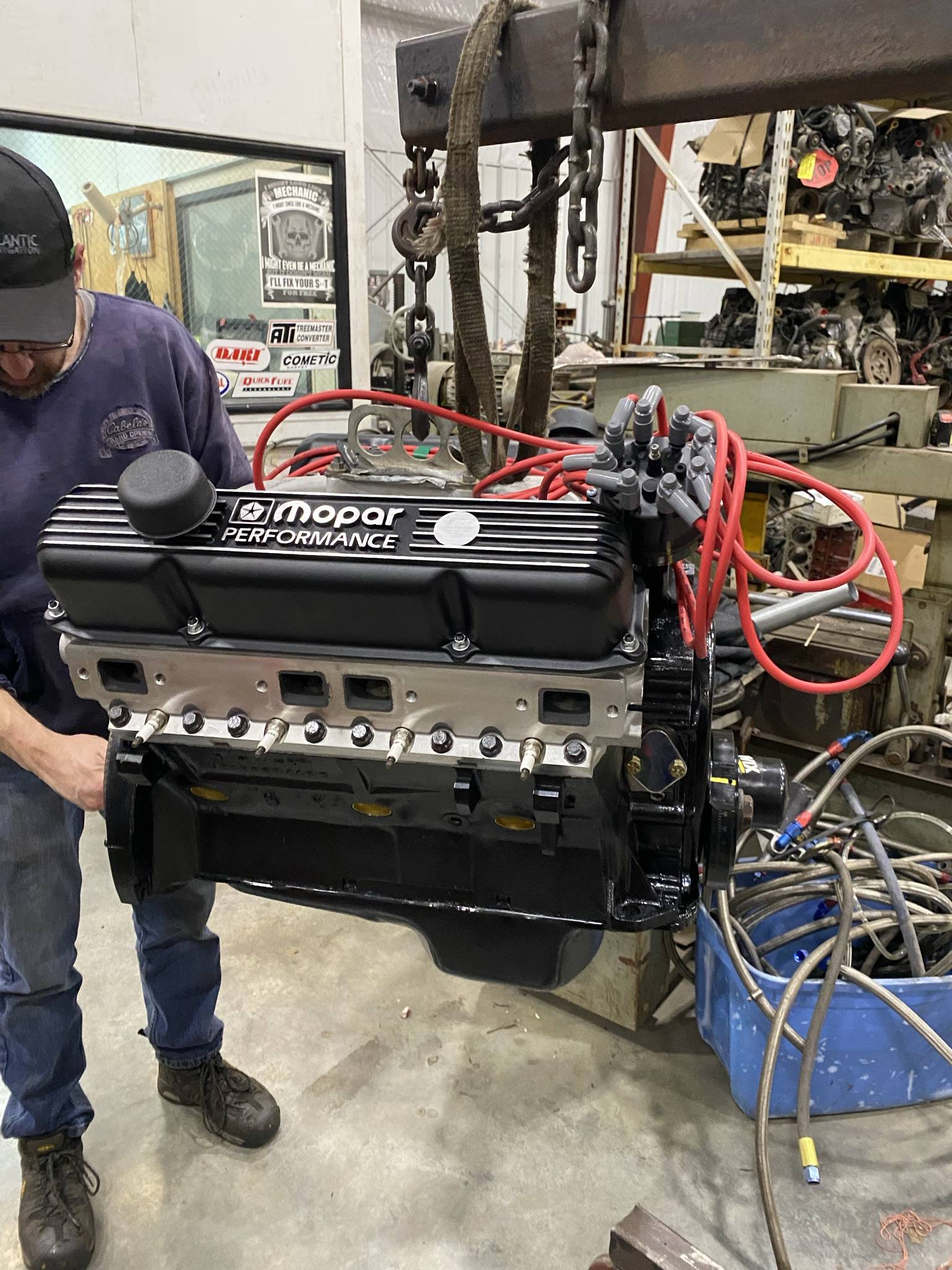

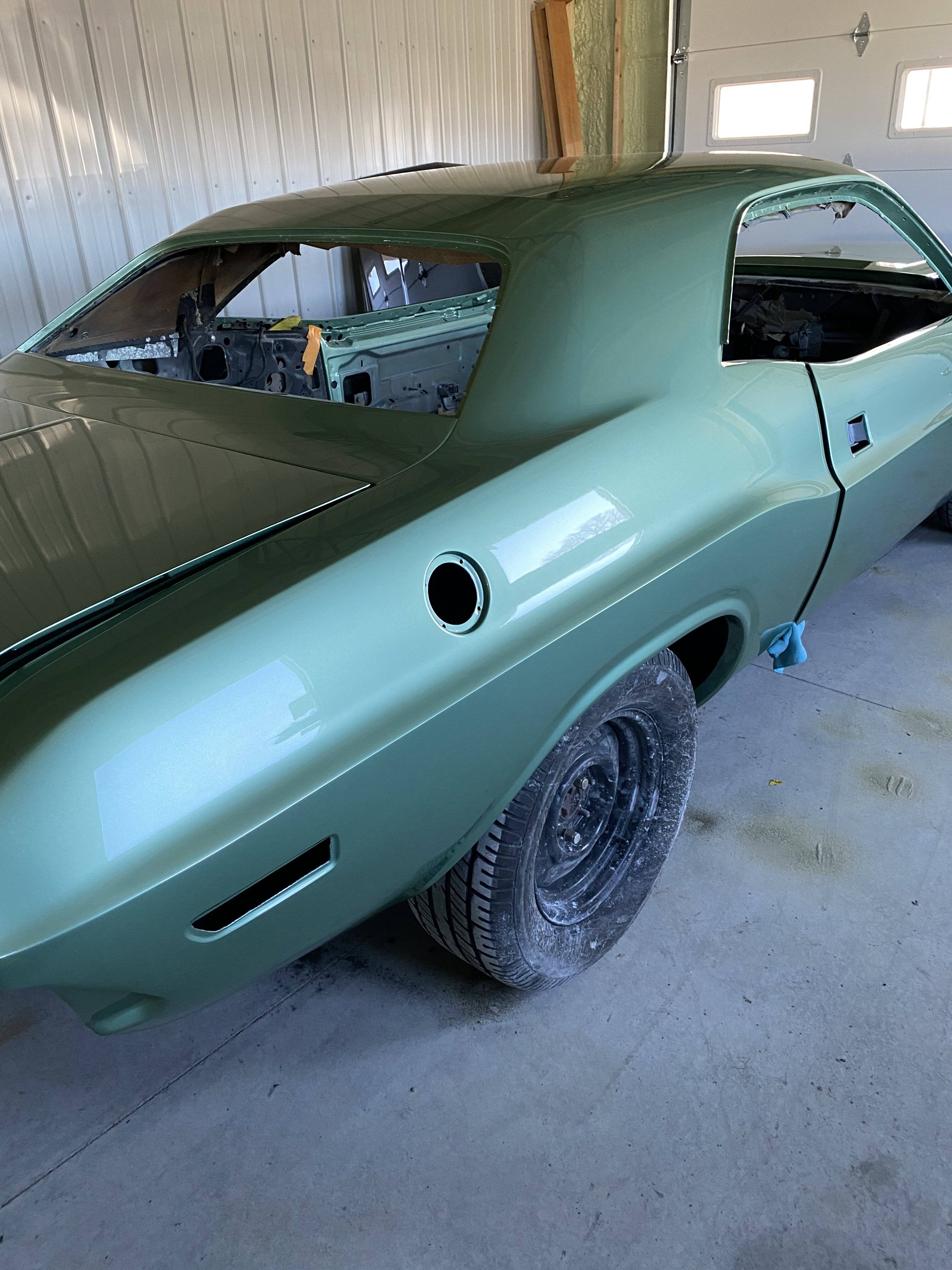

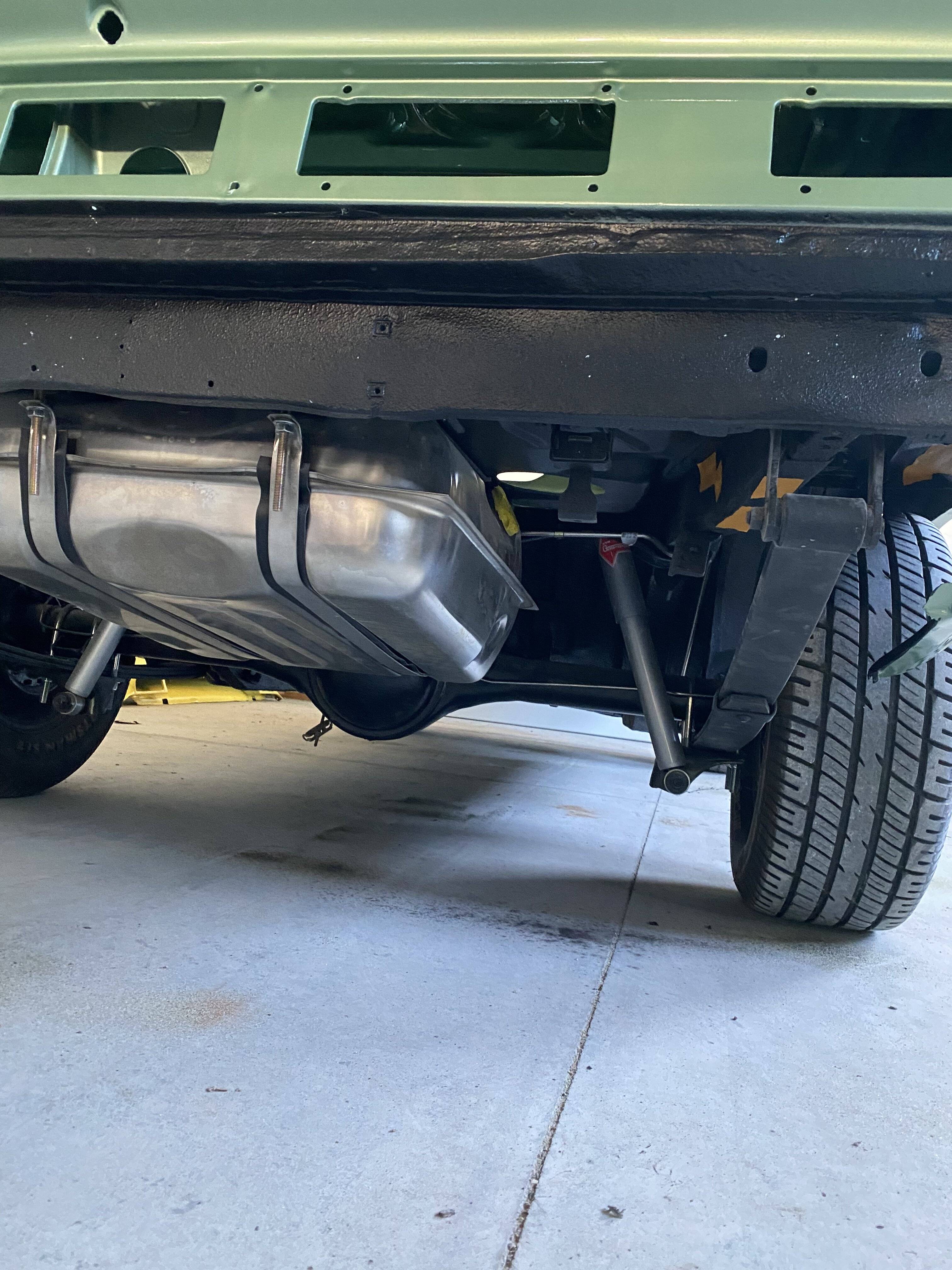

Hi all, new to the forum! Restoring 70 challenger rt. Moving along not a #s car. Owned it for 18 years and always indoors. Car came with a 400 auto on column ran and drove missing nothing with great trim. Also came with a hp1 440 which needed rebuilding and is the motor that was just rebuilt and going in.Needed quarters, trunk floor and front fenders. All amd metal work done and painted g2 frosty green poly. New fresh 440 did 540 on the dyno on pump gas. Motor and new silver sport tremec 5 speed complete kit are onsite and going in soon. New tank, all lines complete poly front end rebuilt with hotchkis t bars , upper arms sway bars drilled, slotted rotors. Looking to get the rally dash rebuilt which is in great shape other then pad. Thinking about aftermarket gauge upgrade along with a definite complete wiring kit, would love some input on the dash resto and which wire kit is best
