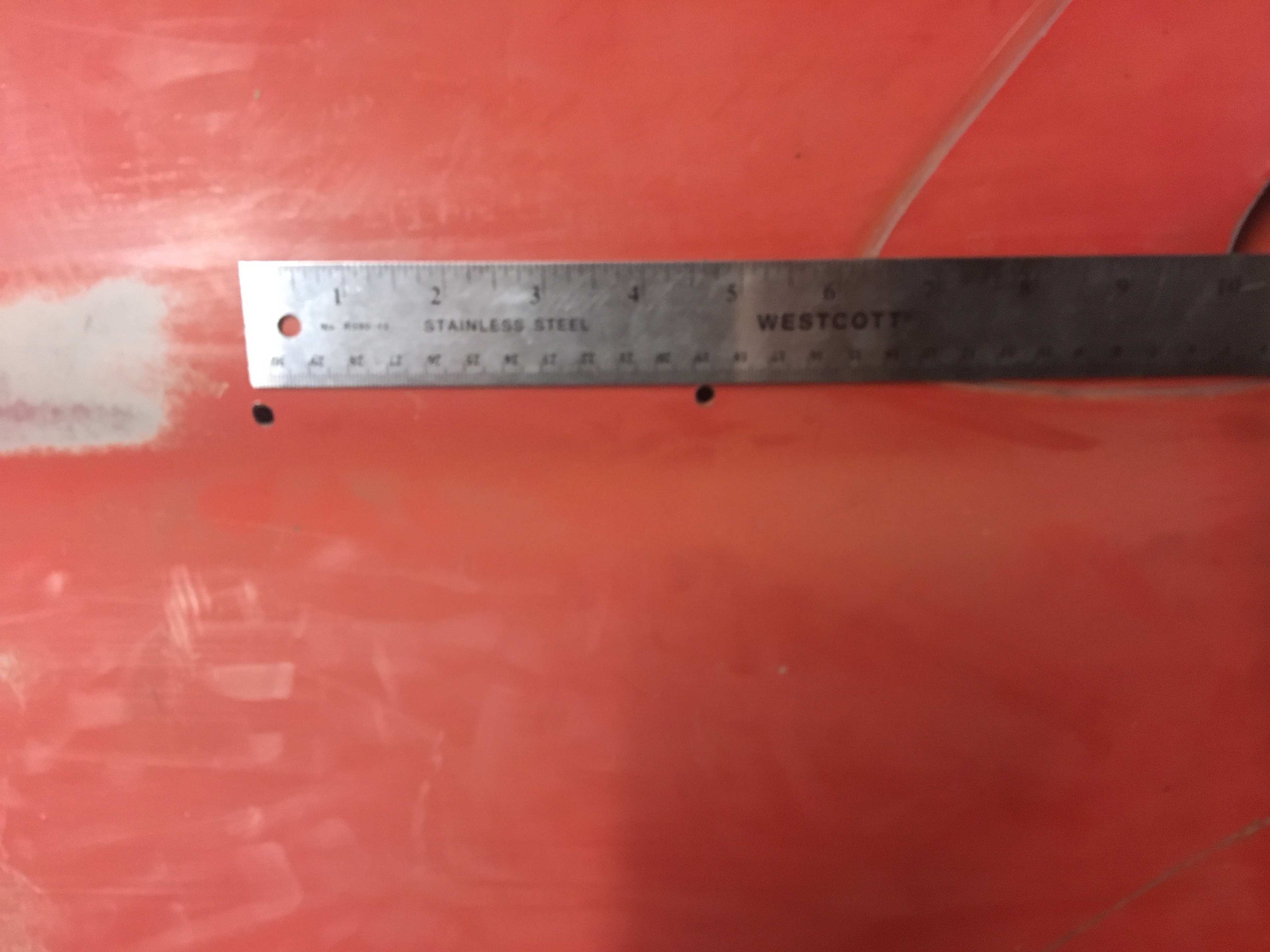

I Have a extra bulge hood for my 70 cuda and wanted to know if anyone can advise where to drill the holes to mount the emblem 340 Cuda thanks

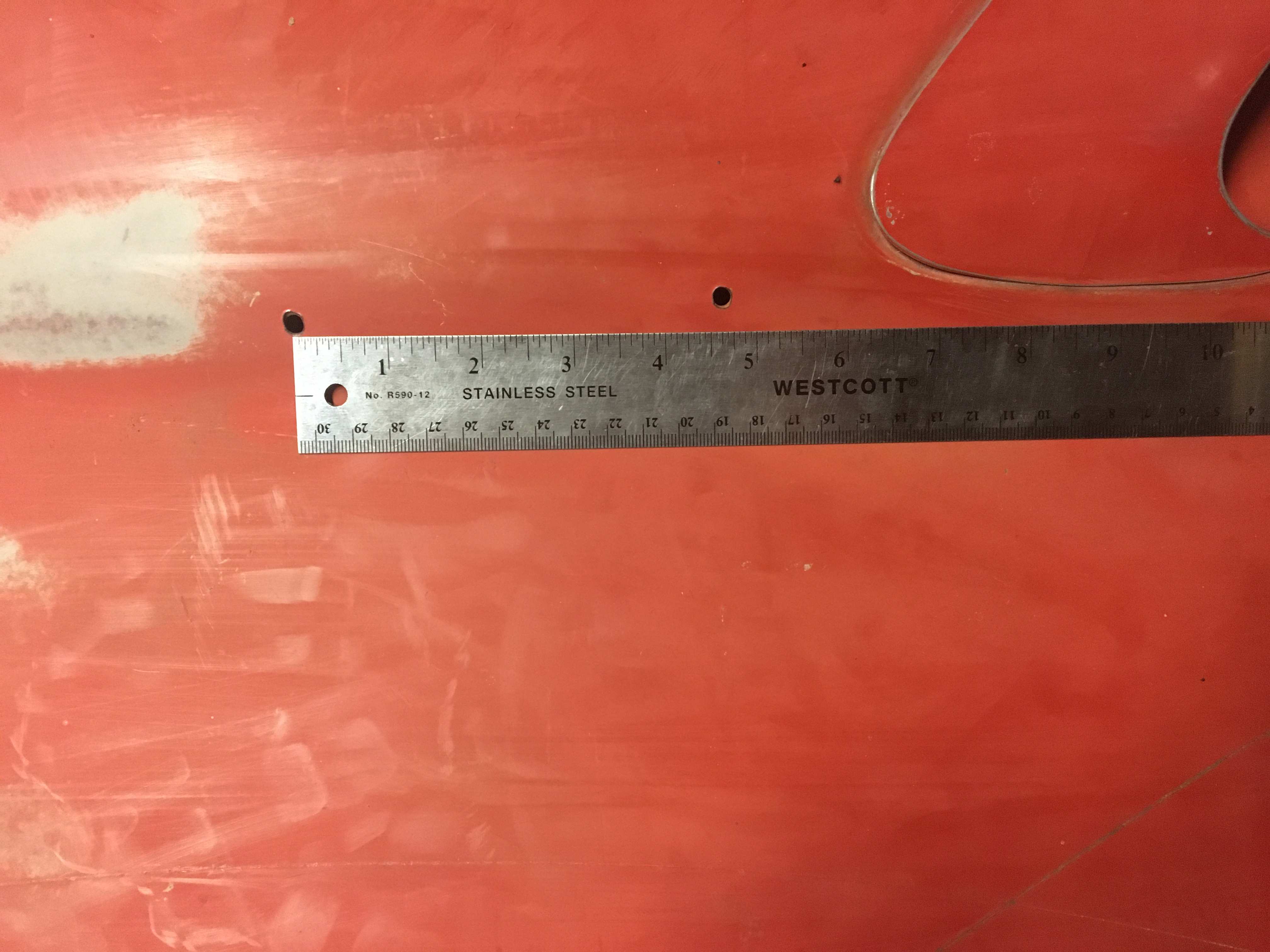

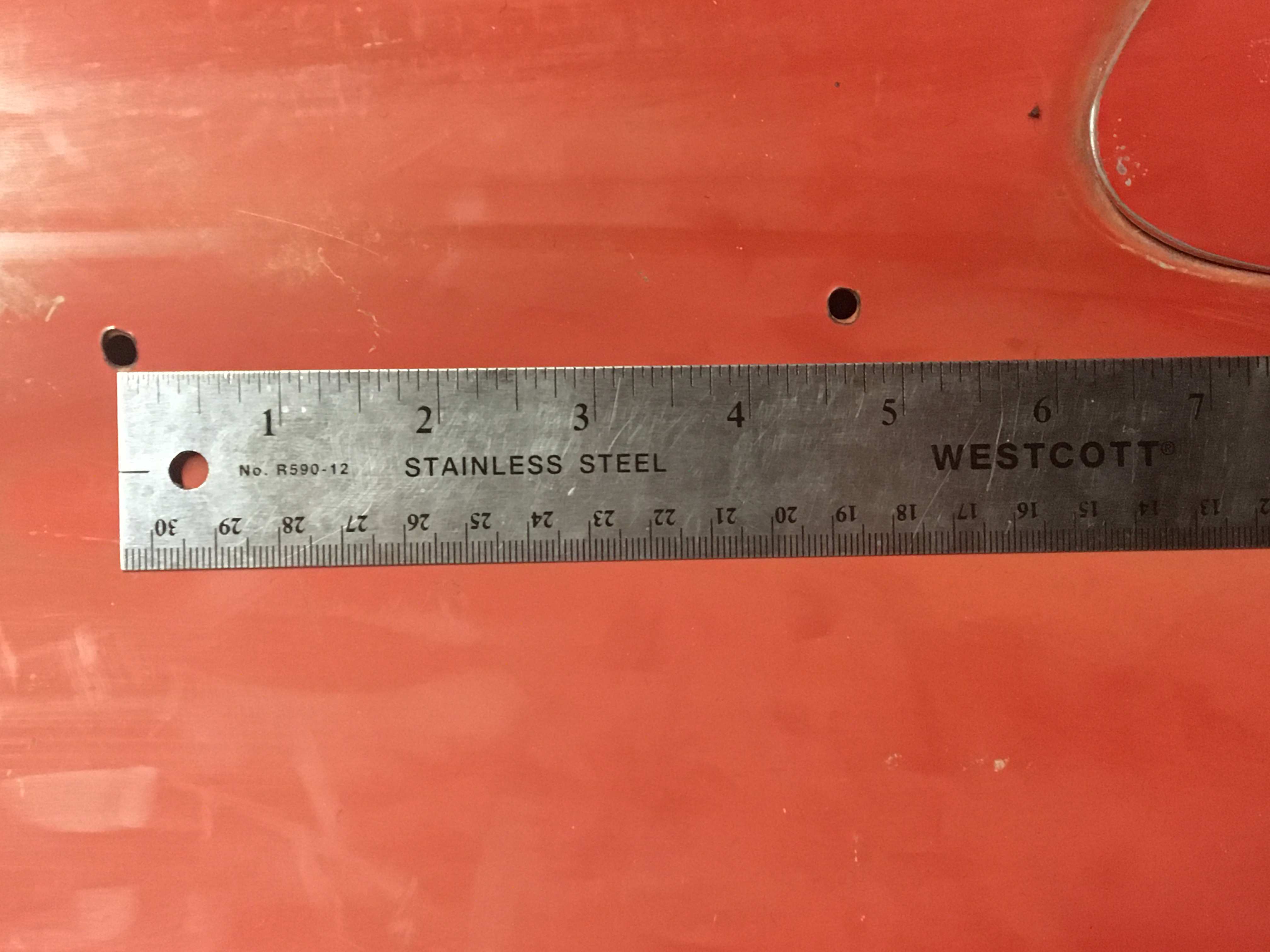

Do these help?

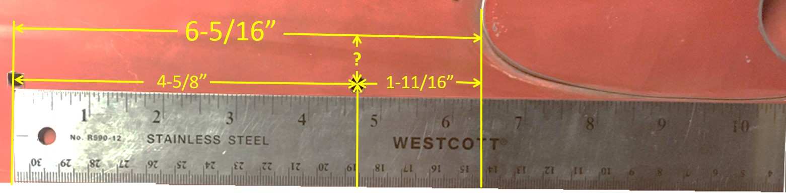

Are the various emblems all two pins with the same dimension or do they differ in pins and spacing?
Added the measurements to the pics above but one dimension is missing. Hard to get these holes right without more reference points.

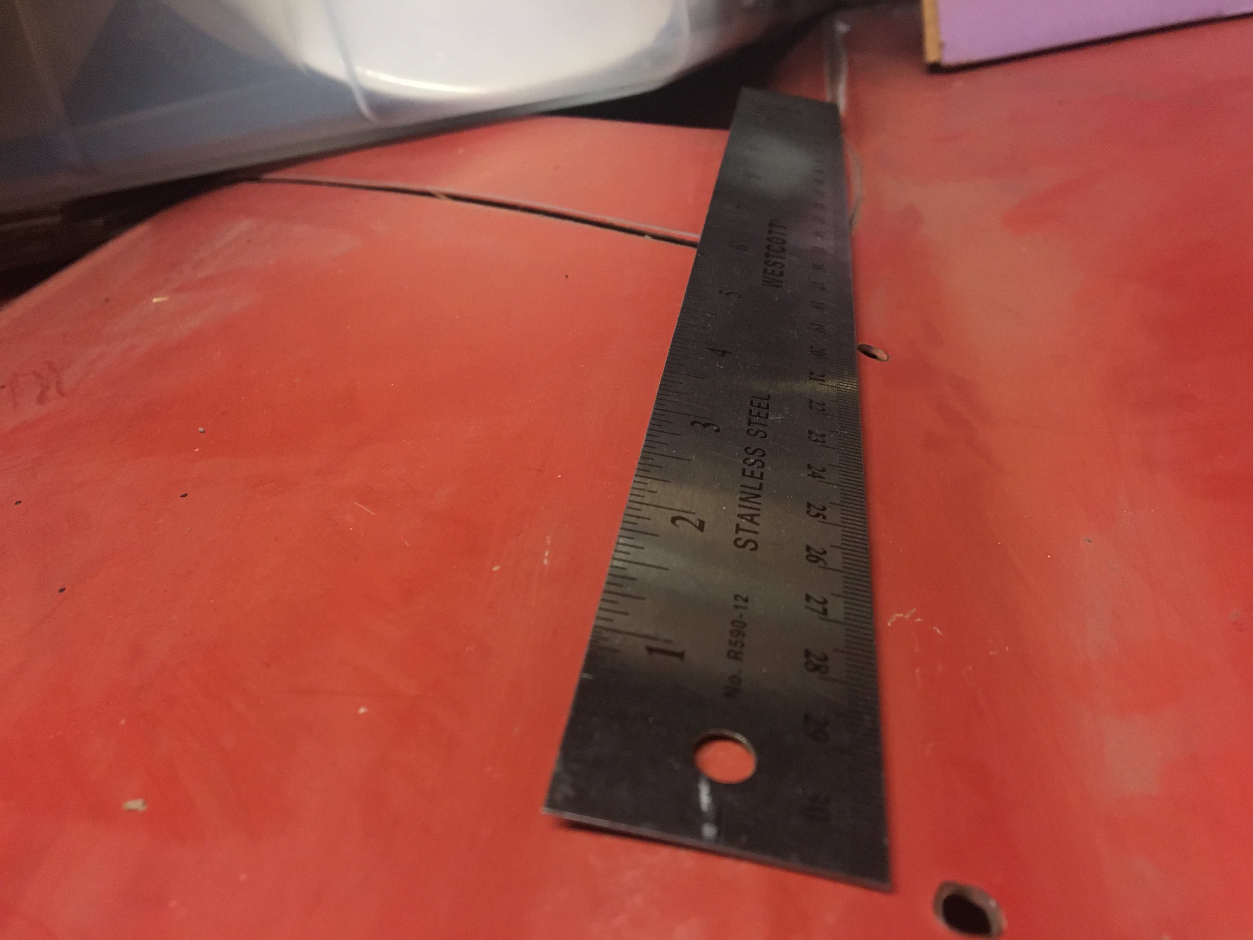

70 may be all two pins, but the barracuda hood I have (71 or 72) has three pins. Maybe the two vs three was different from plant to plant and which vendor made them?

I got "cuda 383" emblem, it has 2 pins. And I also got a "hemicuda" emblem, it has 3 pins. The spacing of the outer holes is the same. "Hemicuda" has an extra one in the middle.

All hemicudas had shaker hoods so the 3-pin for shaker makes sense.
