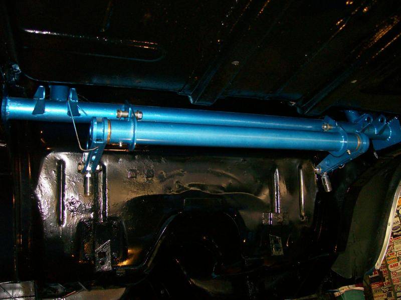

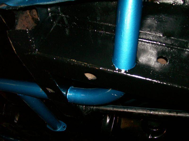

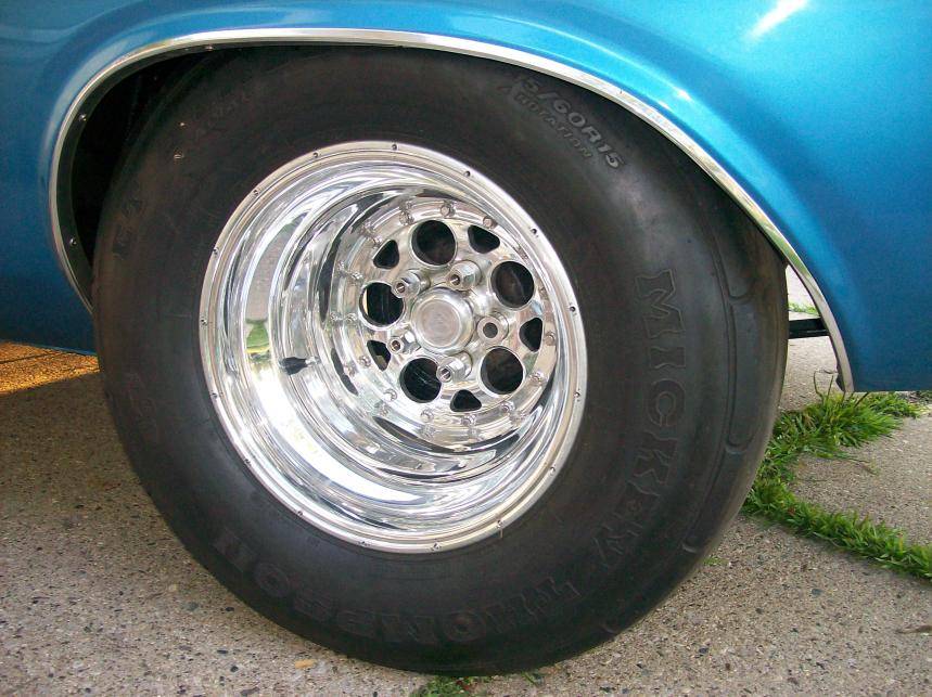

My 70' was already moved into the frame rail when I bought it. I would have done it like Chryco described but i haven't worried about changing it.

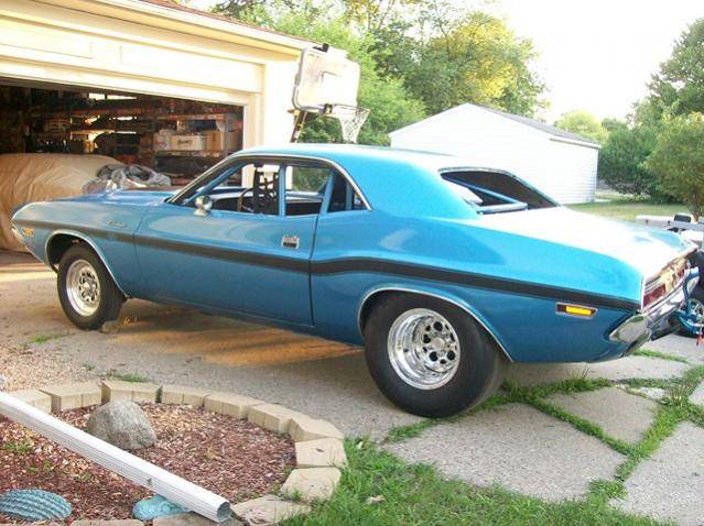

6PKRTSE
Feb 3, 2010
801
391
Once mini tubes are done. I was able to fit a 315/60/15 Drag Radial (30"X13.5") or a 29.5x10.5W (29.6"x13.6") in there with plenty of room to spare all around.

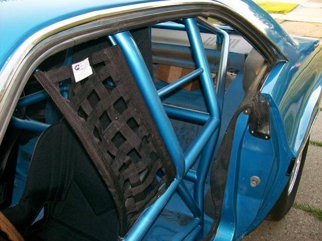

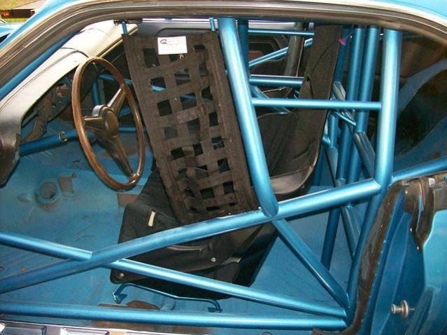

Yes, it is B5 blue. Foctory 1970 color. Still have the label off of the paint can. That is how I matched my cage paint to the body paint.

6PKRTSE
Feb 3, 2010
801
391
I would love to see more of the car. I'm doing a 71 in the same way. Cage,mini tubbed.. Some street but mostly race.

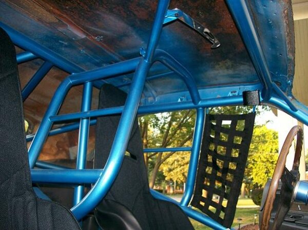

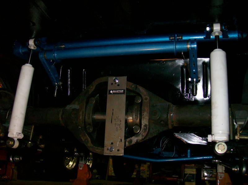

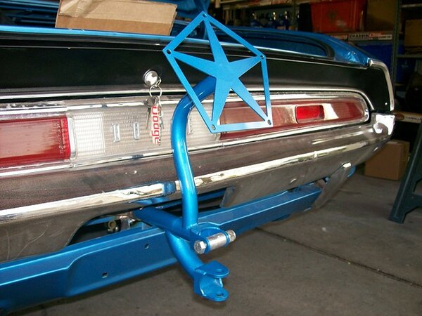

Here are a few more I have of my Challenger. It is a 25.5 (7:50) cert chromoly cage, mini tubbed, still on leaf springs, cal-tracs with split mono leaf's, moved in board with a anti roll bar. Challenger Progress 018 [640x480].jpg
100_1456 [640x480].jpg100_1666 [640x480].jpg100_1667 [640x480].jpg100_1671 [640x480].jpg

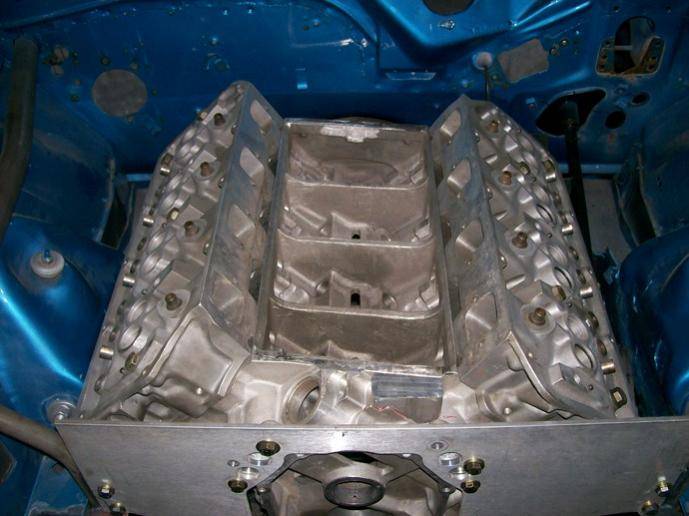

6PKRTSE
Feb 3, 2010
801
391

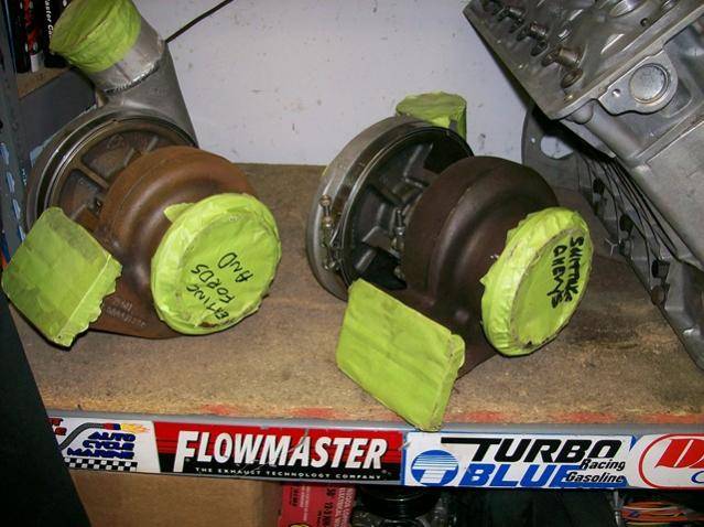

Some of the Keith Black Hemi all mocked up for the front & mid plates. Entire car has all been home built by myself & alot of great help from my buddies.

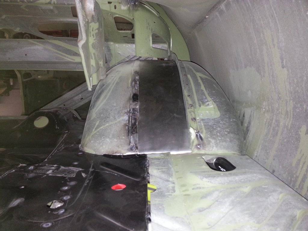

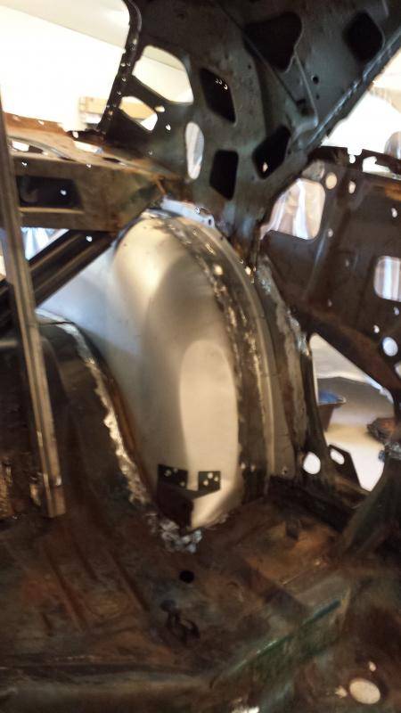

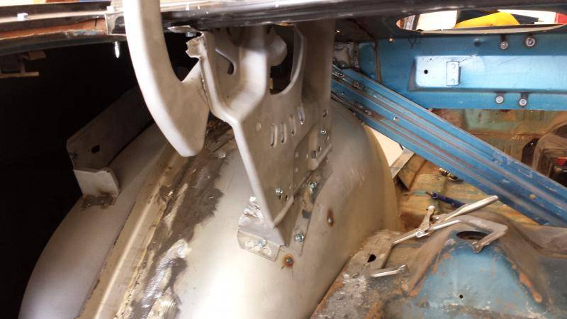

mopargnome
Aug 25, 2015
20

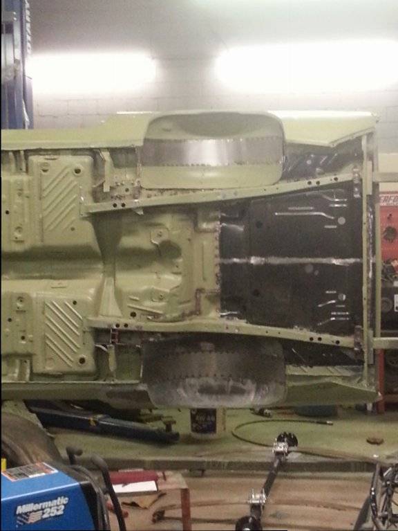

Here are a couple pics of the tub job I did on the current Challenger project.
