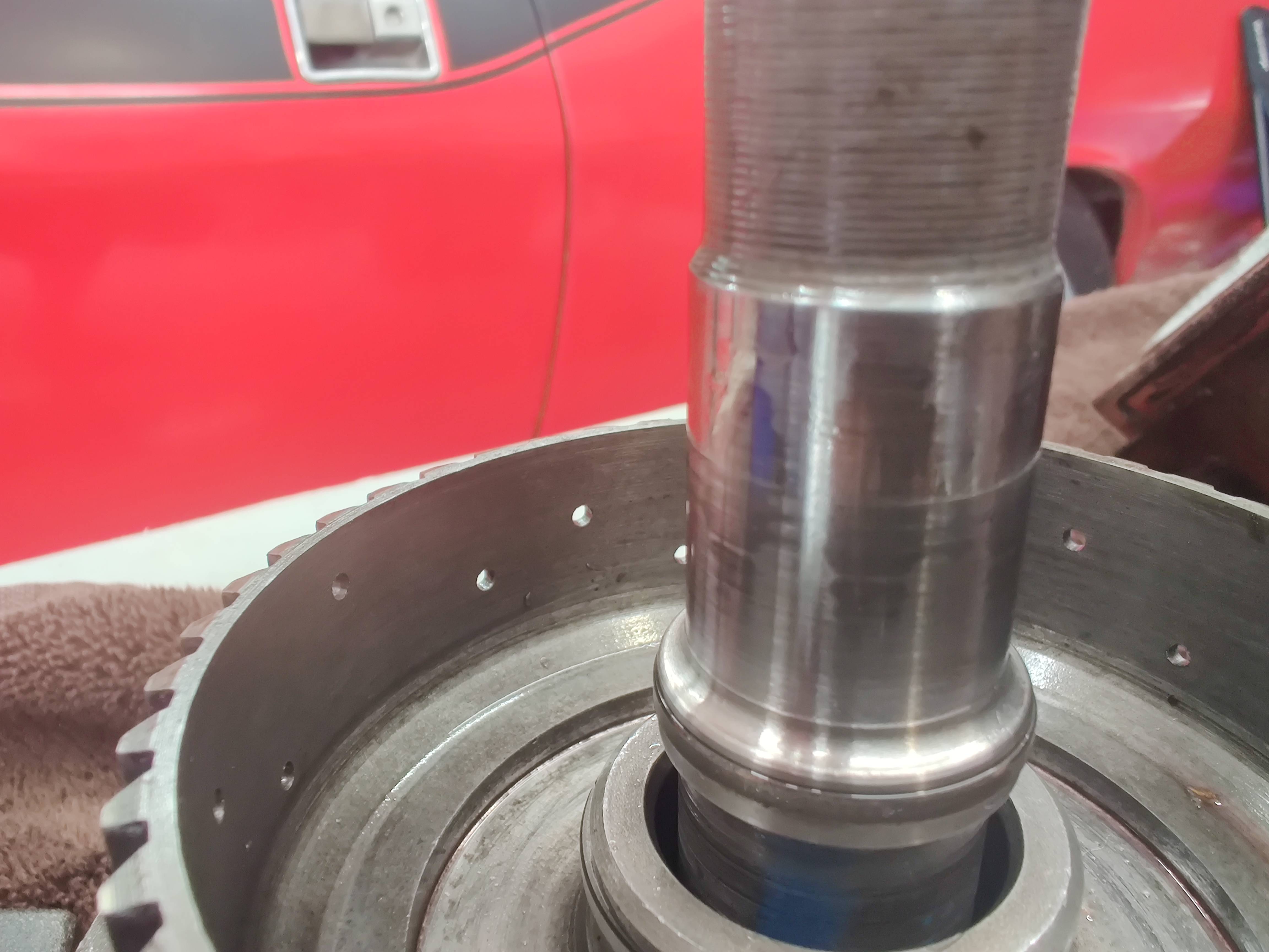

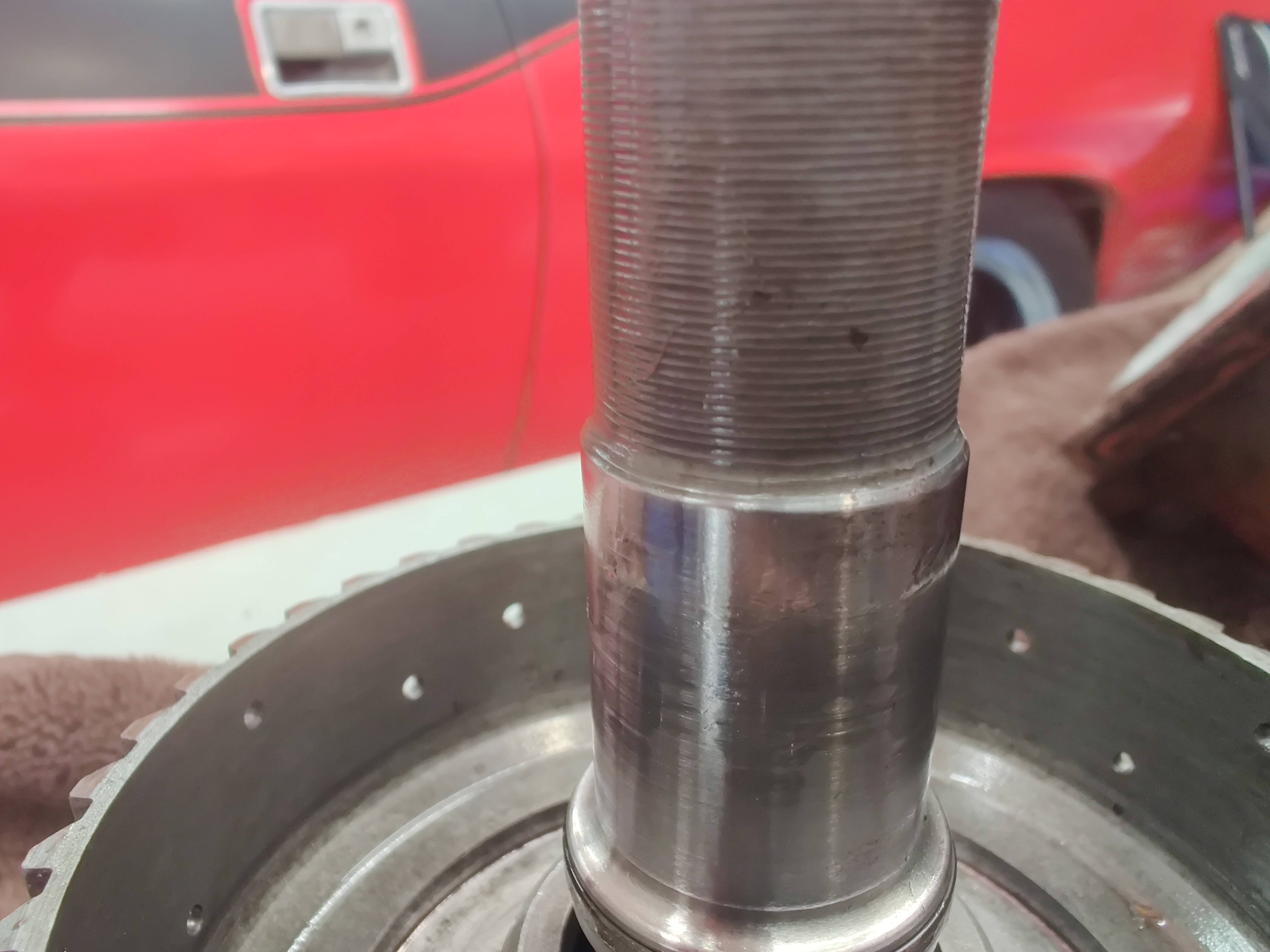

Some other questions if anyone is looking here... Input shaft has some weird patterning on it. Shaft isn't worn or anything, almost looks like the metal is stained or more polished in some kind of pattern. Any concern?

Not 100% sure but if I am right that section rides on a bushing inside the pump - guessing that bushing is toast and if so then yea this shaft is not reusable. If I have the part in mind correctly
Yeah that's the part that rides inside the pump... Replacing the bushings but wasn't sure if this would matter on the shaft. Not what I was hoping to hear haha.

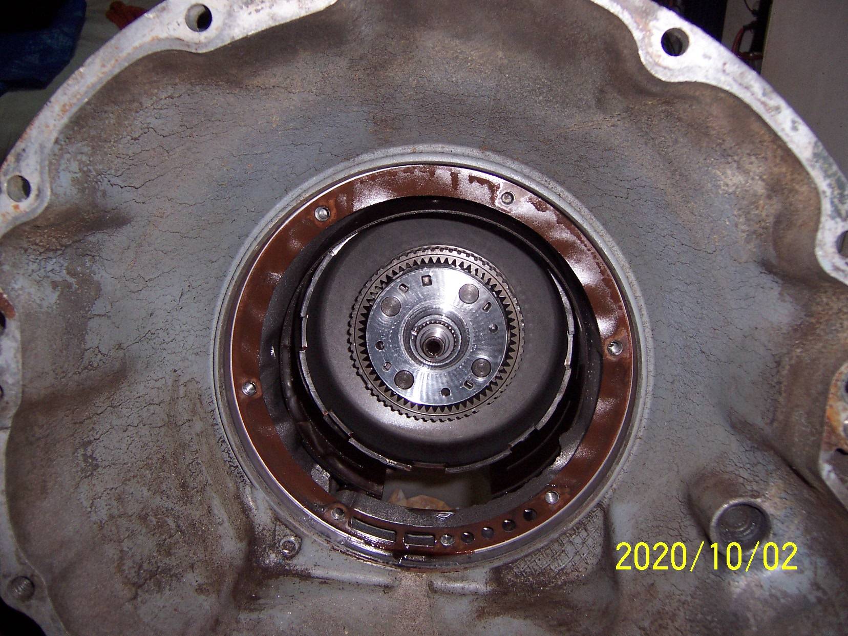

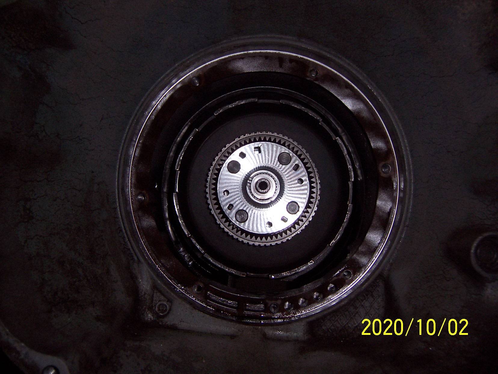

Play in the planet is a little tougher to answer without feel. I would say some is normal. Suggest you look closely for wear - on the planet, sun and annulus gear. If it helps here is what the front planet on my 727 looked like coming apart. When you say "sun shell" are you referring to the sun gear (middle) or the annulus gear ring (outside "shell")
The only failure I have personally seen on a planet set involved a complete failure of the annulus - it split and separated from its support in a 42LE but even then I did not recall wear on the gears (other than chips broken from the failure).
