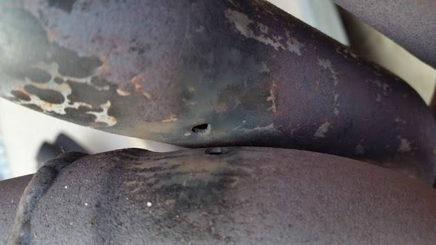

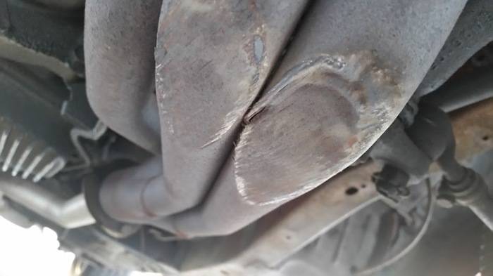

As luck would have it the first day of driving my new 72 Challenger resulted in the long tube headers getting bashed when I was exiting a steep driveway. :angry1:
Pulled out the headers and discovered these holes near the top! :icon_scratch:

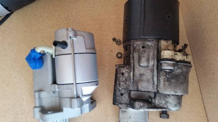

The headers require a mini starter. Purchased this one from Amazon. As you can see this mini starter is much smaller than the stock unit.

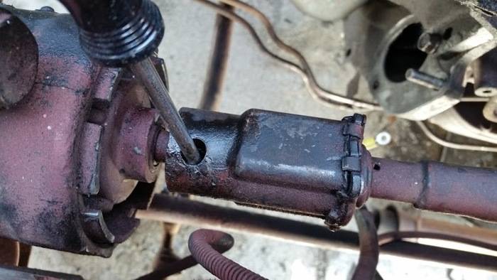

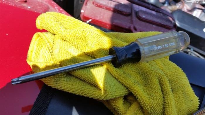

Discovered that a Torx T30 driver is the perfect size for punching out the steering coupler roll pin.

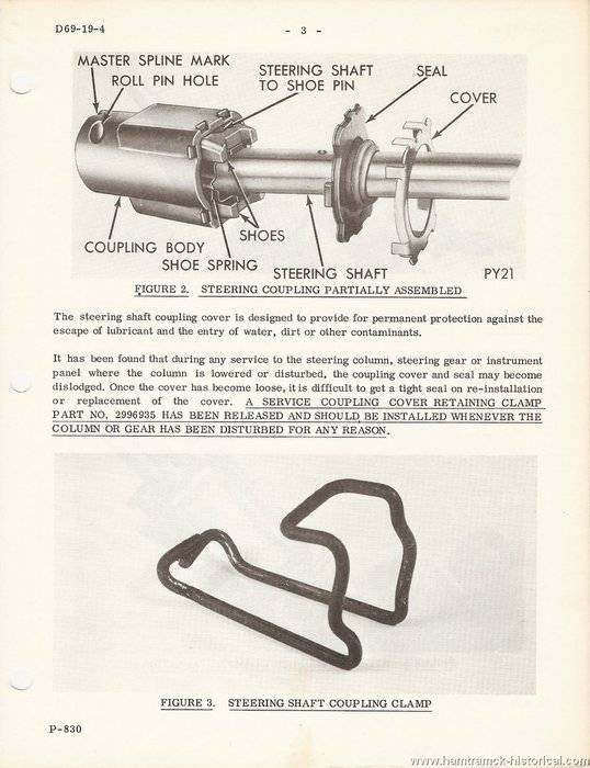

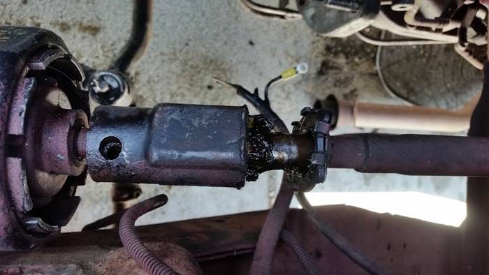

Steering coupler seal cover came loose when I pulled out the steering column.
Did some research on this and discovered this crimped connector comes out easy. It was a such a problem that
a retaining clamp was developed and released per Technical Service Bulletin No. D69-19-4. Purchased the, "Mopar 2996935 Steering Coupler Retaining Clamp" on ebay for $20.

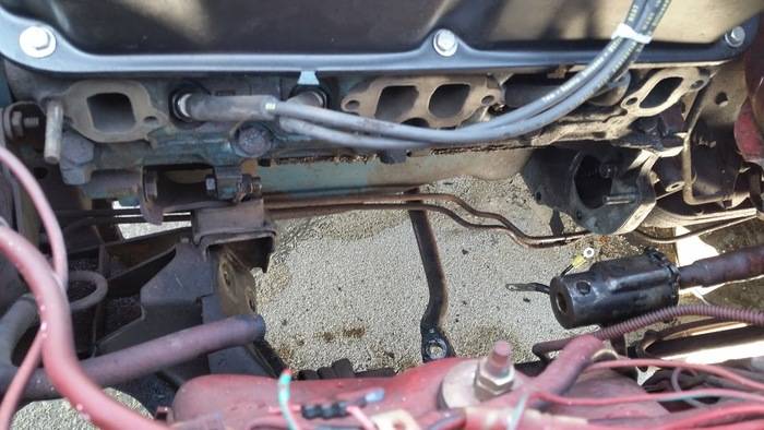

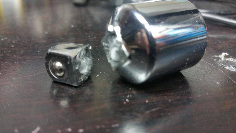

Apparently my motor mount nuts were welded in place. :BangHead:
:thatswck:
Got the bolts out after this discovery.

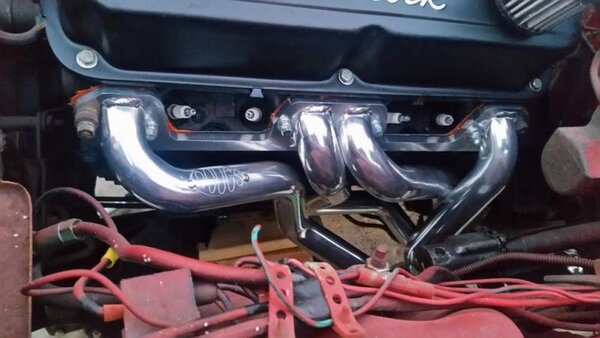

I'm learning a lot and having fun! Got the headers in.

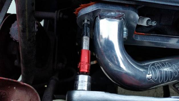

The far left original header nut is not tightening up as the bolt keeps turning in place. Removed it from the head. The bolt threads are fine which means the threads inside the head must be stripped out. Looks like the most common repair is to use is a heli coil. Required drill size for tapping is 21/64. Hoping I can do this without needing to pull the headers out.

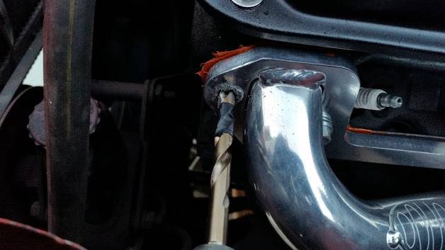

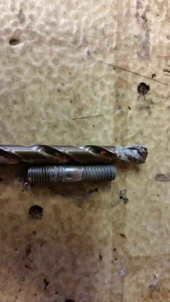

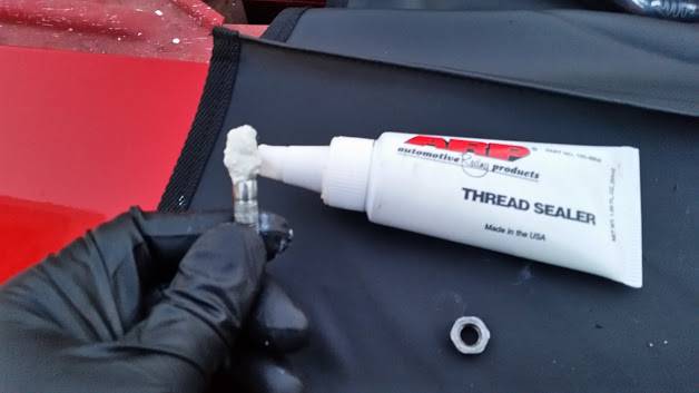

The Heli coil and 21/64 dril bit arrived today. Drill bit went right through the header bolt hole and stopped at the heads. Gave it a few turns and pulled it out. Thread sealer on the end of the bit made a nice mark which along with the header stud helped me gauge the drill depth.
Drilled into the head up to the tape marker.
Carefully tapped the hole. Used a little lubricant oil aid in the tapping.
Screwed the heli coil in (forgot to take a photo), then added more thread sealer to the header stud screw back in and it fits nice and tight. :icon_thumright:
