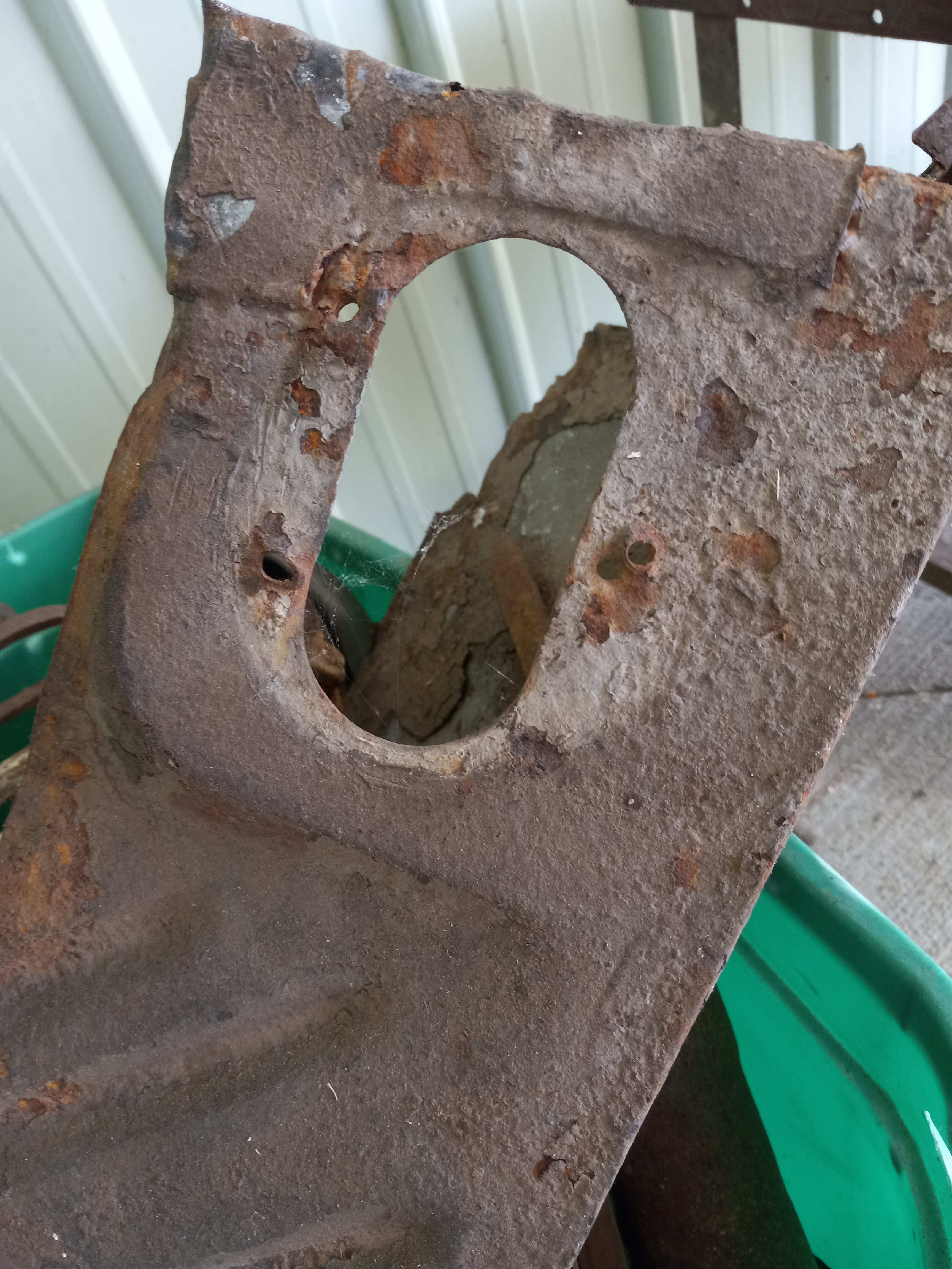

I have an old piece off my barracuda with the original hole
2 inches wide by 4 inch oval

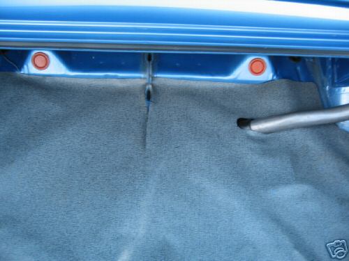

Challenger and barracuda are different. The picture from cuda john looks like the vent stand pipe opening.
Someone needs give you the challenger filler tube dimensions, and i cannot. I'm mr cuda, not mr challenger.

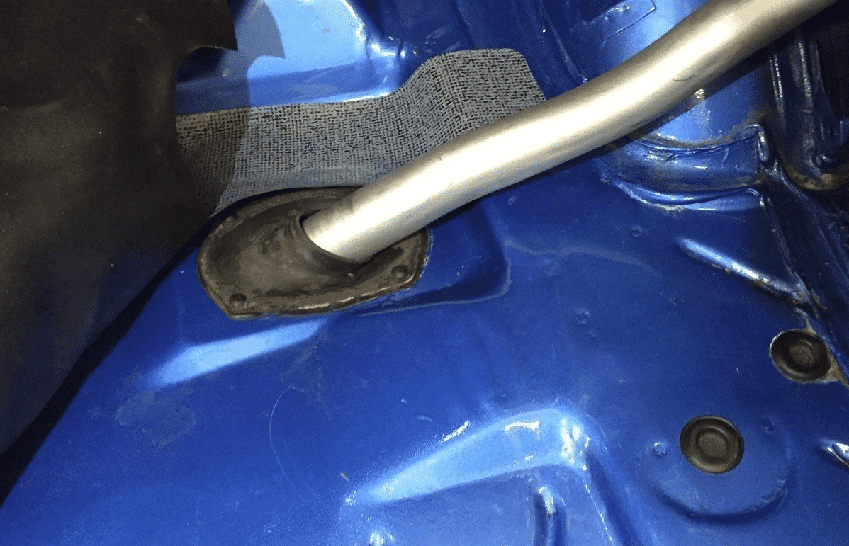

This is what you want? Correct. do you have the trunk mat? Get the idea.
Flip gasket over make a templet to use for cut out. Use the mat to locate filler tube gasket mark the hole through the gasket.

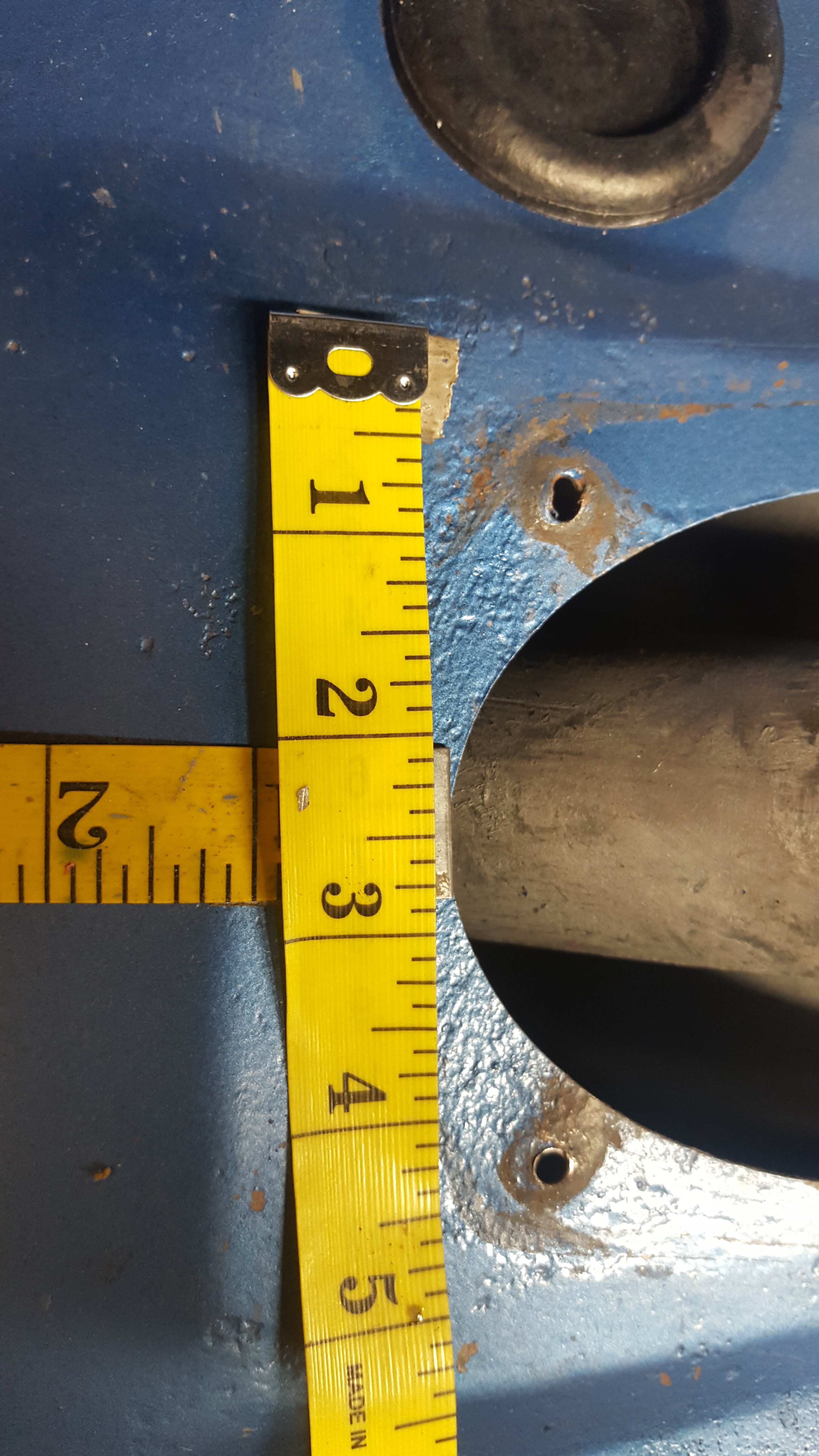

Tapes read 1 1/8"x5 1/2" when held in place.
