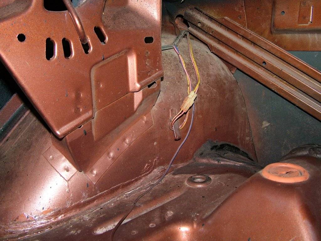

On my 71 Challenger non ac, rallye dash it looks a little different. The connector is in the trunk with only a pink and yellow wire. The blue wire you see goes to the fuel gauge sending unit
at the tank.

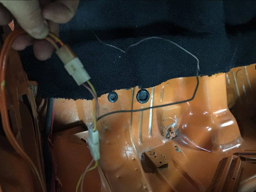

The second picture posted is a typical rear wiring connection for the dome light. The first picture shows the insertion of the wiring with the brown wire to power the trunk light.
