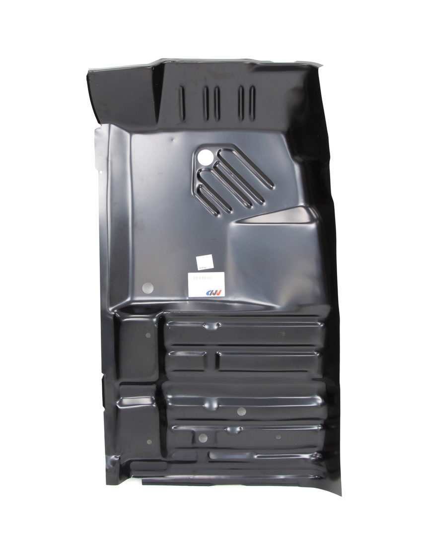

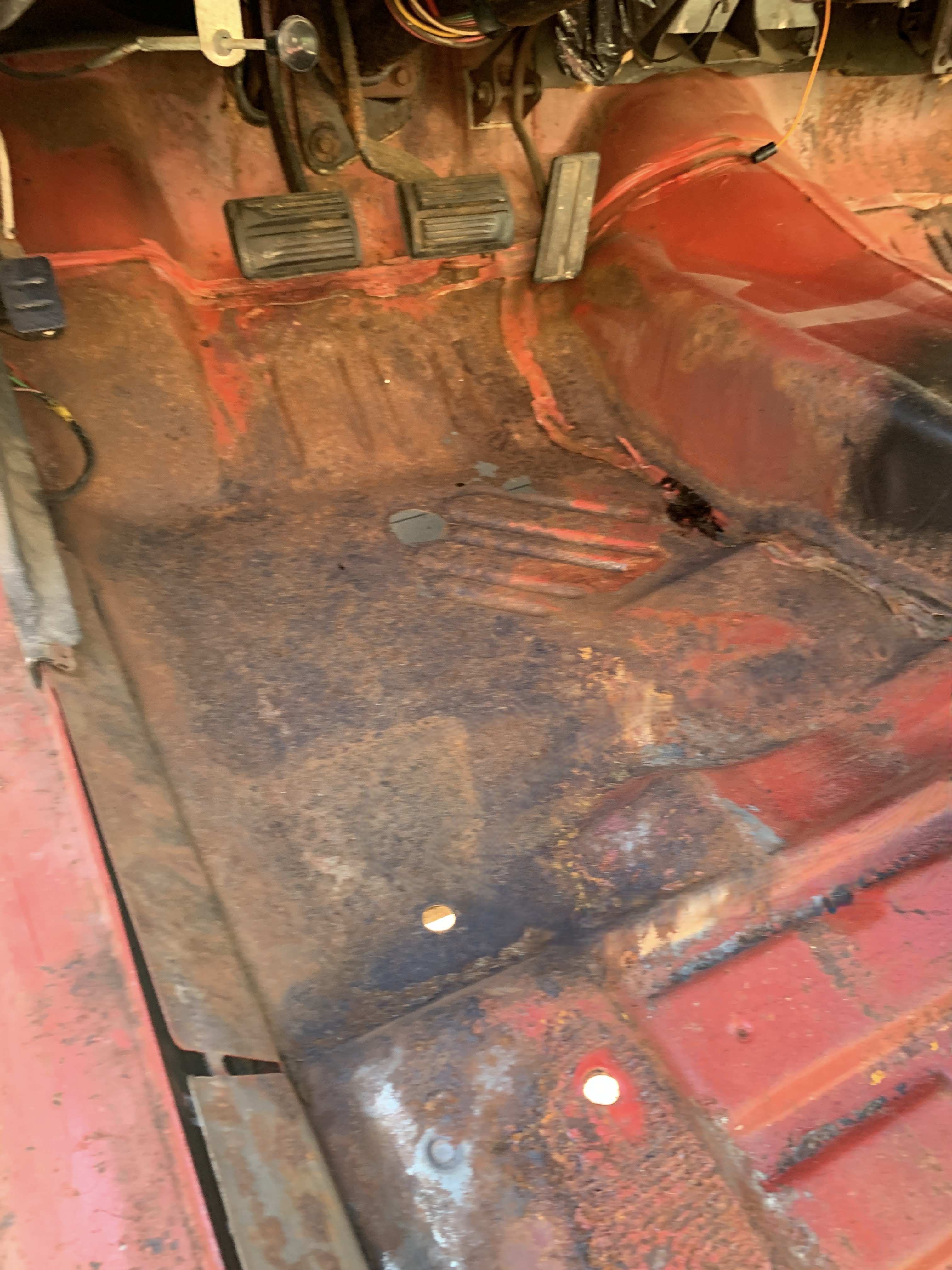

No my barracuda is 74 and driver side front floor from AMD is different from what i have on my car , other brands are correct but I don’t know about quality.AMD is flat towards the seat platform where on my car there is 2 ribs

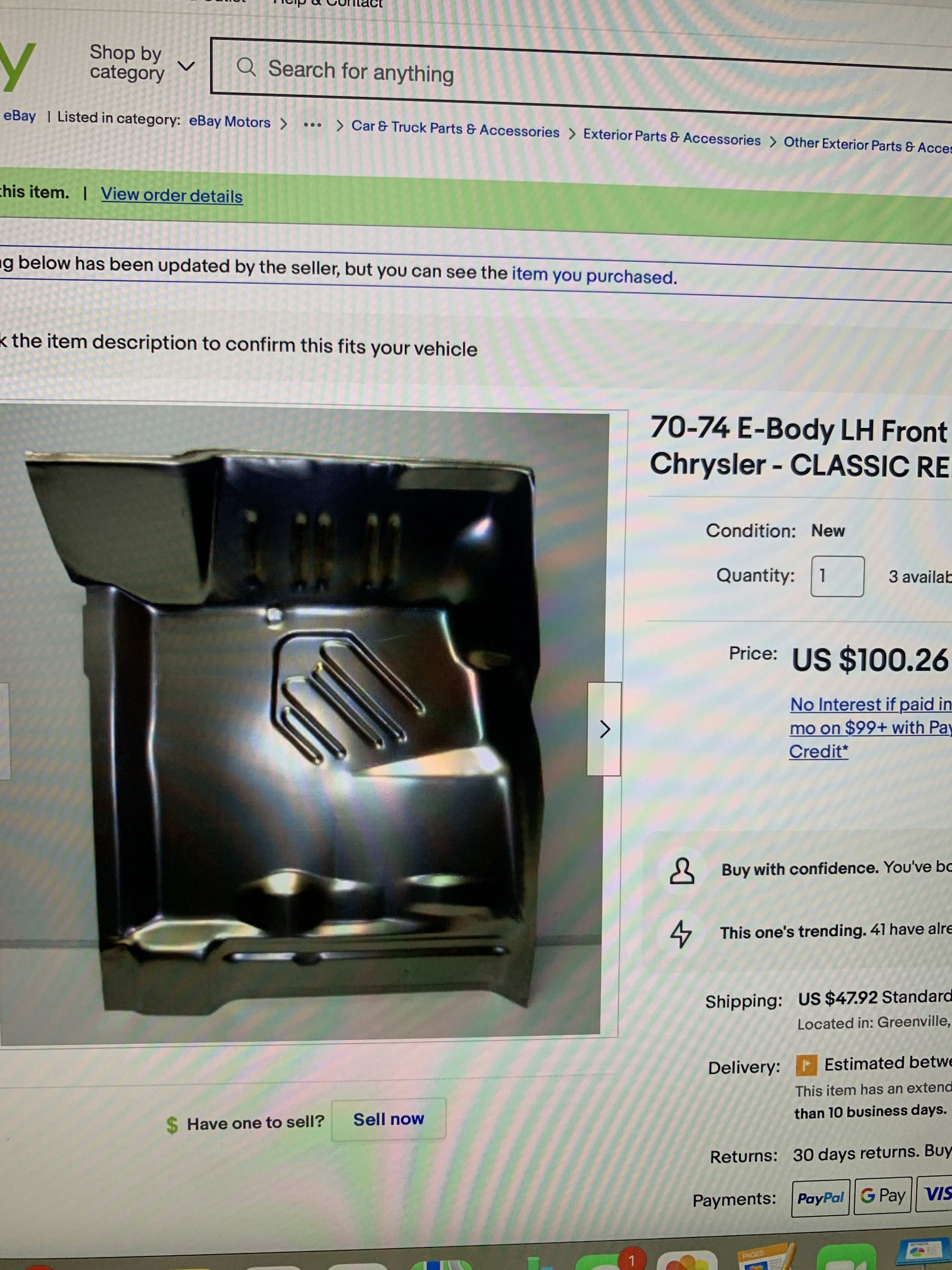

Thanks for posting those pics to clarify the differences. That's pretty interesting. I've haven't seen a floor like yours and the photos of all the pans that I linked look different than yours, but I do see other options on the internet that are marketed as 70-74 E-body floor pans that have the additional ribs that your floor has.
Floor Pan Front 1970-74 Cuda Challenger Left Side E-Body Mopar USA Panel | eBay

I can definitely see the difference. And the other three floor floor pans don't match your floor pan either. I would splice in the matching part of the ADM floor with my existing floor to keep it original as possible. Do you already have the ADM floor pan? I imagine it's harder to get parts in Poland as compared to the United States.

Did call AMD and ask about it but they didn’t have any answers.I purchased a floor pan from eBay made by Classic reproduction from Ohio. Looks correct like on my car, and yes it is difficult to get parts here in Poland so I buy them in US and have them shipped here by my friend in Chicago. Much cheaper that way
