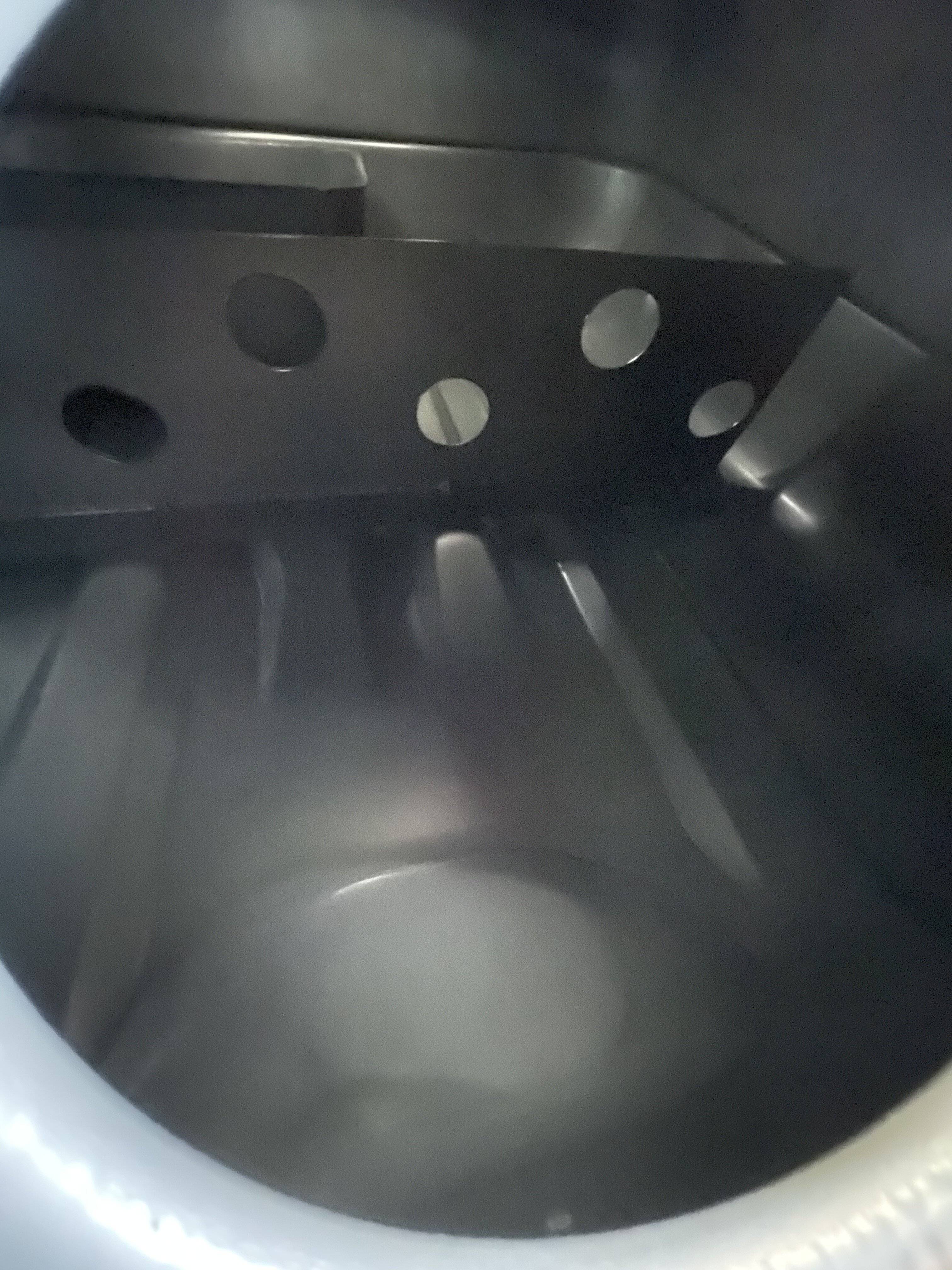

Agree with @rogue, the Tanks, Inc. tank with in-tank fuel pump has all of the provisions you need and more. The anti-slosh baffle and a fuel pump sump are major upgrades.

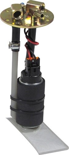

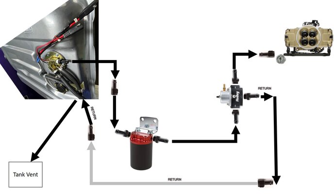

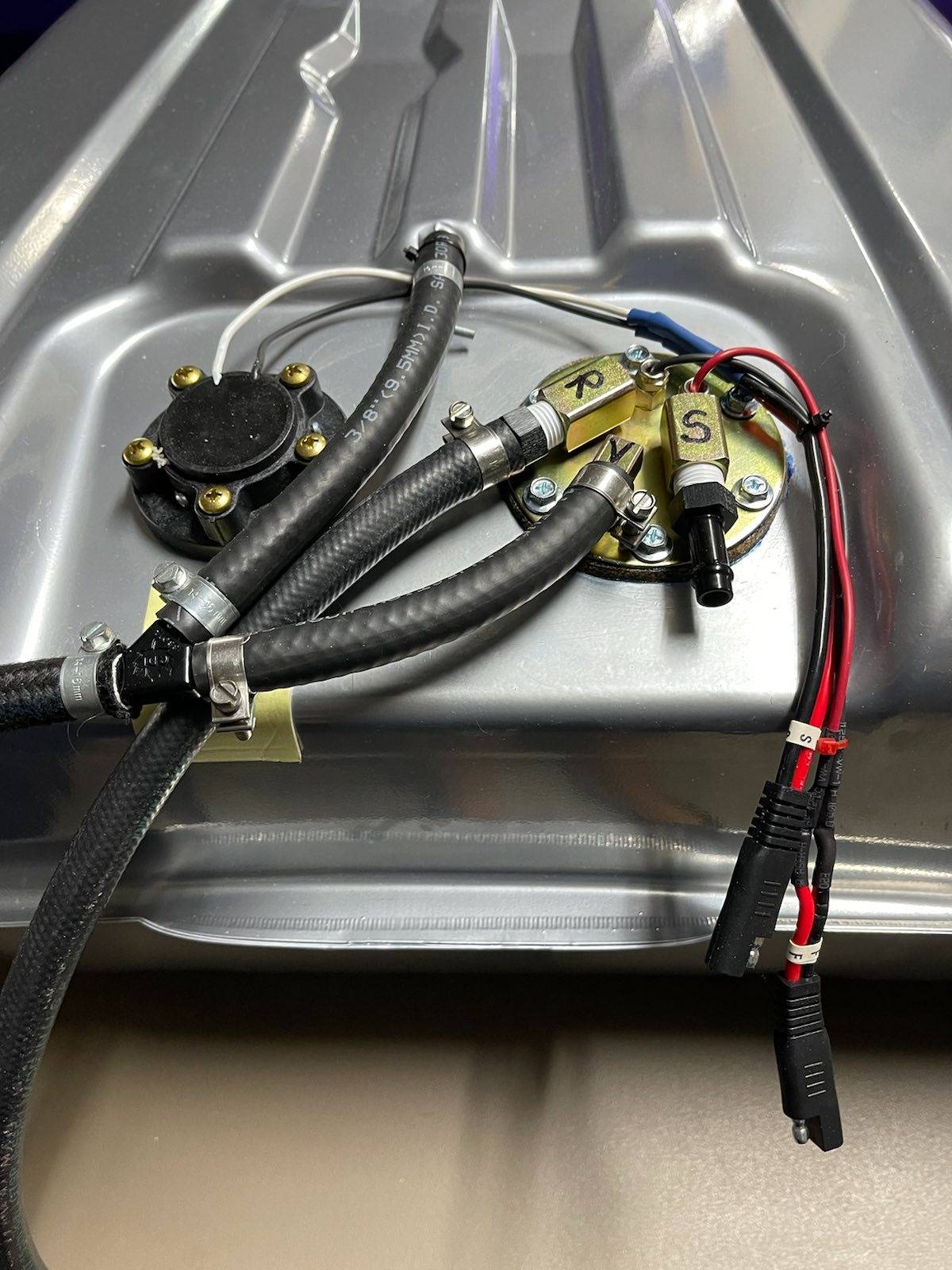

FYI - A return line cannot just dump into the top of the tank as that will seriously aerate the fuel and cause problems. The Walbro 255lph pump from Tanks, Inc. has a return tube (white tube connected to "R" in the pump picture) which puts the returned fuel in the bottom of the tank so no aeration.

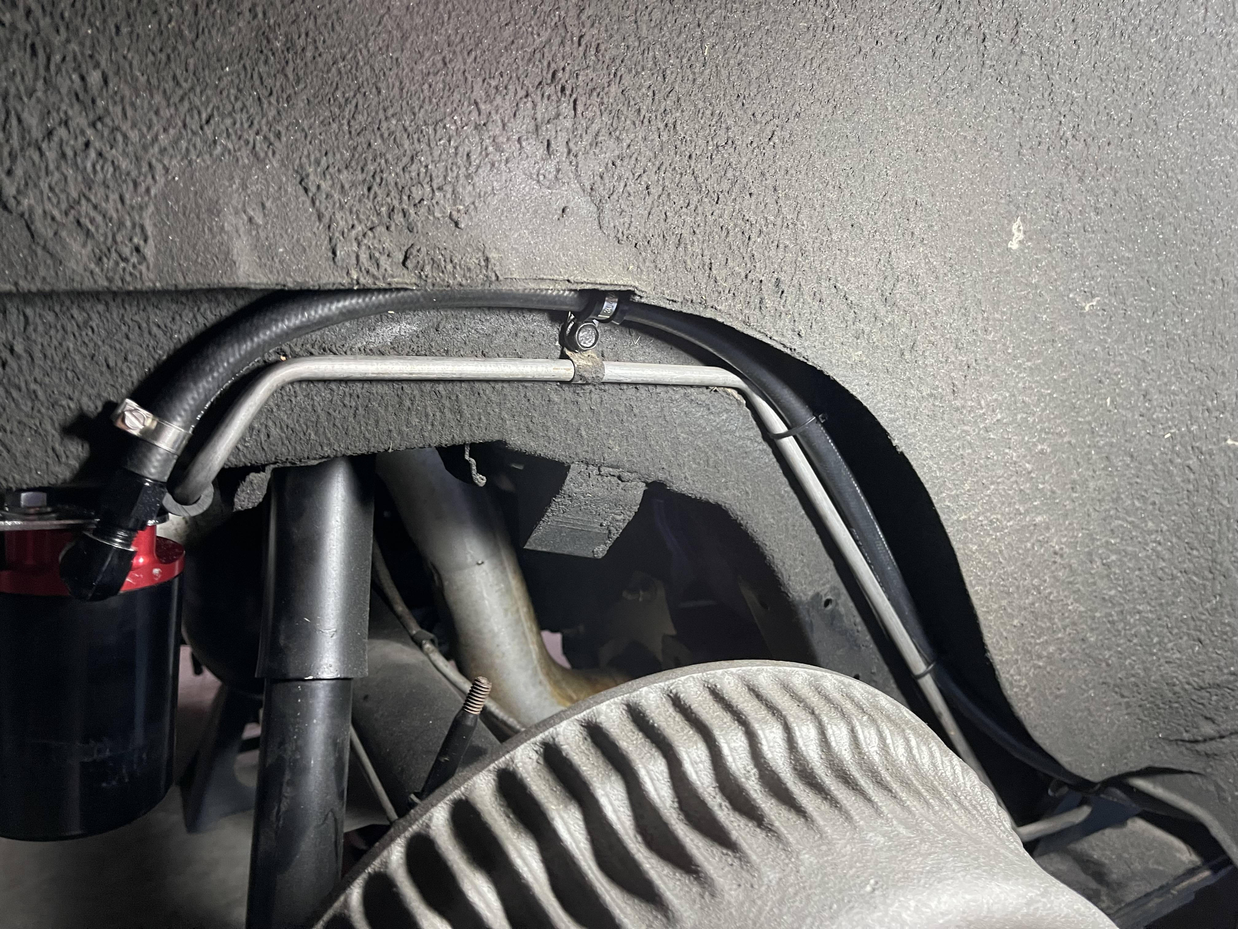

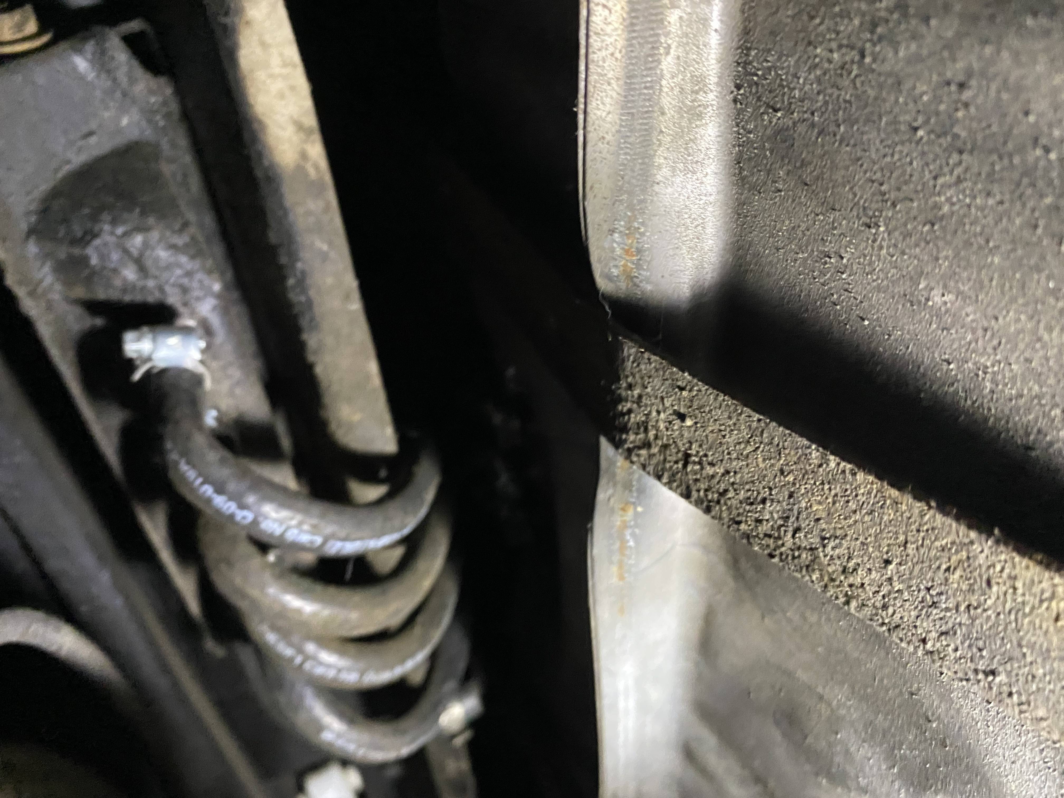

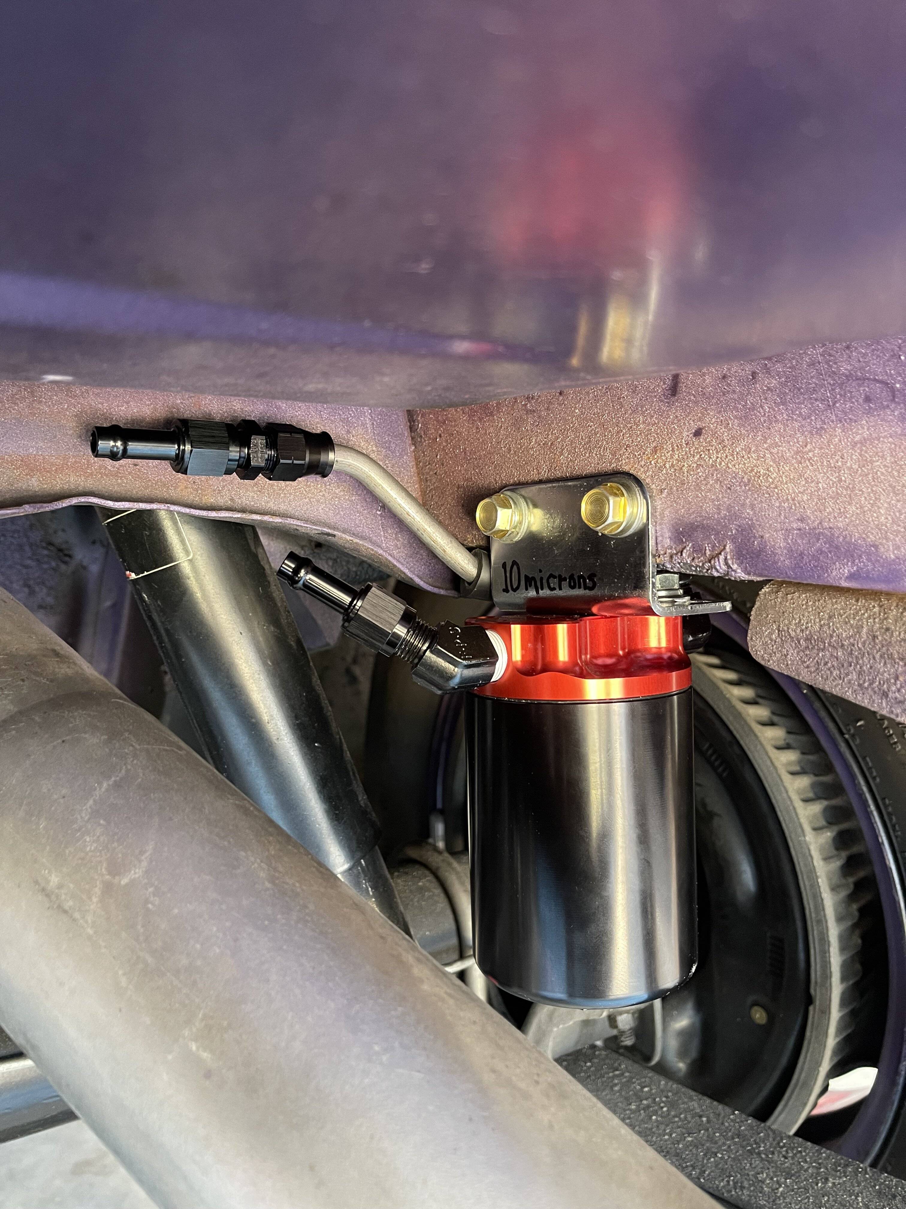

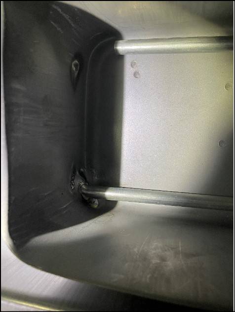

Here are some pictures of my Cuda's EFI fuel system. The Walbro fuel pump has a 100-micron pickup "sock". I ran an external Aeromotive billet filter housing with a 10-micron filter and used the 3/8" factory hardline as my return line. The new supply line is 3/8" Earl's VaporGuard fuel injection hose which feed the Holley Pro-Billet regulator at 60PSI and then to the Terminator X Stealth throttle body.
