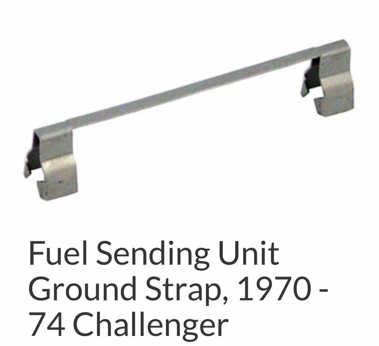

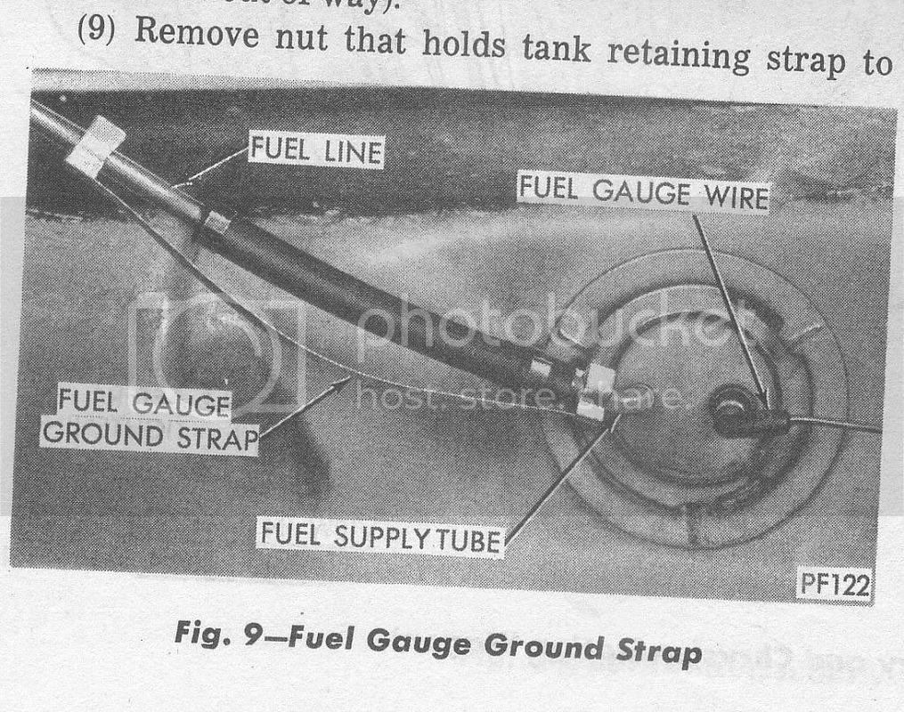

My 70 Challenger’s sending unit had a pinhole in the float, so it would show empty. I’m not saying that’s your problem but it could be when they installed it back in the new tank. Keep your old sending unit, it can be rebuilt. Could be a ground problem. Have you checked your fuel gauge wire? Wiggle it around on the plug. Does yours have a ground strap on it?

I second Mopar Nut's ground suggestion. It's critical, and likely they didn't put the strap back on, or if it was missing to add whatever was being used, even a wire from the sender to a body ground would confirm if that's the issue.

The good news is your buddy's meter showed resistance so the sending unit is working BUT, I'd like to know the number. Somewhere between 10 and 70 ohms. If it reads the 70, the float is at the bottom of it's travel so obviously your gauge would read empty. The resistors aren't linear but you should read something other than 70 (+ or -) with that much gas in your tank. If the meter reads closer on the low end then my vote is for a bad ground too or the blue wire got cut/damaged during installation.
