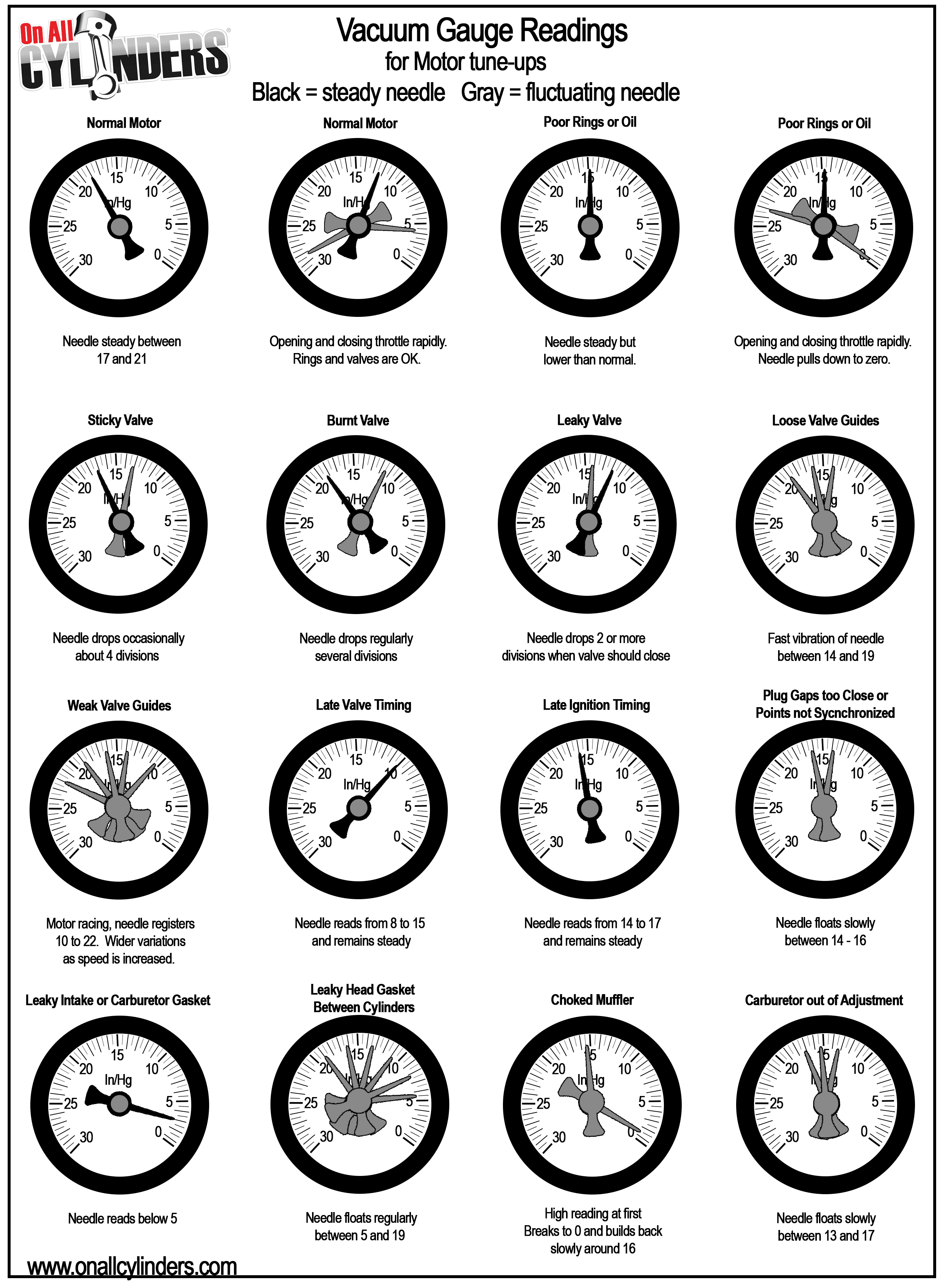

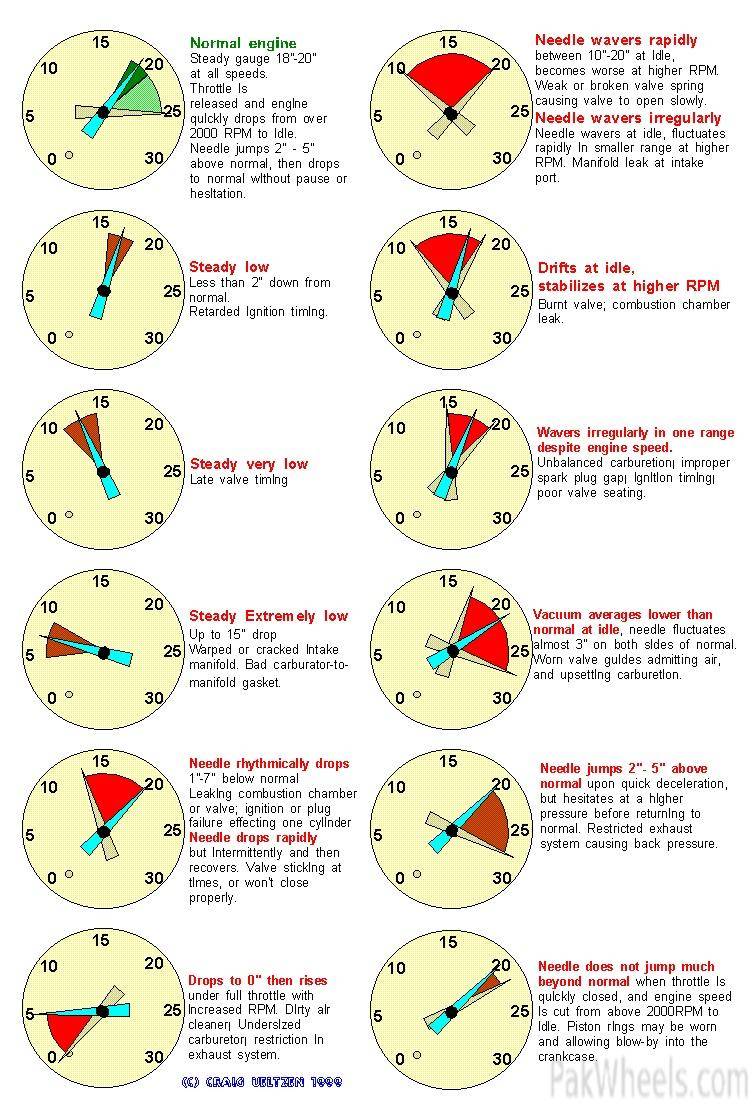

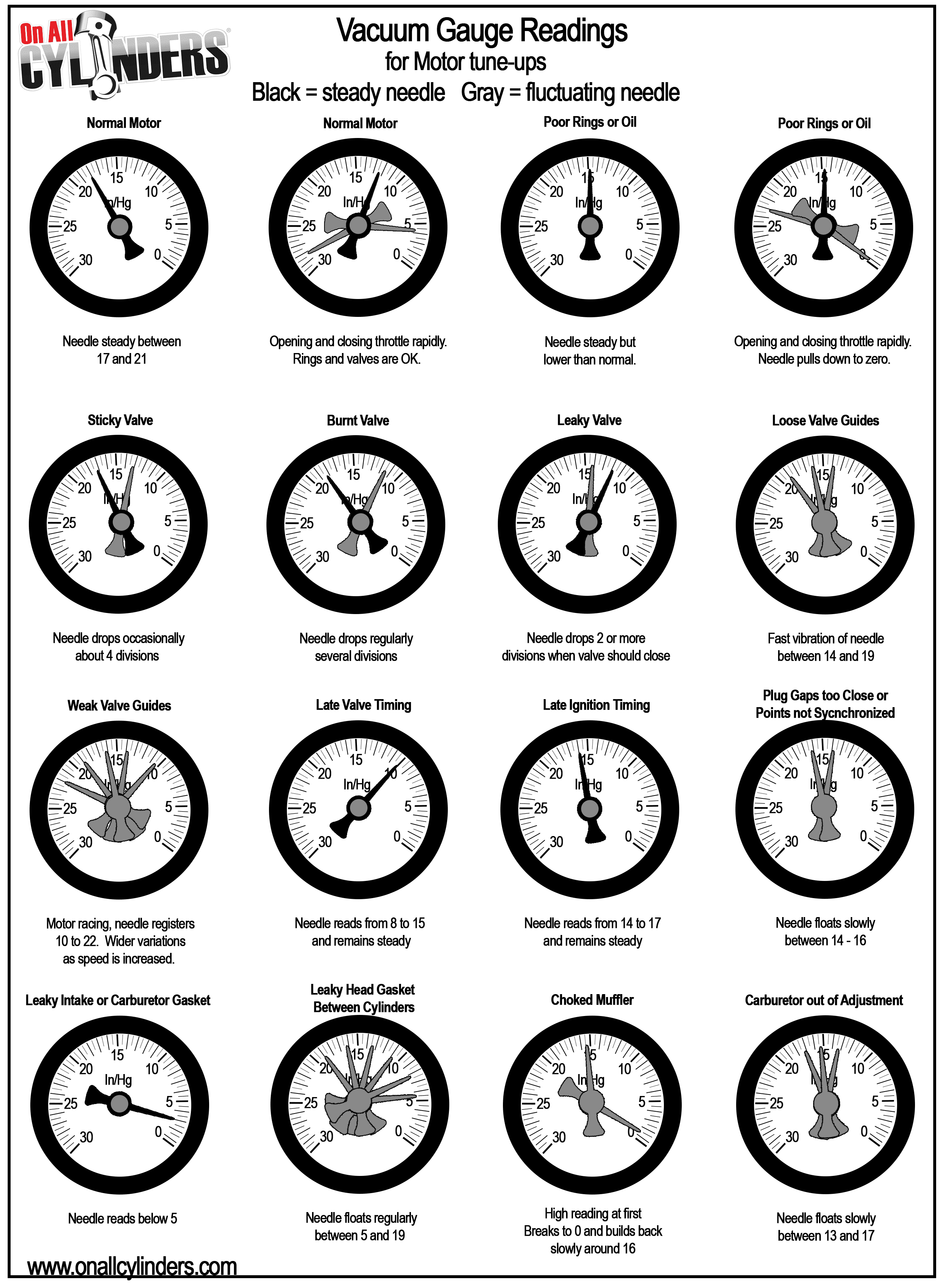

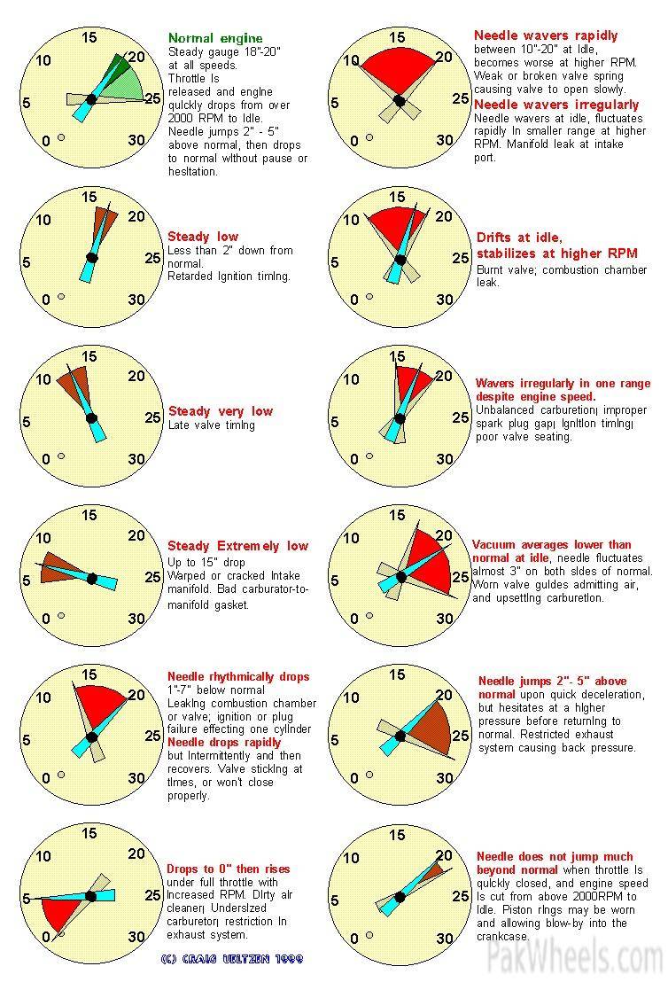

Look at the charts see what fits you findings. I know you don't wan;t to hear it Worst case cam maybe not set right.Hope for something simple! Pvc valve ok?
