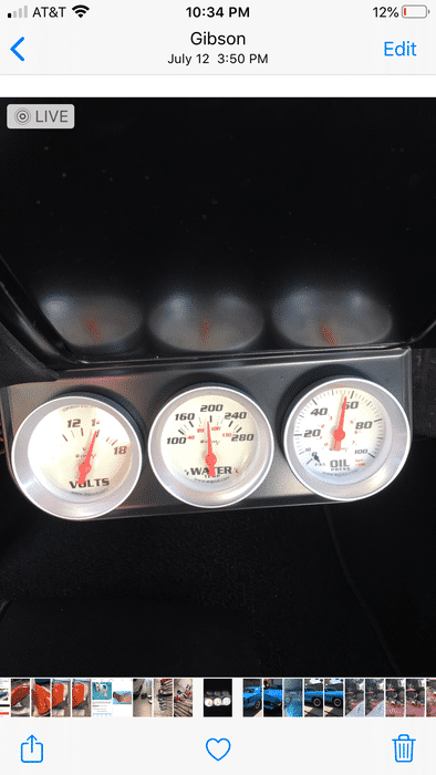

Here’s where my 440 (500 stroker) is just before operating temp. The pump is a MP high volume BB/Hemi. Now, I did purchase a M/E Wagner pvc adjustable valve. I haven’t installed it yet but, it got my interest when researching it. I don’t have anything leaking. I do more cruising than WOT.
Check it out online if you want to. They say it can help leaks ??
