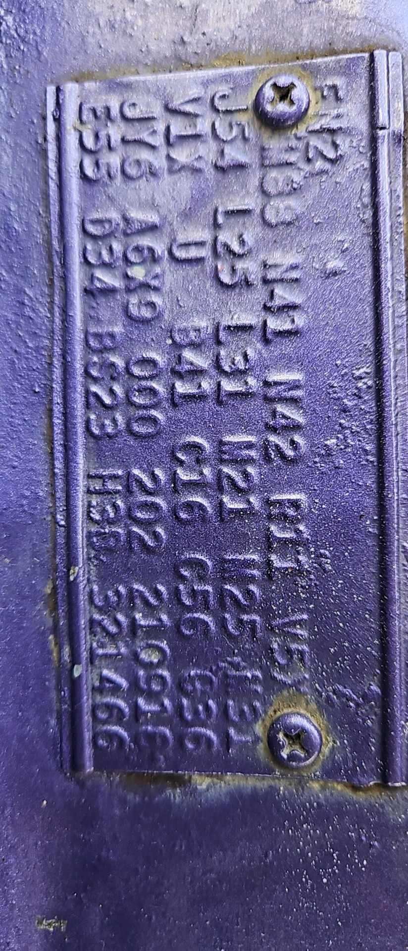

Would anyone mind decoding fender tag?
73E

1973 Cuda. 340 car. Lots of other things on there if you want a full decode.
Interesting…. I tried researching and came up with 318 car!

Here you go:
E55 - 340 1-4bbl
D34 - 727 Automatic Transmission
BS23 - 2 door Cuda coupe
H3B - 340/1973 Model/Hamtramck (Dodge Main)
321466 - Sequence Number
JY6 - Gold paint
A6X9 - Black Vinyl Bucket Seat Interior
000 - No Interior Paint
202 - Schedule Build Date February 2, 1973
210918 - Vehical Order Number
V1X - Black Vinyl Roof
U - Build to Specifications USA
B41 - Front Disc Brakes with 10" Rear Drums
C16 - Center Console with wood grain
C55 - Front Bucket Seats
G36 - Left and Right Racing Mirrors Painted Gold
J54 - Sport (Rallye) Hood
L25 - Trunk Lamp
L31 - Fender Turn Signals
M21 - Drip Rail Moldings
M25 - Body Sill Moldings
M31 - Body Belt Moldings
M88 - Deck Molding Treatment
N41 - Dual Exhaust
N42 - Bright (chrome) Exhaust Tips
R11 - 2.5 Watt Music Master AM Radio
V5X - Black Body Side Molding
EN2 - End of Options (2nd Assembly Line)

Excellent breakdown, thanks for posting! Galen Govier's white book shows "000" as "full door panel".
Cuda Hunter
3,052
1,108
high mountains Colorado
000 signifies the full door panel that requires no interior paint on the door or jambs due to being a full door panel compared to half panels like C bodies have.
Both ways of describing this 000 are correct.

Thanks for your response. Wouldn't the jambs still have to be painted, regardless if full door panels are coded? Thanks.

Yes, but no ebody received a paint code for that little bit of paint that was on the doors. The C bodies could have had different paint codes due to there being so much jamb that was visible and having different interior colors would often times que a different color to be sprayed on the jambs to "blend" the interior and exterior colors.
Ebodies just got a little bit of over spray of the body color and that's what they got. No special call out of differences due to interior colors.
I'm no guru so this is only what I have been able to gather from years of reading and looking at actual cars. I'm too young to have been there and I never purchased any of these cars new as I was not alive. Grain of salt, please.

Great job breaking down all the tag codes. The tag shows C56 Reclining Bucket seats (not C55). I have never seen that option code before. I would love to see a picture of the seats in the reclined position, including the lever that is used to recline them. So cool. Has anyone seen reclining buckets? They must be rare.

Sorry, the car was sold before i had a chance at it.

You're right that the tag shows C56. In Galen Govier's white book it shows "bucket seats" for 1972-1974. Maybe in 1975 or later that code was for reclining seats.
