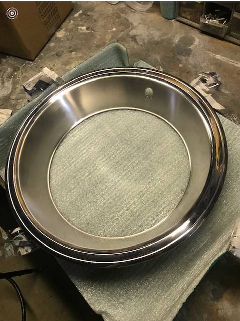

    Here is one of my original rings which was just restored. Remember, there are 15x6.5 trim rings out there which you don't want. If you are close to CT I have a set of 15x7 ralley wheels coming up for sale soon. 071s.

    Where did you get the rings restored? I have a set I would love to have done. Was it pricey?

    Rick Miller. $160 per wheel. Took forever (4+ months) but perfect work.
