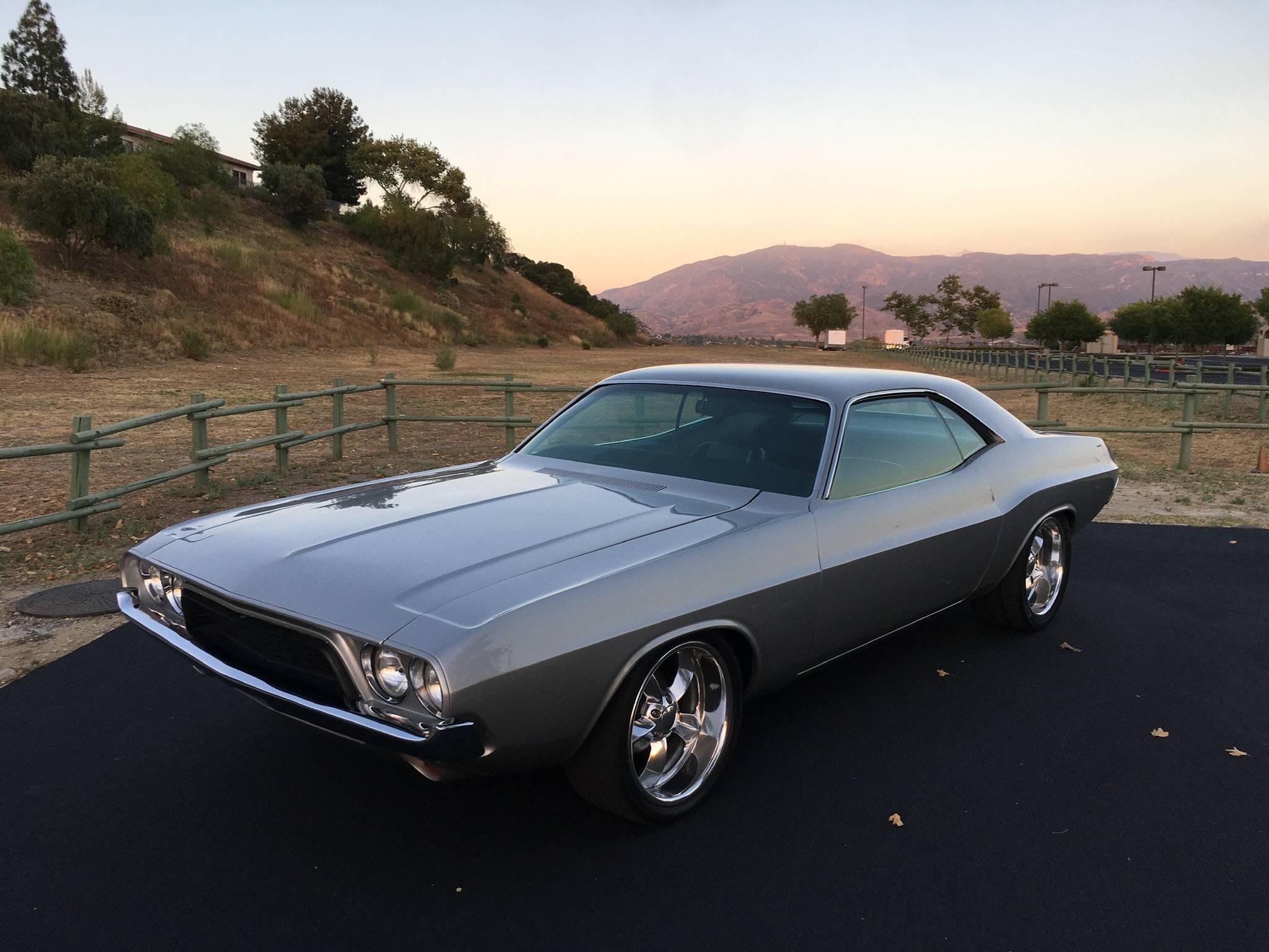

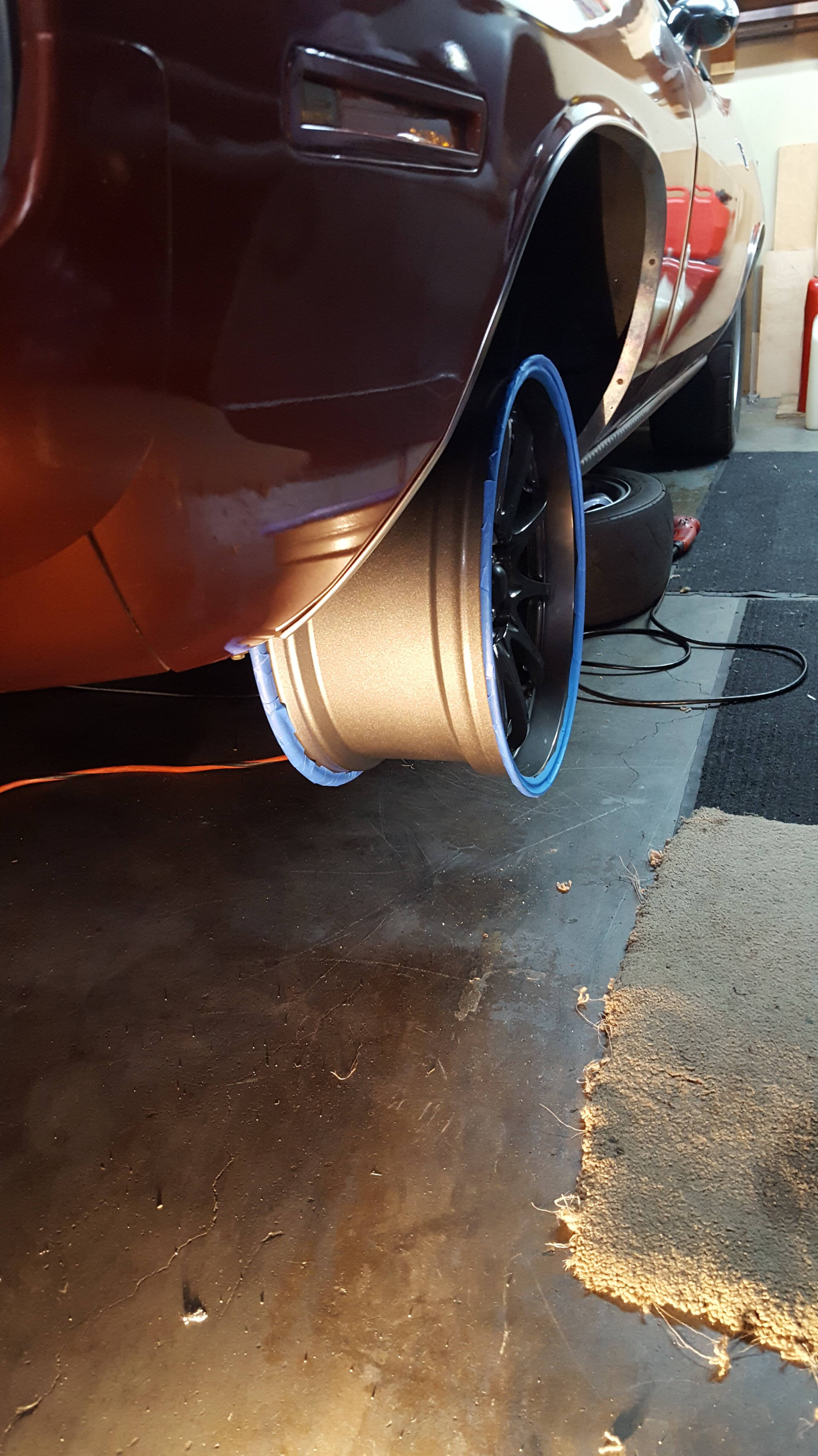

It's better to use the offset spec than the rear space spec, since the offset doesn't change with different widths and the rear space does. The offset just tells you how far inboard or outboard the center of the tire or tire mounting area is relative to the mounting face. Factory 14" Rally wheels are offset .50 inches (+12.7 mm) inboard, and 15" Rally wheels are .25 inches (+6.35 mm) inboard. In the thumbnail picture of my car it has 16 x 8, +15 mm offset wheels, but I now have 17 x 9, +10 mm wheels, with 255-40 tires all the way around. Everything clears, front and back, lock to lock, weight on wheels and weight off wheels. The corner of the front tire clears the front of the fender opening on turns with my 17 inch setup, but it might interfere with 18 inchers and 255's up front. Also, it's good to do a fit check with the bare wheel, before you mount tires. See picture. I found that I needed to chamfer the mounting holes with a 90 degree countersink bit on a drill motor, because the wheel I chose had smaller than usual mounting holes and they were hitting the shoulder on the studs and not seating completely.

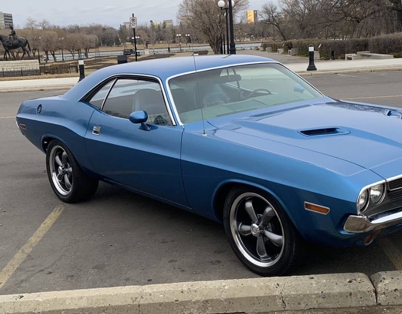

My rims are similar to Ridlers, they are Vision 142's 18x8.5 with 20mm offset. I wrapped them with 245-45-18's front and 275-40-18 rear. I have tons of clearance, could easily fit a 295 or 305 in the back but they would probably be too wide for an 8.5 inch rim.

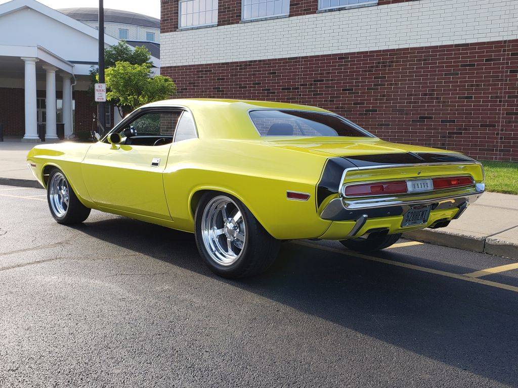

My car has 18 x 10 riddlers on the back and 17 x 8 in the front.
plymouth67
Mar 18, 2011
142
67
Ok..so I checked and my wheels and tires are as follows.
Rears are 18 x 9.5 with +6mm offset with 285-40-18 Nitto NT555 Tires.
Fronts are 17 x 8 with a 0mm offset and 245- 45-17 Nitto NT555 tires also.

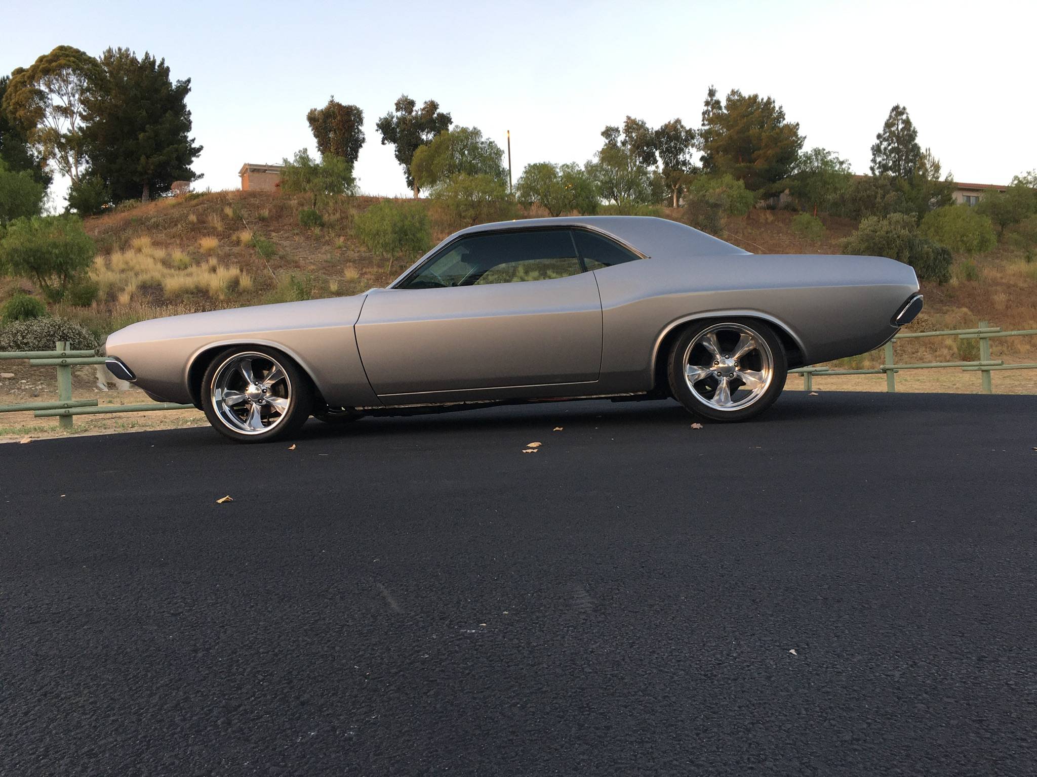

I have 18” all the way around with a 255 up front and it’s probably a to little low for the size but i doubt you will go as low as my car so it should work for you without any issues .. Backspace is the key to fit anything under any car 🙌🏼

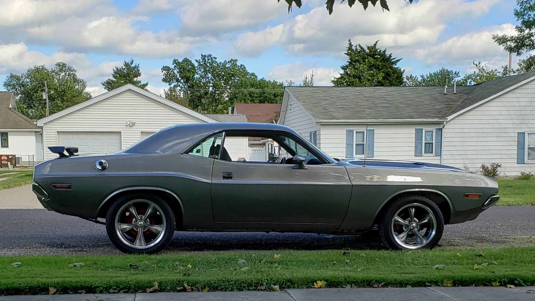

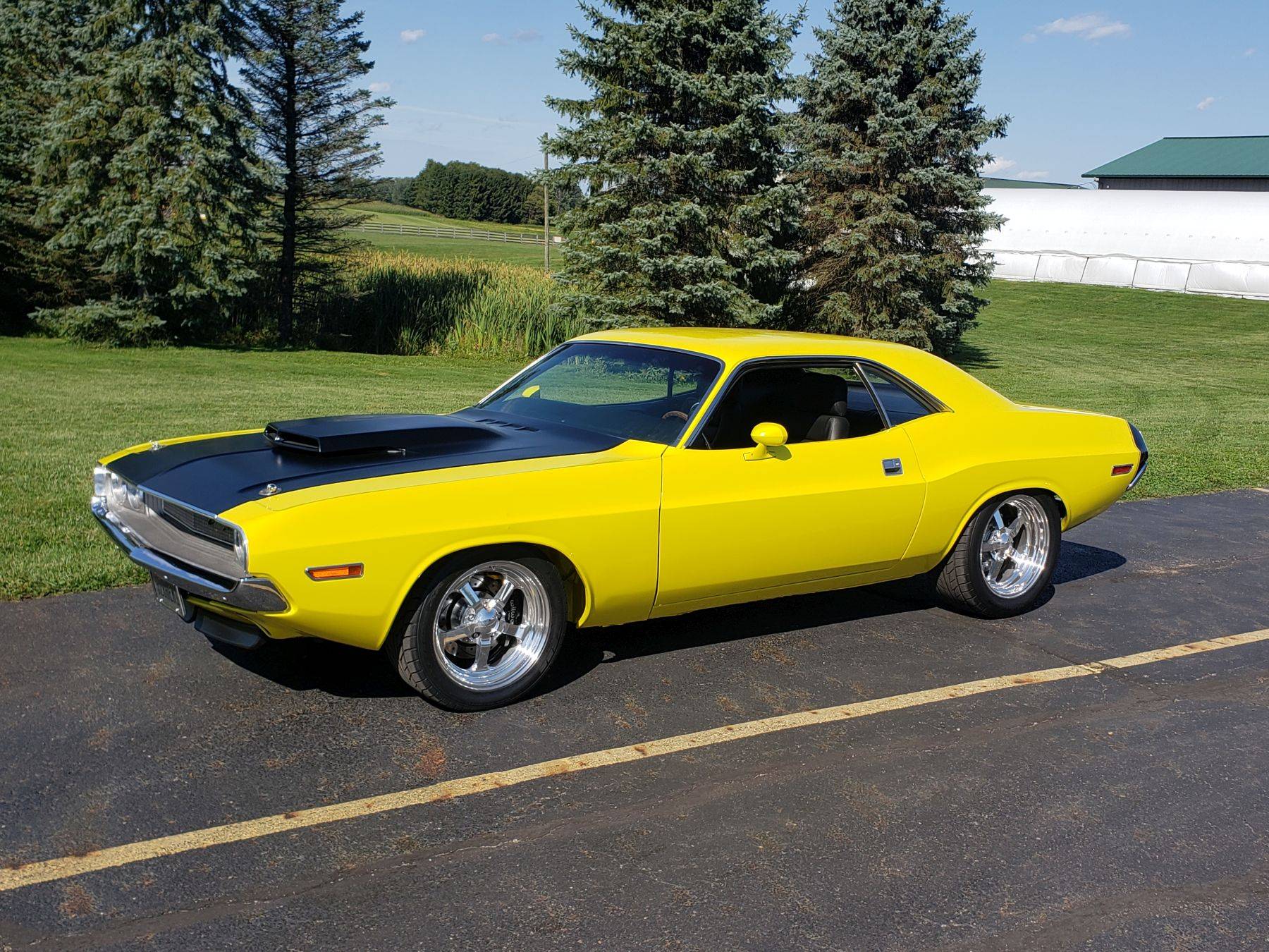

I have 17x8 Budnik billet wheels on the front with 5" backspacing and 245/45/17 Nitto tires but I do have an aftermarket coilover front suspension, not sure if that matters.
Rears are 18x9.5 with 5.5" backspacing and 295/45/18 Nitto's. Leaf springs are in stock location.
