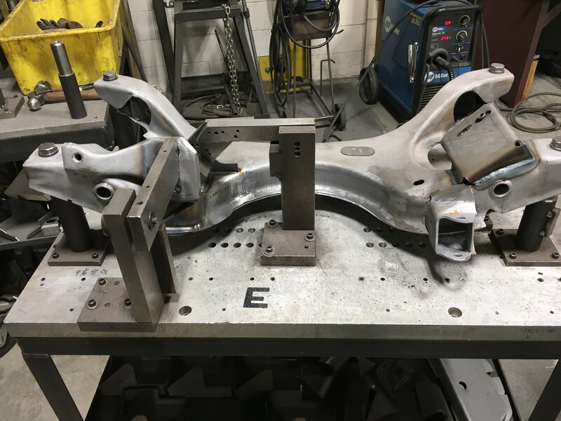

You are going to need conversion motor mounts, a E body hemi K frame or have your K frame converted (assuming you are using a 426 that uses the original mounting configuration, there are some like the Mopar Performance blocks that had the same mounting ears as a 440). There is a guy floating around FBBO that converts your K frame and once converted its like stock.
