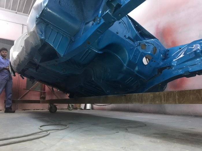

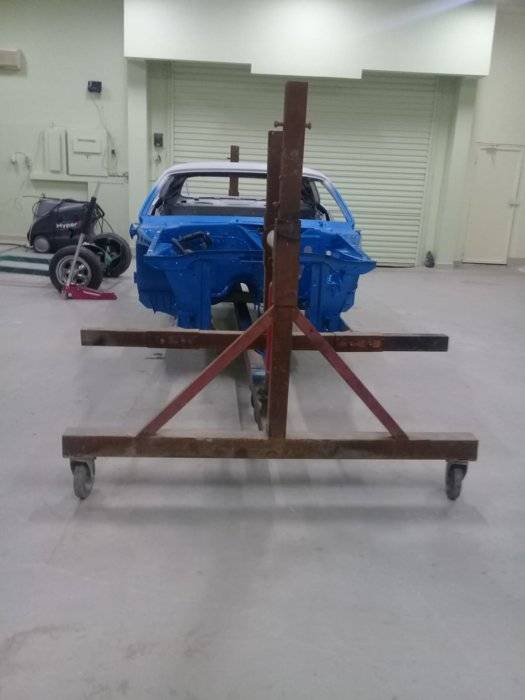

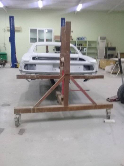

    hi made a rotisserie for the car unbolt the rear and front ends and sent it to my friend for paint

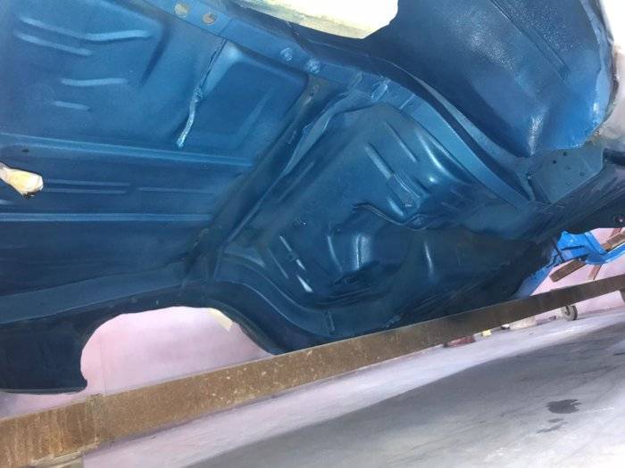

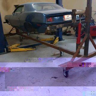

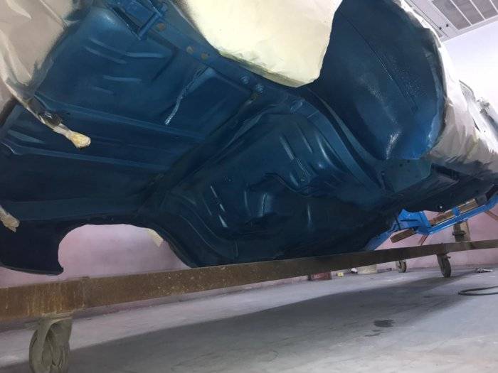

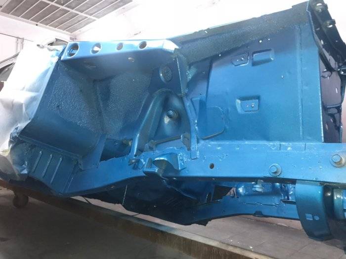

    he painted the bottom of the car and engine bay when I stopped him and told him to send it back cuz im going to install the shwartz performance chassis frame and then I will send the car again to him for full paint

    forgot to say that he did brace the fenders and made mini tub at rear for fat tires

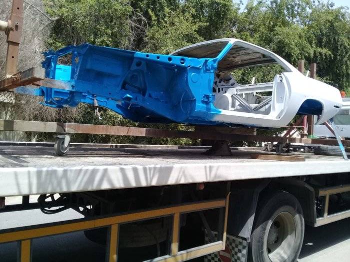

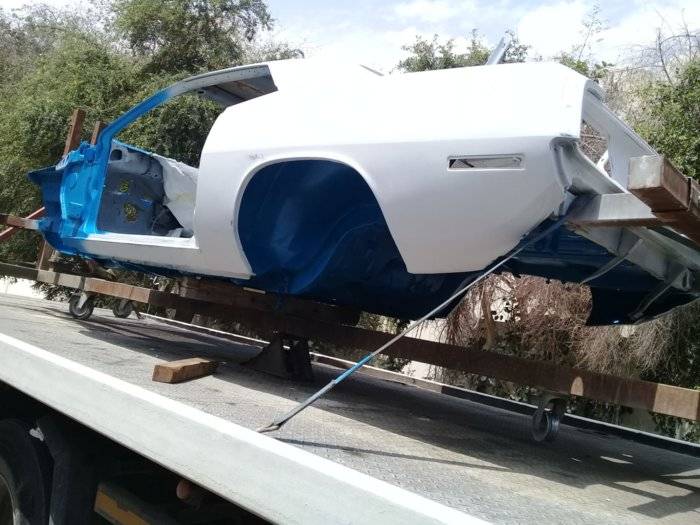

  8. fighter
    fighter Well-Known Member
    Messages:
    59
    Likes Received:
    12
    Joined:
    Dec 6, 2011
    Location:
    qatar

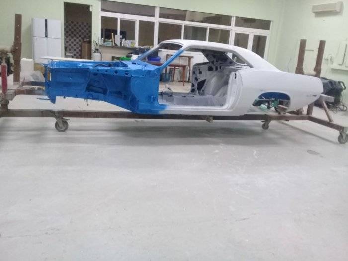

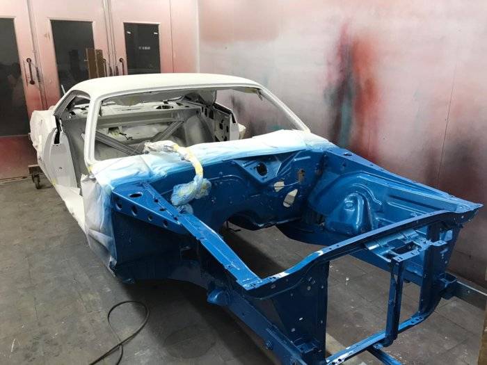

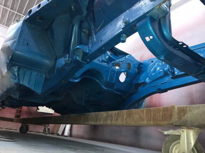

    cuda is back from the paint shop after a very long time I miss her. seen here partially painted for a reason im going to cut some metal front rails inner fenders and maybe more to install the body on the new chassis I know guys it is heart breaking for an original barracuda but you have to scarifies things sometimes for other things you like:) will post more photos in progress

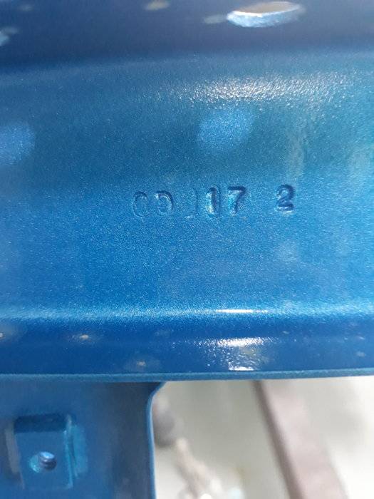

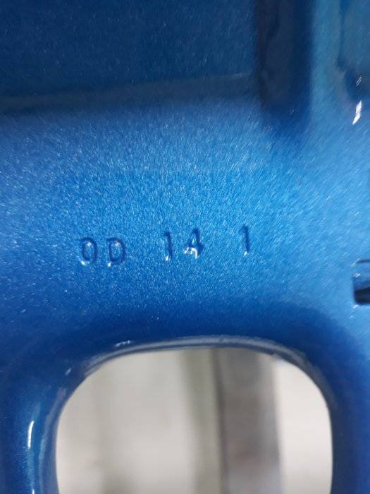

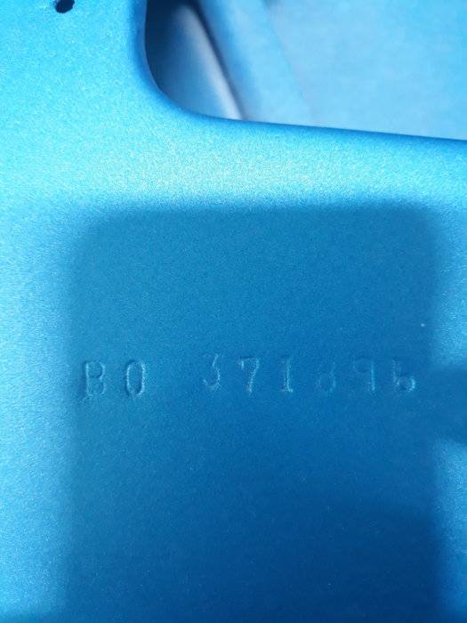

    I think the painter lost the fender tag somewhere :elmer:but I got some pictures of the cowl and radiator support area plus I got this from the car papers long time ago check them out and advice me any body here with the options please
    Row 1: M21 R11 V02 V5W Y05 EN1
    Row 2: EW1 A93 C16 C55 G36 H51.
    Row 3: EB5 L6XW 000 610 127083.
    Row 4: E24 D31 BH23 C0B 371896. Thanks!
