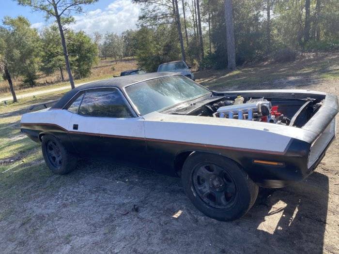

    Hello gents. I recently picked up a 5.7 hemi out of 2008 ram 1500 and am planning to drop it into my 1970 barracuda grancoupe. Any suggestions? I have questions about which harness I should go with and where to get adapters for my speedo and for shifting

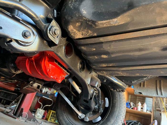

    Just the factory 545RFE. Ive talked to the guys at Hotwire and I’m just waiting to get a harness now. I’m wondering if my rear end will be okay or if I should put my extra 8 3/4 rear end under the car
  7. Gen 3 Cuda
    Gen 3 Cuda Member
    Messages:
    20
    Likes Received:
    5
    Joined:
    Mar 25, 2018
    You're on the right track talking to Chris at Hotwire. Super nice to deal with. What rear is under the car now? An 8 3/4 will be plenty strong for a stock 5.7.

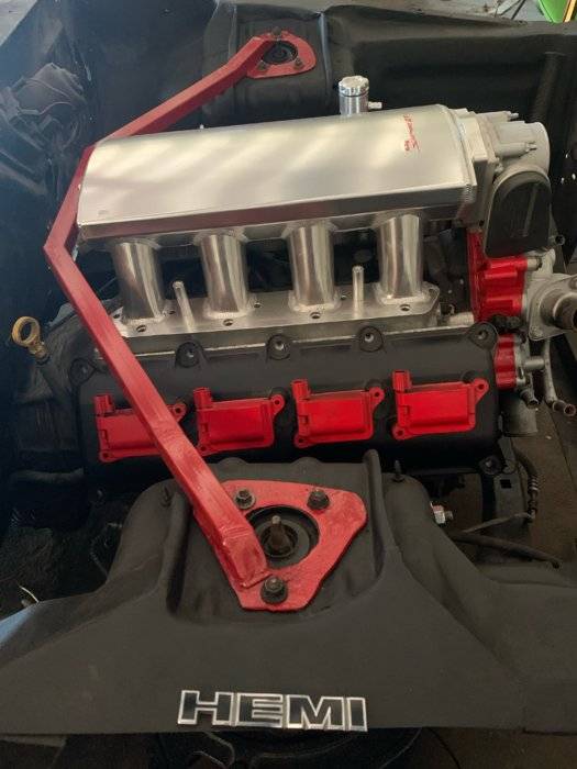

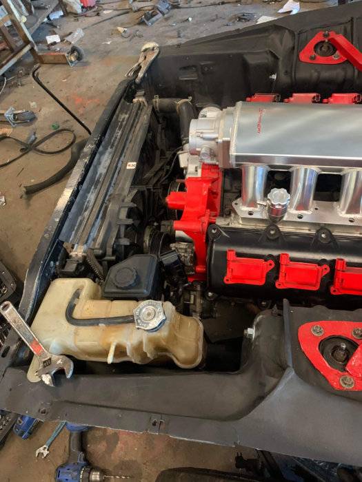

    Is but direct from mopar the CPU and harness kit. It will be new and have all he right connectors. Yes it's 1500 bucks but find a friend with an employee discount like I did and go. I just finished my 392 install. It was a tight fit but she runs like a raped ape now. 7345453794 of you wanna know anyhjng. Peter.
