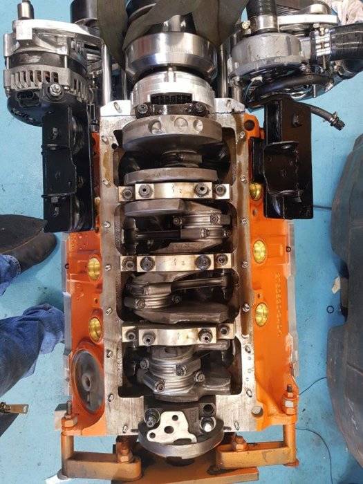

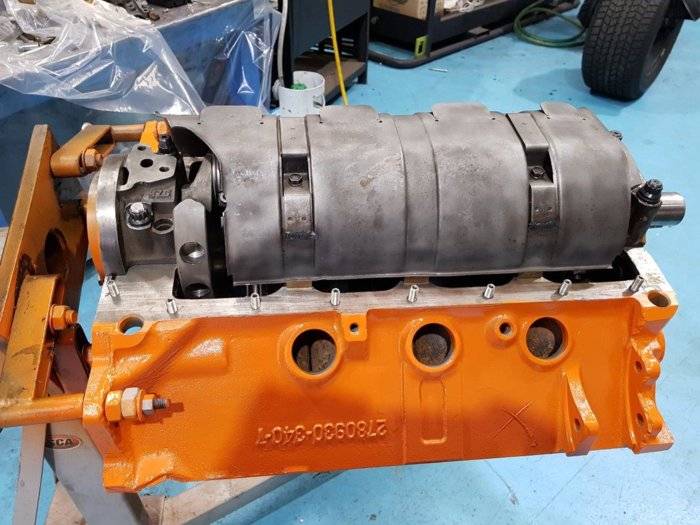

I used the 4 bolt splayed caps from Milidon as shown in marks reply i have a set of originals but shipping from Australia would be a deal breaker you would still need to line bore see pics windage tray still fits done around 5,000 mile 392 stroker no problems. if you buy Milidon you will still need the 2 end caps
