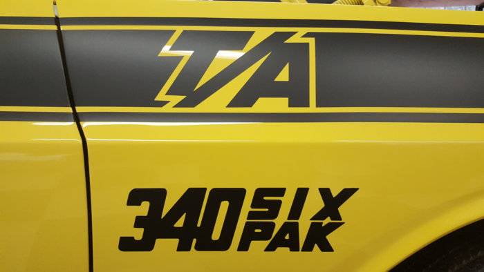

Jan 31, 2019 #2 moparleo Well-Known Member Joined Oct 17, 2011 Messages 6,938 Reaction score 1,721 Location So. Cal. Riverside area Moreno Valley The "340 SIX PAK" fender decals always lean forward. They come left and right side.

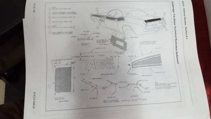

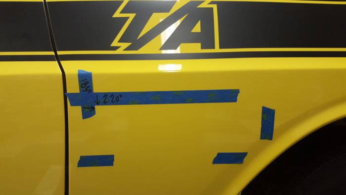

Jan 31, 2019 #3 G Grady Cain Well-Known Member Joined Mar 22, 2014 Messages 882 Reaction score 452 Location NW Connecticut Here are the measurements for you in case you're interested...
