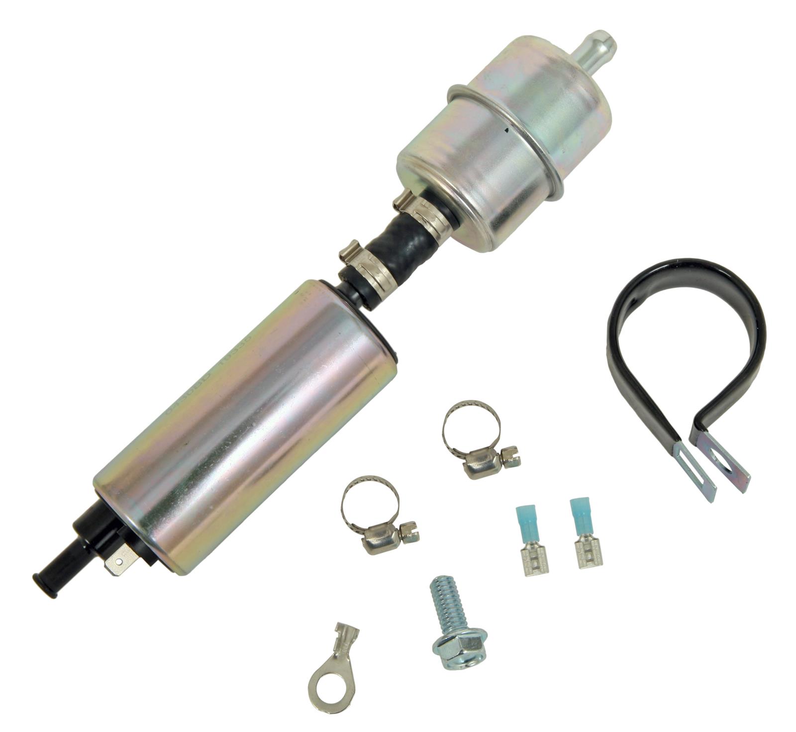

A little pump like this would work fine. The mechanical pump will pull fuel through this one when it's not running.

Thanks. Can I run it online with the other? Series? Or does it need its own line?
Yes in series and you run it in addition to your mechanical pump. The electric is just used to fill the carb up after the fuel evaporates. Just a momentary switch so it doesn't run constantly.

Thanks everyone for the suggestions. I put the inline electric pump in the other day. Picked one up from NAPA and put it in, and got the switch under the dash. Now all I have to do is prime the carb for 2-3 seconds, pump the pedal twice and it fires off right away. Works great now.
