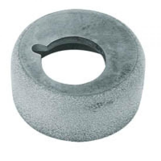

Has anyone used the Hughes cam snout extension and retainer kit along with their fuel pump eccentric? With those two pieces from Hughes, it looks like I can use the timing cover off my 85 block that has provisions for a mechanical fuel pump.
http://www.hughesengines.com/Upload/productInstructions/HUG7013March2012.pdf
HUG 7013​

HUG 10003​
FUEL PUMP ECCENTRIC W/ MOLY
Fuel pump eccentrics are designed to fit engines equipped with a mechanical fuel pump. They are moly coated for extended
I have not used Huge's kit, but it will work. Actually I like the idea of using the 85 water pump housing. It will make the engine look more like an original instead of later model magnum. Stealth! 😁
