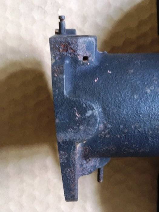

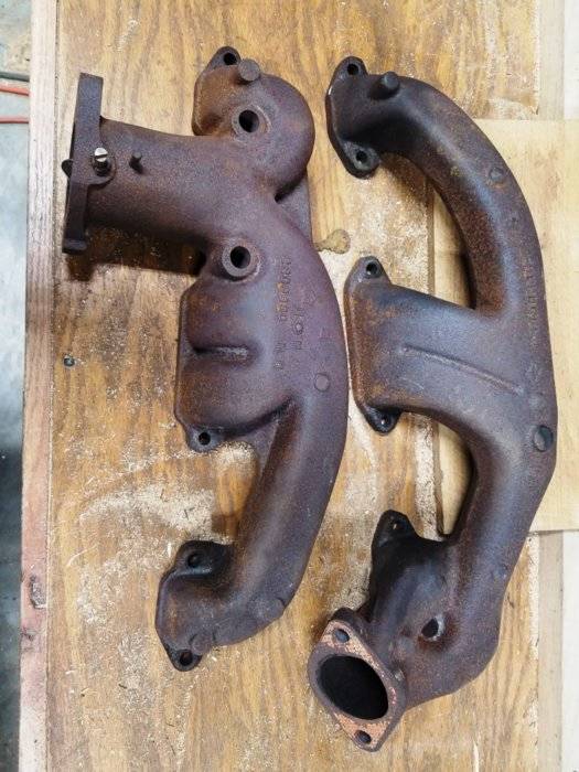

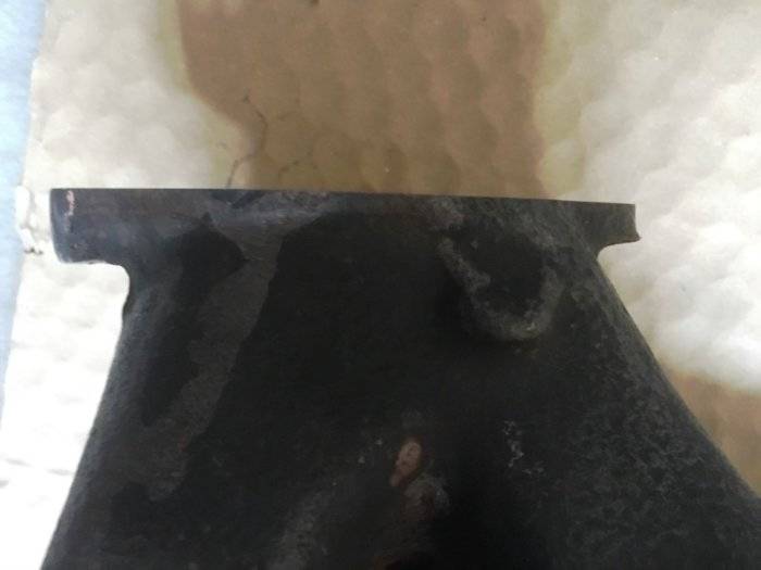

    Before I completely disassembled the Challenger for restoration, I had slight exhaust leaks at both manifold/head pipe joints. Since the car is apart, I took the exhaust manifolds (RH#2899879 / LH#2951865) to a well rated machine shop to clean up/true up the outlet flanges. (I know I have to "true up" the head pipe flange faces, too.) I was expecting the machinist to remove a couple hundredths or so. Instead the faces now have a "front to rear" taper. The front of each outlet flange is about 0.330" thinner than the rear of the flange at the bolt holes.
    I can only think of three options on my end:
    1. Have new head pipes custom made with the flange at the correct angle when I put the exhaust system back on.
    2. Have a machine shop taper two 1/2" exhaust flanges to match the manifold taper and install them between the manifolds and the existing head pipes to get close to square again.
    3. Buy replacement manifolds - a significant expense I hadn't planned for.

    That flange is so thin it will not hold up. The pipes are heavy. That machinist has destroyed your manifolds. This is totally unacceptable!
    I choose option #4) You should seek compensation from them for replacement manifolds, AND get you bill refunded.
    1969 and older right side has the bolt holes moved, pipe mods needed now.
    This photo is how the flange should look.

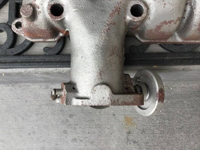

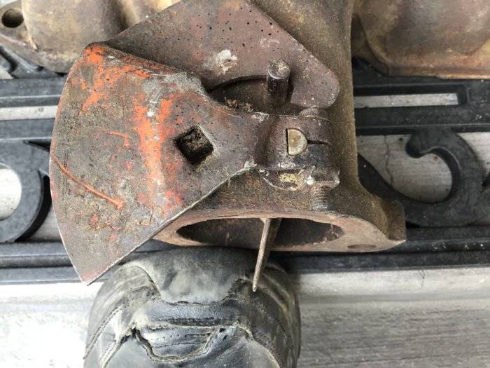

    Check the position of the heat riser flap centre pivot (axle) I checked some of mine and while the manifolds look the same the flap pivots are 90 degrees different on some which may cause problems you can see the extra boss in the last photo the hole for the pivot is drilled into that instead. You could plug the holes and redrill it if need be.

    Avalanche - I purchased them out of town and have not received them yet. They appear to be cast. Here's a link to the Year One ($600 with free shipping) site plus a shot of the as purchased used manifolds off Craigslist.
    1966-74 A B E-Body Exhaust Manifold Set
    Aussiemark: thanks. I am aware of the different heat riser location. I have the plugged manifold crossover valley pan so I will "disable" the heat riser anyway. As you can see on the picture, the heat riser counterweight is missing. I'll keep an eye out at swap meets for one........

    That missing counter weight is the same on a LP log manifold 1966-1969. Makes it much easier to find.
