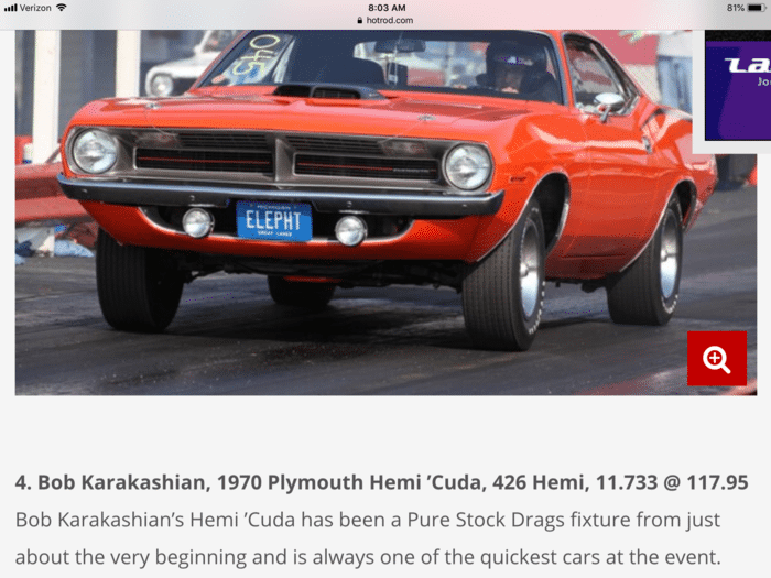

Mr 6pack has an original EV2 Hemi Cuda that he uses in the F.A.S.T category drag racing that car would have to be close to 600hp he has been campaigning that car for years and I don't think it would have any extra bracing or modifications just the original torque boxes that are probably on your car now. If your tyres are normal width it will break traction before it winds up the unibody too much and if you only race it once in a while it should be ok. Put the matching numbers block in the corner, get your Hemi and go for it.
413
Mar 23, 2019
193
96
No, he doesn’t. Bob K (Mr 6 pack) runs in pure stock and goes 11.70’s. The cars in the F.A.S.T. class are 500+ cubic inches and go 9’s: big difference.
Bob K’s car is a real Hemi body with a Hemi. Looks all stock, not cut up, it can’t be to run that class. We can figure that 117.9 mph in a 3900 lb car is right at 500 horses.
Hey go run the pure stock with it as a 440 4 speed Cuda that it is, that would be great!

Thanks. This is exactly the info that I am looking for. My car came with the A33 Track Pak which includes the torque boxes for frame strength. The only difference between Mr 6pack's car and mine is the engine and transmission. My 4spd is a hemi 4spd his is auto. Also I have the stronger Dana (heavier) rear end vs his Chrysler 8 3/4. A Hemi 500hp/500ft/lbs engine would fit the bill.

What I’m saying is, keep the car as it is. You have a 440 4 speed number car, LEAVE IT THAT WAY! ITS AWESOME THAT WAY! Build the original motor to a 500 horse fun machine with quality parts and it won’t blow up.
That what Bob K did with his, left the engine trans combo original. A Hemi auto car all stock pieces, no headers, original carbs, stock brakes, stock wheels, etc it has to be like that to run pure stock. He could go to a car show with it and be all correct, he just made some more power.
Your car is a 440 4 speed numbers car.
LEAVE IT THAT WAY! There are guys pulling a U code 4 speed stripped rolling shell out and restoring it back to original, its what you already have, don’t muck it up!
YOU said you didn’t want to hurt the value. Well a Hemi swap will hurt value, it will do what you don’t want.
Build a 318 barracuda into your HEMI DREAM clone car. And have a great time doing it!
