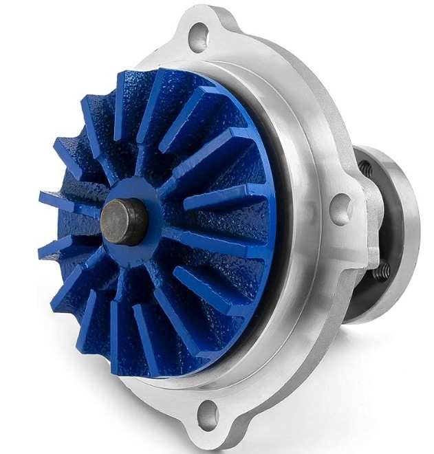

I am looking at options to overdrive my 440 water pump. My existing pulley setup is the March Serpentine Kit 40550-8 in black powdercoat. This kit has been on my 440 for over 20 years. No cooling issues except in Florida. Go figure.
My idling temp creeps upwards to 210°F with a 195°F thermostat. I am using all factory cooling components except for a Speedmaster High Volume water pump. I had a Milodon water pump previously and had the same issue. It may be that Florida is just too hot and humid for the factory systems.
That being said, the crankshaft pulley diameter is 6" and so is the water pump pulley (fan pulley) which provides a 1:1 ratio.
The Factory Service Manual (FSM) shows a 1.4:1 crankshaft to fan ratio (see in FSM chart below) which would require changing one of the pulleys to get to 1.4:1 overdriven. My other factory components are in the green boxes. Usual stuff, shroud, 7-blade fan, etc.
Option: Keep the 6" crankshaft pulley and reduce the fan pulley to 4.25" to achieve 1.4:1 overdriven for the water pump.
The fan pulley drives the water pump AND the alternator so it may need to have a 6"/4.25" combo pulley to drive both pump & alternator correctly.
Does anyone know if March makes a 4.25" version of the dual, belt fan pulley?

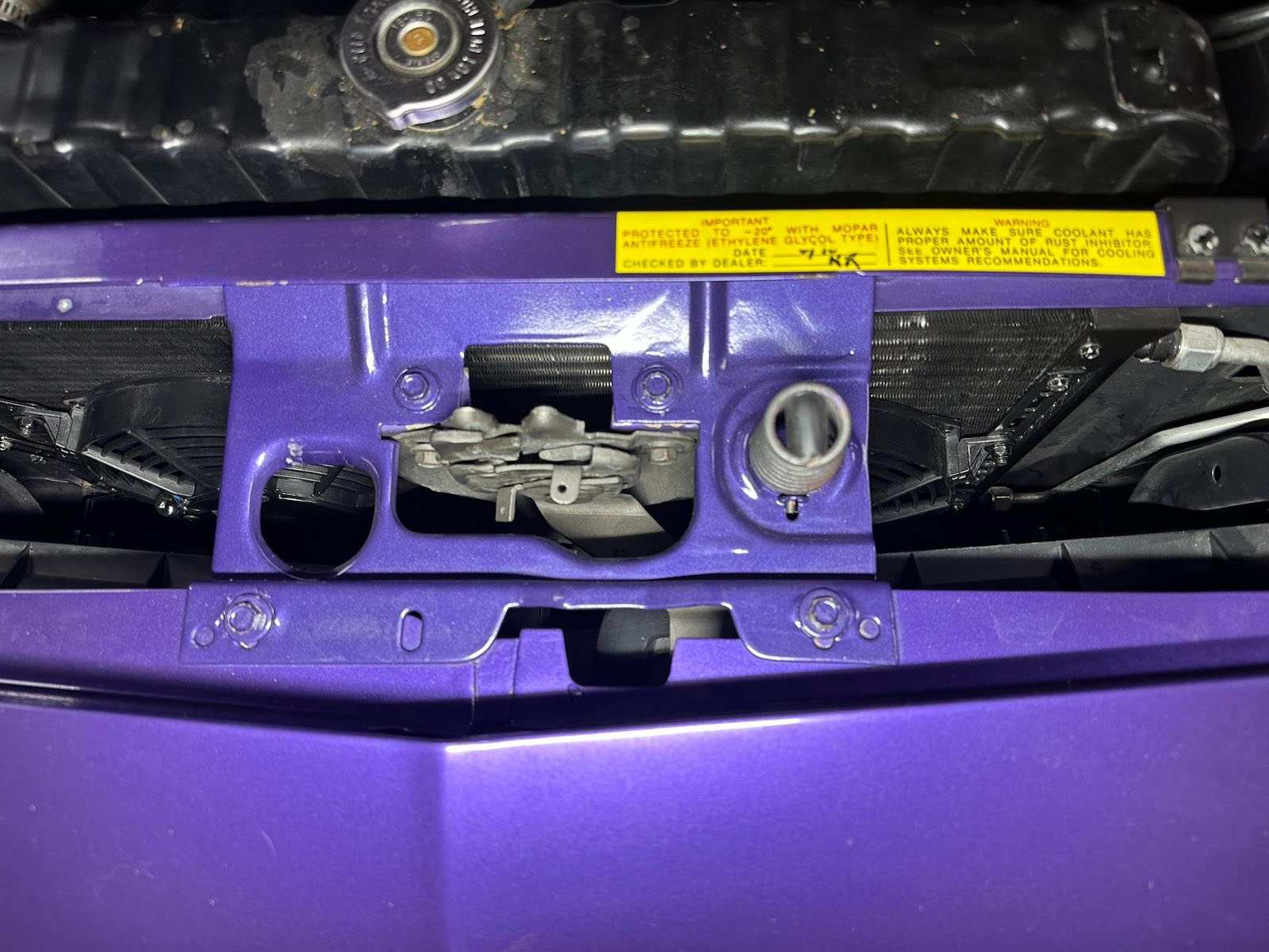

Factory style 26" Modine radiator with 16lb factory style radiator cap and 195°F thermostat, 7-blade factory fan 2863216 and shroud, and fan clutch (it works correctly). Both crankshaft and fan pulleys are 6" serpentine (1:1 ratio) by March Performance. Sanden R134a A/C kit from Classic Auto Air.
Radiator/block was recently flushed until water ran clear and then filled with 50/50 mix of Prestone antifreeze and a bottle of Water Wetter. I have considered going to a 90/10 mix to maximize the better heat transfer of water. It is Florida so it never reaches anywhere close to freezing anyway.
Absolutely no cooling issues in Missouri/Georgia. Florida heat and humidity is the culprit.
Engine is a 1999 500 CID Mopar Performance crate motor with Indy 440EZ aluminum heads and 11.15:1 compression ratio. Cam is .545/.545 lift with 241°/247° duration at 0.050.
Timing is 16° BTDC and controlled by Holley Terminator X Stealth fuel injection with Holley Hyperspark ignition and distributor. AFR is 13.25:1 at idle speed of 900 rpm, all controlled by the Terminator X fuel injection's Bosch 4.9 O² sensor.

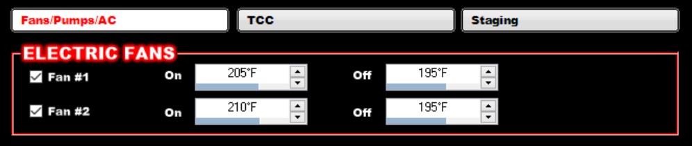

The Coolant Temperature Sensor (CTS) for the Terminator X display is digital and the temperature reaches 210°F in slow-moving traffic and will creep up at a traffic light to 215°. Max temp I have ever seen was 219°F at a traffic light.
I also have two, supplemental Spal 9" electric pusher fans on the front of the A/C condenser. Each fan is approximately 600 CFM and has its own relay controlled by the Terminator X individually. Fan #1 ON 205, OFF 195. Fan #2 ON 210, OFF 195.
At speed the electric fans do not come on and coolant temp is 195°F.
