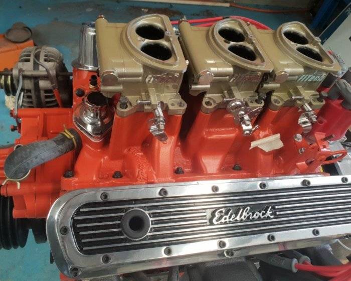

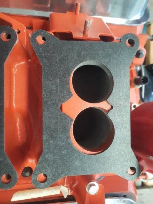

Sep 19, 2018 #1 AUSTA Well-Known Member Joined Apr 16, 2015 Messages 937 Reaction score 501 Location PERTH WA Did the original 6 pack have heat spacers under the carburetors attempting to fit the new fitech & the supplied gasket only has about 1/16 sealing area on the front.
Sep 20, 2018 #2 quapman Well-Known Member Joined Dec 28, 2008 Messages 878 Reaction score 225 Those look to be about the same as factory as far as thickness. Different inside shape, though.
