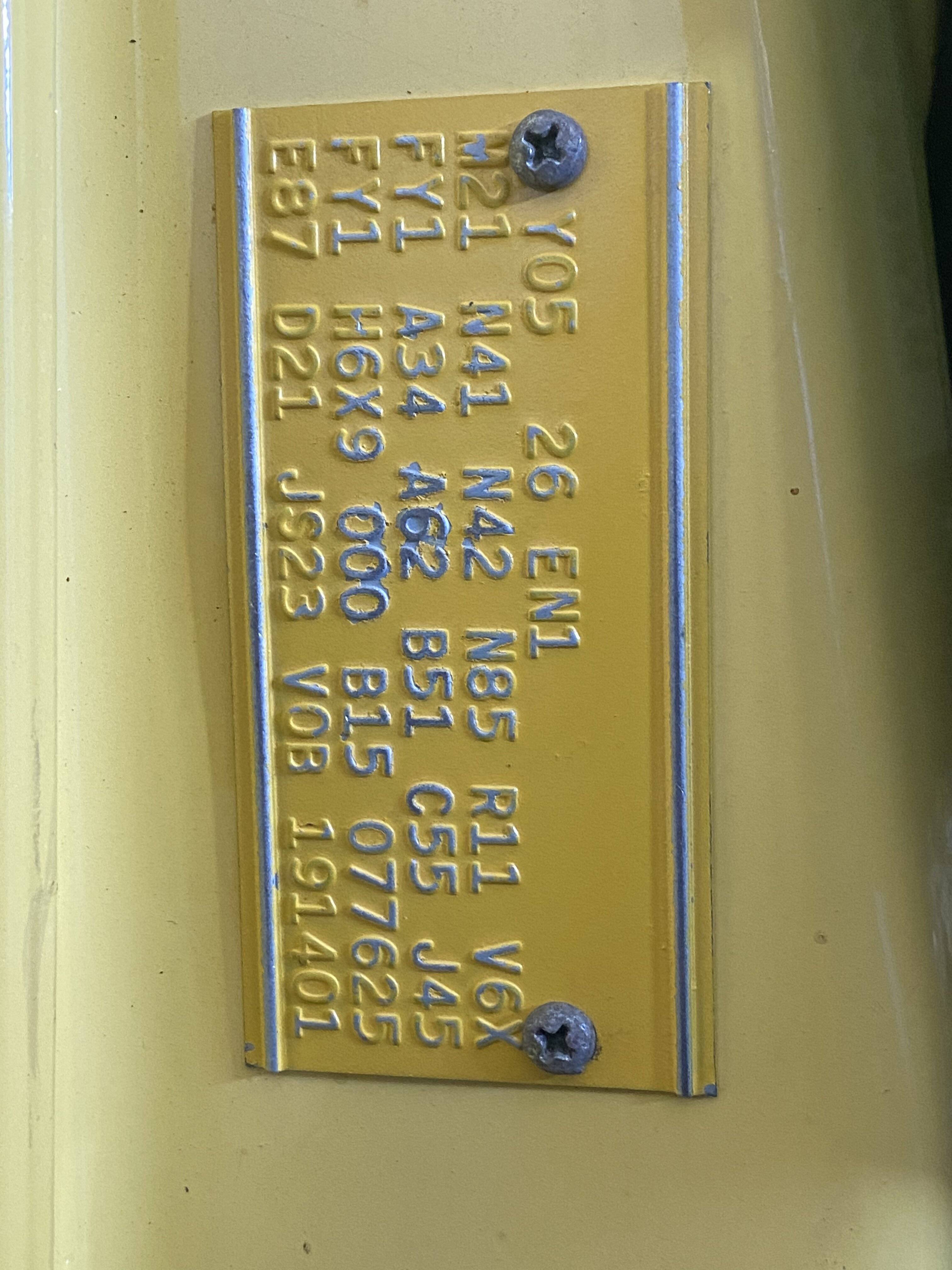

Can you tell by looking at this fender tag?

My Challenger has the N94 TA hood. It’s not on the fender tag. I heard some came with the hood in 1970 but it was not on the fender. I guess what I’m seeing is that I like the steel rally hood. I will start looking. Going to need the hardware as well and hinges. Or just the springs. My hinges might work.

No N code usually will have the Ralley hood , N85 is the ralley dash with Tach
If it was ordered with N96 Shaker it might have the N94 TA hood as a replacement .
Hinges should be fine with stronger springs , you will need the hood latch & safety catch
