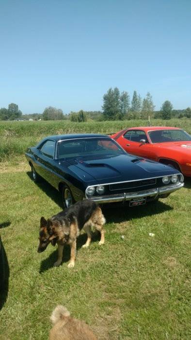

    Hello e body dudes. Just retired last year and am almost finished building my place in Sequim wa.
    Going to swap out the dash , put in a four speed , and rebuild the 340.
    I have been collecting parts and this fall I should be ready to start the fun.
    I hope to learn some things from you guys when the time comes. IMG_20190531_140154399.jpg
    Thank you....

    Welcome to the site from the Motor City! Original 340 car?

    Found the car in Krum Texas. It had good bones. Was a Cal car originally six banger.

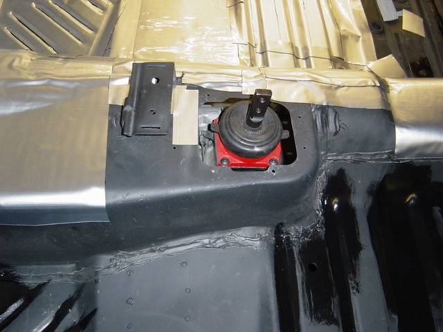

    6CE80981-B92A-48BF-9D53-8839FCF69321.jpeg I have a Tremec TKO 600, with a hydraulic clutch. It fit the tunnel without any cutting. It did almost touch on a small spot on the right side, but I used a pry bar to push the tunnel out a bit. And the shifter was nicely in the center of the factory hole. There are different configurations (shifter locations) so do your research.
