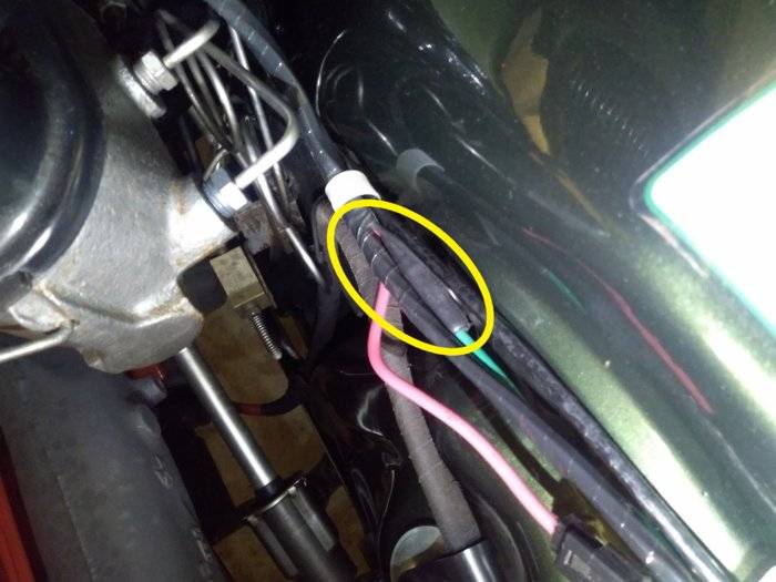

Hello.I have a 70 Challenger 340 4 speed that has been acting up the past couple of months.I push in clutch as it has the safety switch and nothing. This is random and may do it several times in a day and may not happen again for a week later. When it does this I cross over the starter relay and it starts right up.At first I changed starter,realy and positive battery cable and it still does this. My clutch safety switch was rebuilt a year ago. I just ran a ground wire to relay and bypassed the clutch safety switch and it still did it again tonight after several starts with no issues. Im baffled. Anybody have any thoughts? Thanks.
