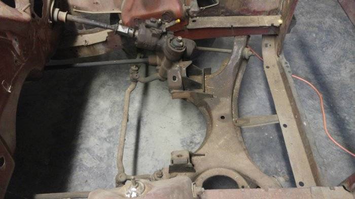

If I am not wanting to spend a lot of money in upgrading the suspension and keeping it close to stock parts, what are the main items I could upgrade that will make a difference. I am not interested in strip racing or cornering. Just making a casual driving car. After all, it only has a 318 motor. However, I will be shooting for increasing the HP to approx 300-320.
Also - Is it possible to drop the k-frame with everything attached. I understand I will need to disconnect the torsion bars, shocks, and steering shaft. Anything else? Thanks

The steering column and the brake hoses, of course, but the little lower Rad support bracket got me once (maybe twice lol). in the picture its still attached to the k frame.... ground wires?..

The little lower Rad support bracket. in the picture its still attached to the k frame.... ground wires?...
Yes the bracket. Thanks. That would be terrible if I forgot that. Also I will roll up the extension cord although I may need it for extra lighting.

Top A arm adjuster bolts. They are mounted through the body shell.
Thanks for the reply on the upper mount bolts. That should be all the connections to drop the k-frame member out with rest of the items attached. I just don't want to pull everything apart at this time. When I am ready to reinstall, hopefully I will have a better understanding of what is necessary to restore/upgrade. I want to keep as original as possible with some improvements.
