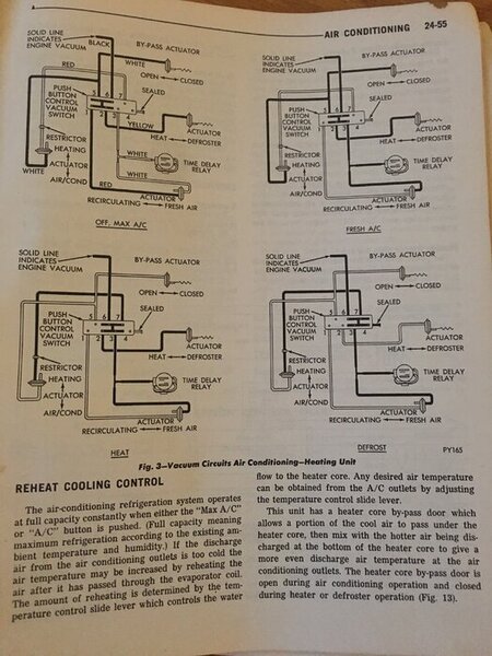

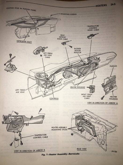

NEED TO SEE A PICTURE IF POSSIBLE OF THE HEATER CONTROL CABLE LOCATION IM ASSUMING IT GOES TO THE TOP OF THE HEATER CORE BOX,BUT IV BEEN SEEING POSTS ON A CABLE GOING TO THE CONTROL UNDER THE HOOD?..THIS IS A 70 CHALLENGER SE WITH A/C...ALSO IF ANYONE HAS A VACUUM DIAGRHAM FOR THE HEAT/AC ALSO...THANKS FOR ANY HELP.

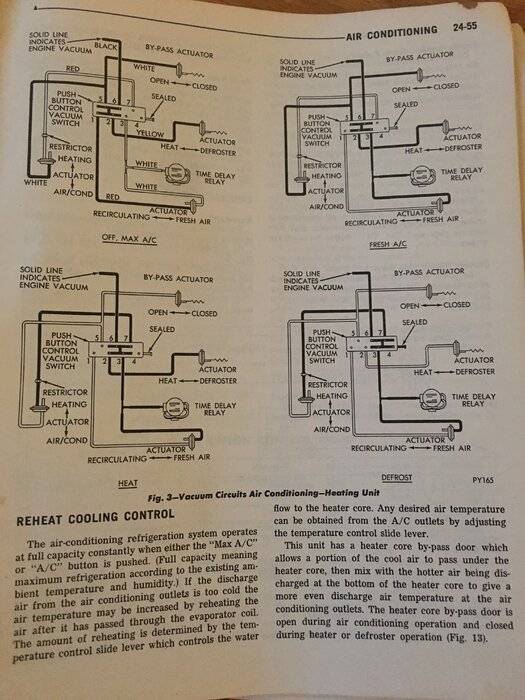

I happen to be looking at my Plymouth manual. Found this that may help. Not sure if barracuda is close or the same.

YES IV FOUND THOSE AS WELL..JUST CANT SEE THE ACTUAL CONECTION AT THE HEATER BOX FLAP..THANK YOU.

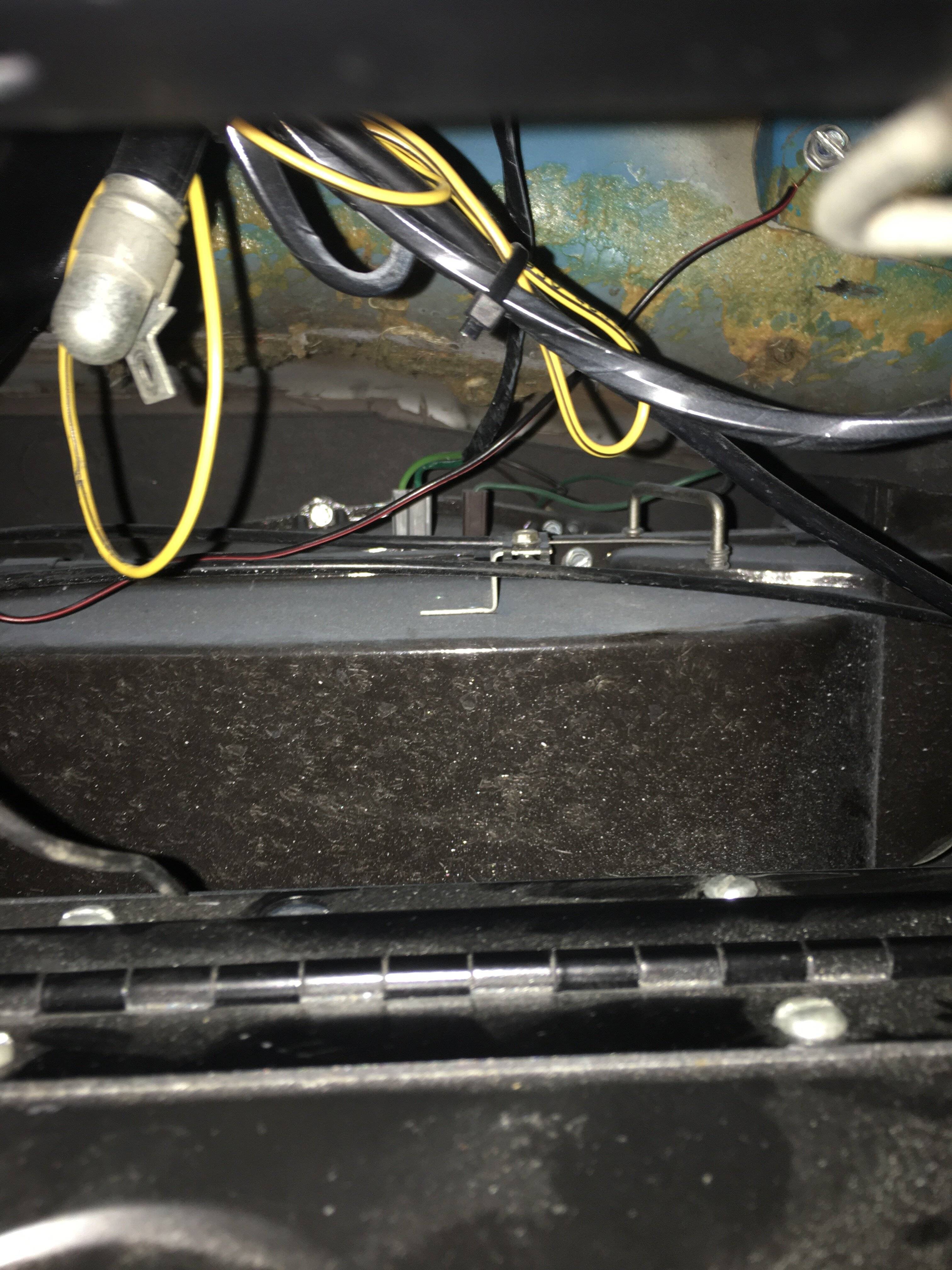

I’m working on seat belt buzzer and map light. Min doesn’t have a/c but as far as hook up, this may help. Disregard the wires mess
