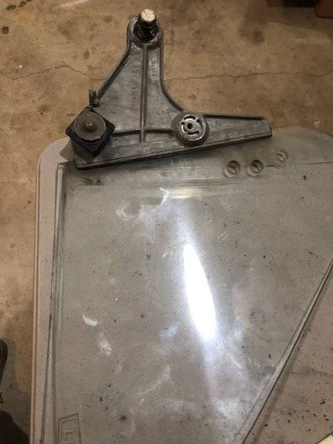

can anyone tell me the proper way to remove the bottom glide plate from the quarter glass as well as the square glide. thanks. Brian
I just put all new glass in my challenger I put the pot metal bracket it a vise i did not remove the rivets as with any of this stuff you just can't go to the local hardware store and get stuff that matchs. rubber mallet the hell out of it out being carful not bend the stainless while removing. I couldn't imagine not having a helper holding and handing me tools and hammers throughout the hole process. a piece of 2x4 is super useful when beating the glass back into the pot metal bracket. I used weatherstrip adhesive in the channel when reinstalling to help keep it place would have used windshield urethane if i had some laying around. putting it back exactly like it came out made the reinstall and fitment a breezeNo one out there with advice?
