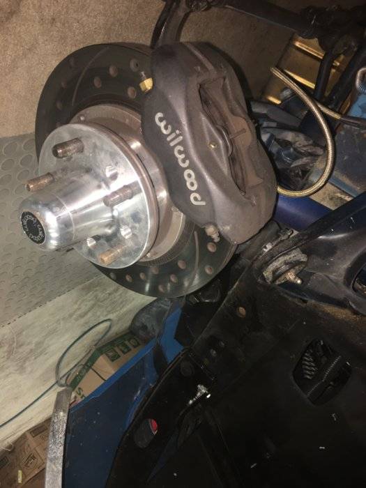

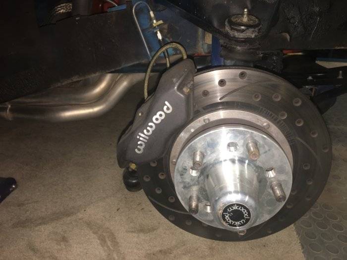

I used Wilwood on my 73. When you say outside of Wilwood, are saying the price is too high? Mine has the factory stuff as it was pwr disc from factory. Yes, they were expensive but, I spent about 600 on these. They work really well. Factory spindles. Not sure about the 70 ap though.
15” wheels fit fine.

Yea, my previous set up with the first generation purple shaft 509 cam, dual plane rpm manifold and 750 vac sec didn’t work well after getting on it. Due to 4-5” of vacuum. The 500 stroker six pack makes 12-13” vac with comp cam. Brakes work perfectly after gettin on it.
I know some people have had issues with SSBC on other post I’ve read on FBBO and here.

i used wilwood on both my challenger and my cuda... great kits. I believe you can get them cheaper at summit for instance, than buying directly from wilwood
