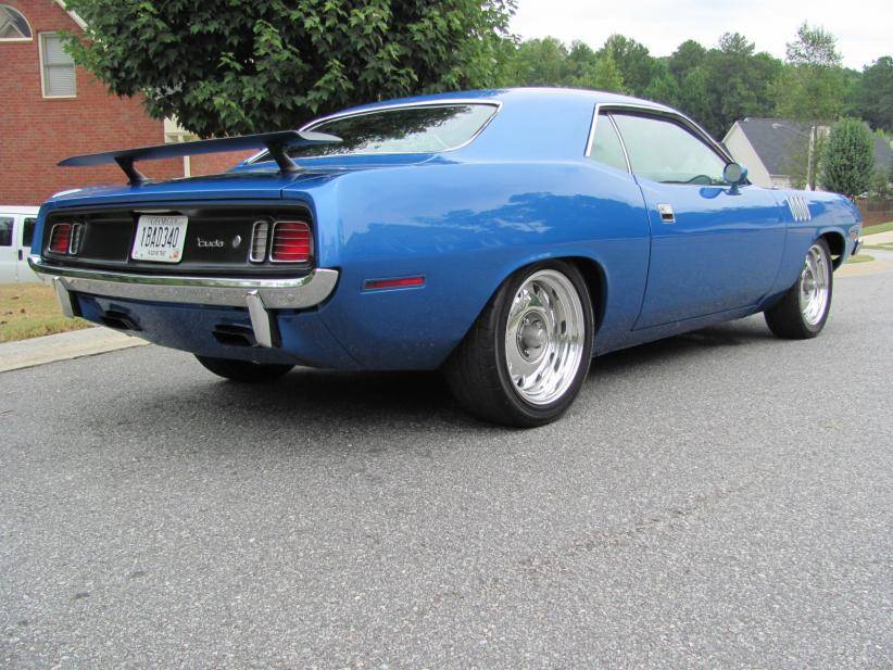

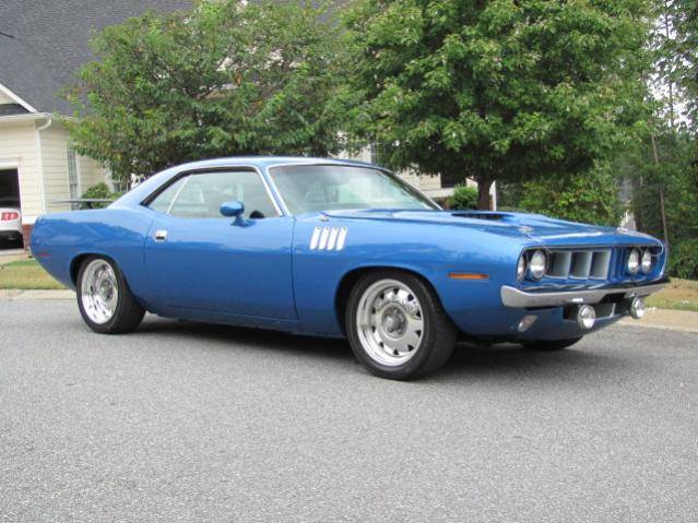

I picked up a set of Foose Legend wheels for my 71 Barracuda. The wheel sizes are 17x8 with 245 45 x 17 Nitto Extreme 555 tires for the rear and 17x7 with 235 x 45 x 17'' tires for the front. I installed the rear wheel / tire and measured 1 3/4 inches between the tire and the rear spring. All wheels have 4 1/2 inches of backspacing. The rear tire looks like it will rub on the inside of wheel house next to outside of body. Using simple math it seems that 3 inches of back spacing would leave 1/4 inch between the tire and the spring. The wheels don't look good sticking out of the body especially in the front. Does any one have any experience with this combo?
