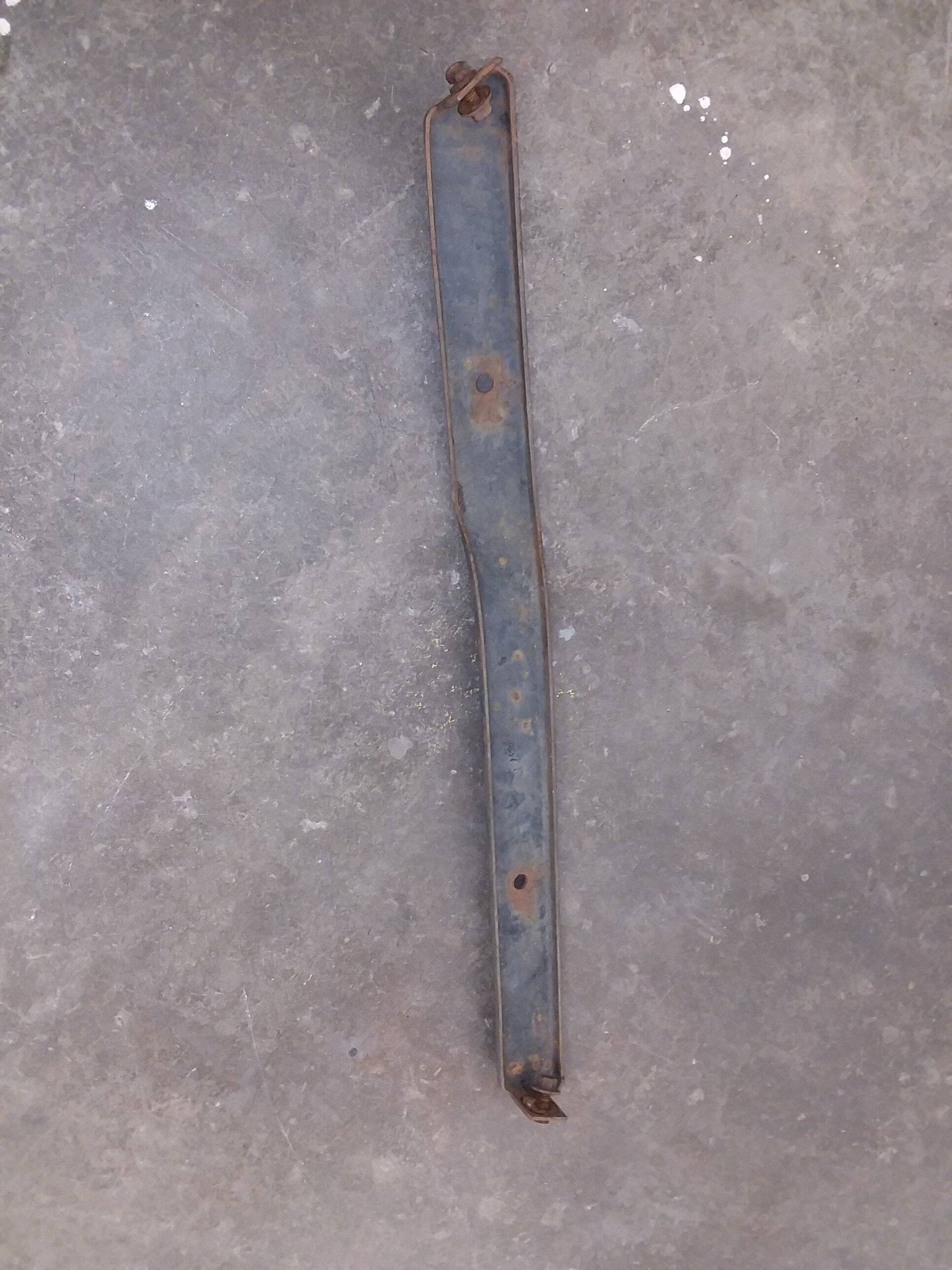

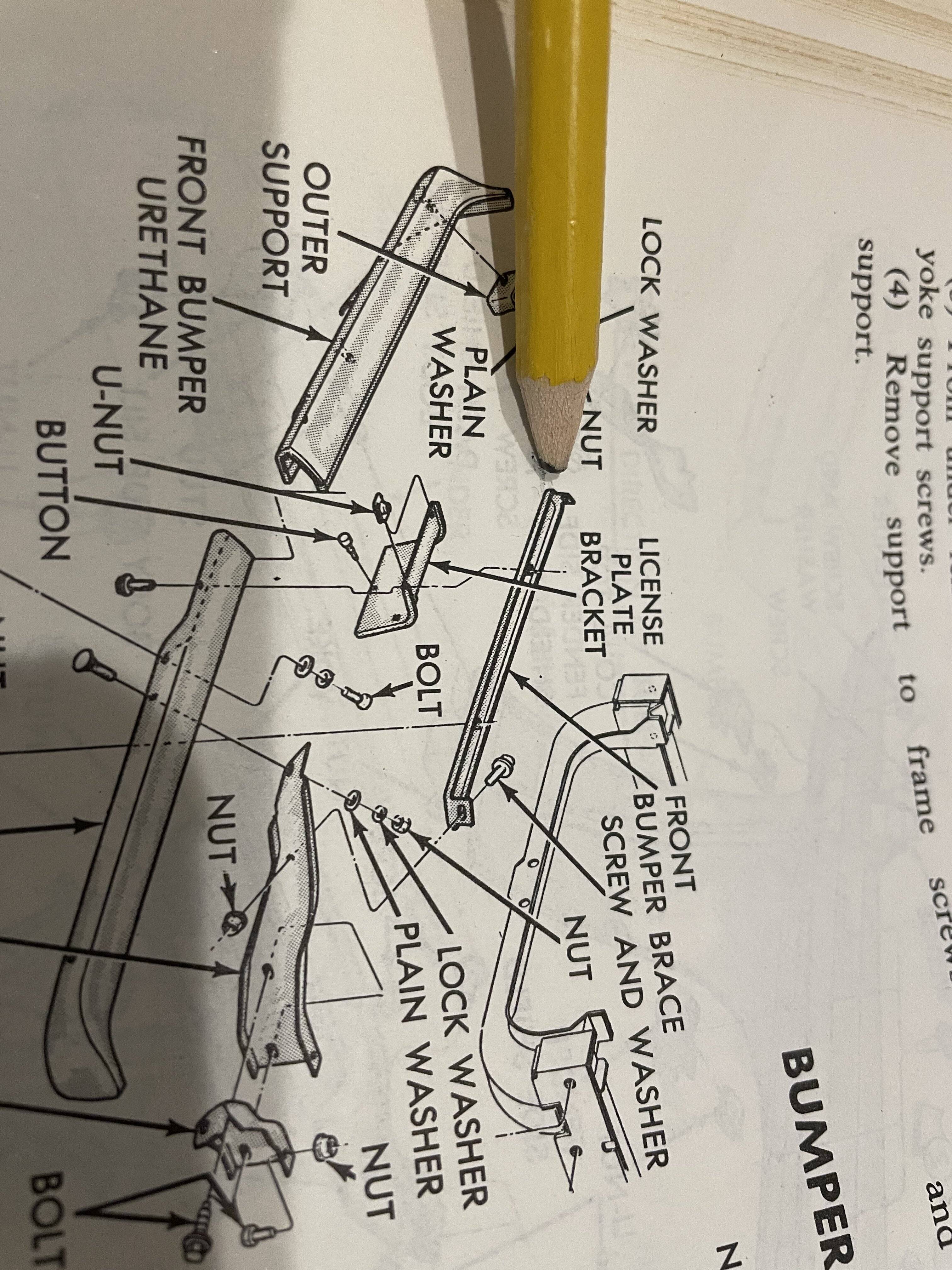

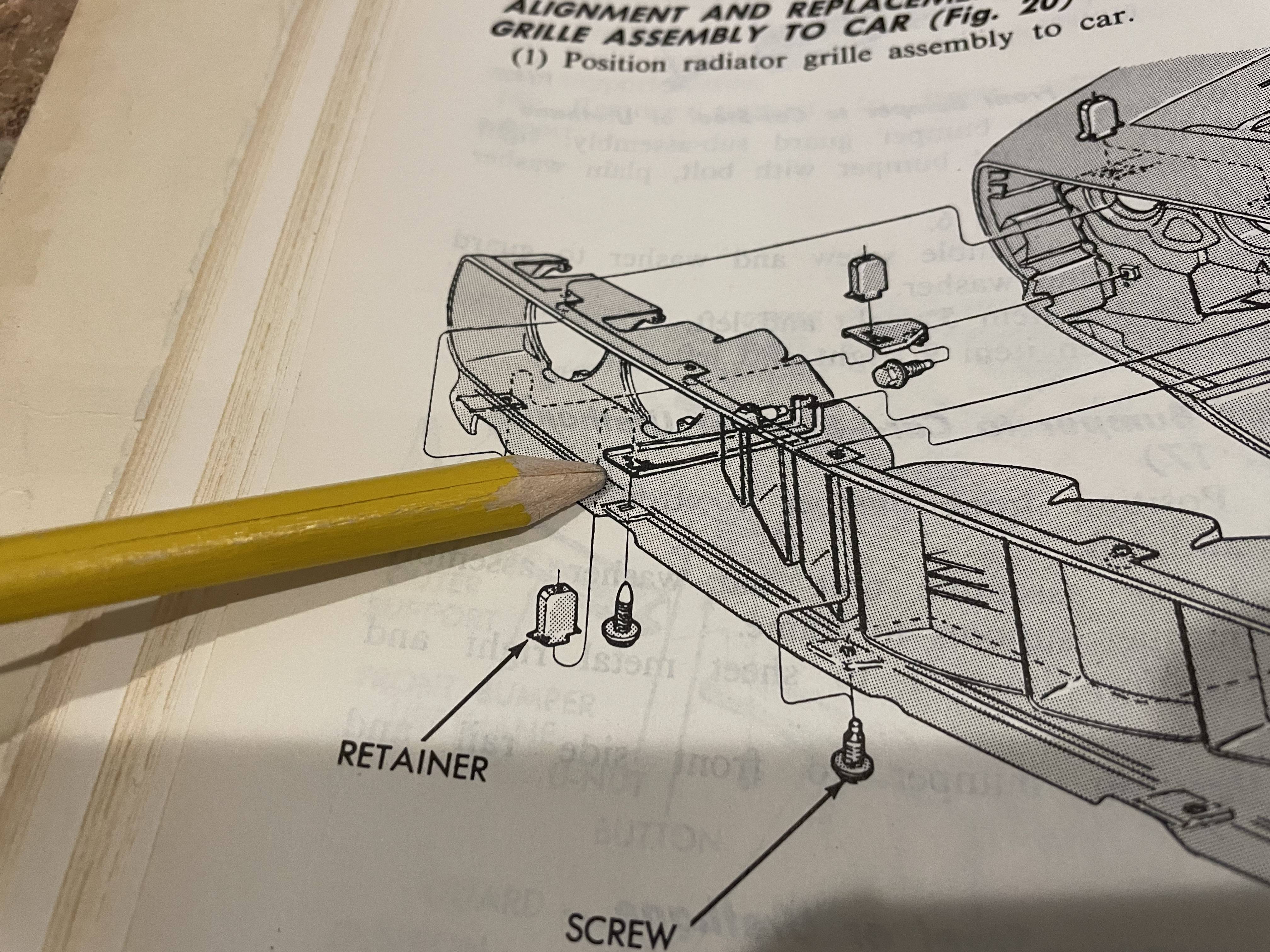

I bought this car as a shell , I’m looking too install grill, looking for bottom 2 brackets the left and right side grill mounts to there long not the two outer bottom ones the two inner bottom ones and looking for bumper brace for front I got pics of them any help be greatly appreciated

Can’t seam find them ,no one knows what talking about when I ask so I added pics ,bet lots them are missing from the cars.

i just looked i don;t have any there too i see a tab on the grill and an elongated hole in rad support but no bracket

Is it possible they were not installed for most 71s? My grille feels very sturdy without them.

Top picture.
You can make a sheet metal bracket.
It's so long, it doesn't offer any up/down support.
But controlling the in and out will keep your other tabs from breaking.
I have no extras. Mine all have them.
Bottom picture.
The bumper brace is usually only found on cars with bumper guards.
I have a spare bracket with no guards, that's been sitting outside because it has a slight wow in it. I could fix it.
