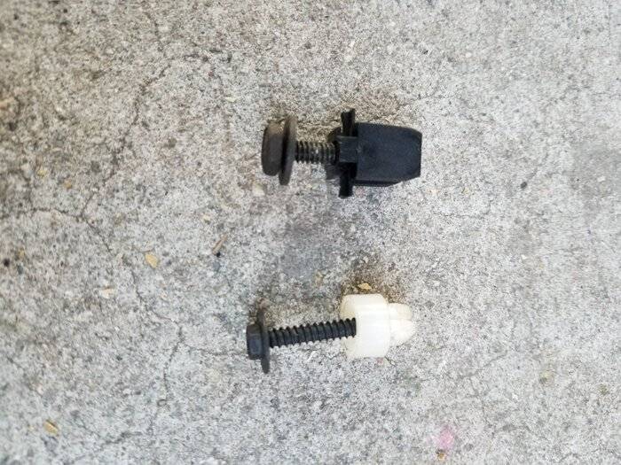

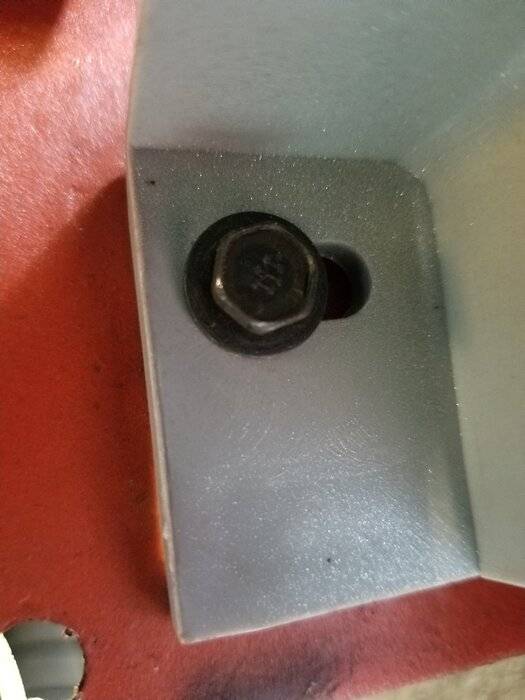

After a few hours trying to figure out the correct parts for the grill from the kits available. (not on YouTube, in the Mitchell or Factory Manuals. I looked and I have the orginals bought with the car.) The plastic is there assuming you don't have the factory speed nuts. Pop them the hole above the square on the fender to radiator support and use the long washer screws in the kit.The screws also fit speed nuts.
