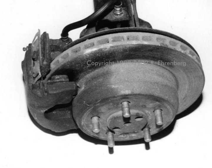

To retain your 1972 pin-type calipers, do the following:
- Replace the original knuckles (spindles) with 1973 - 1976 A-body or 1973-1974 E-body units.
- Replace the caliper adapters with units from a late 1975 - 1978 B-body (with 11.75" rotors).
- Replace the rotor splash shields with 1973 - 1989 A/B/E/F/J/M/R-body units.
- Use bearings and grease seals for the replacement knuckle application and replace the original rotors with 11.75" rotors for a late 1975 - 1978 B-body, 1979 B-body, or 1979 - 1981 R-body.
- Replace the hub grease caps with 1973 - 1989 units, Chrysler part number 3580894.
- Re-use the original calipers, disc pads (FMSI number D39), and hoses.

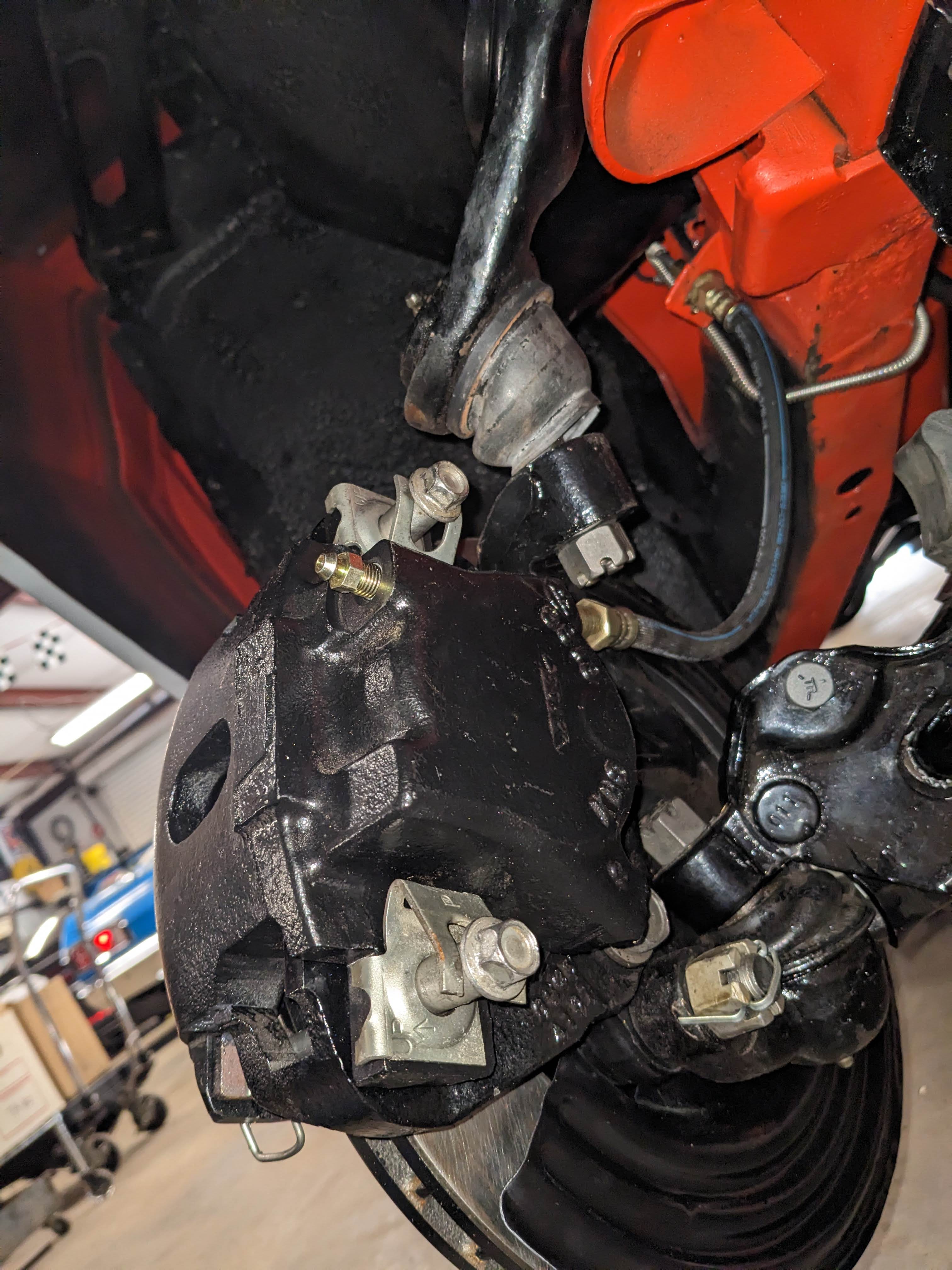

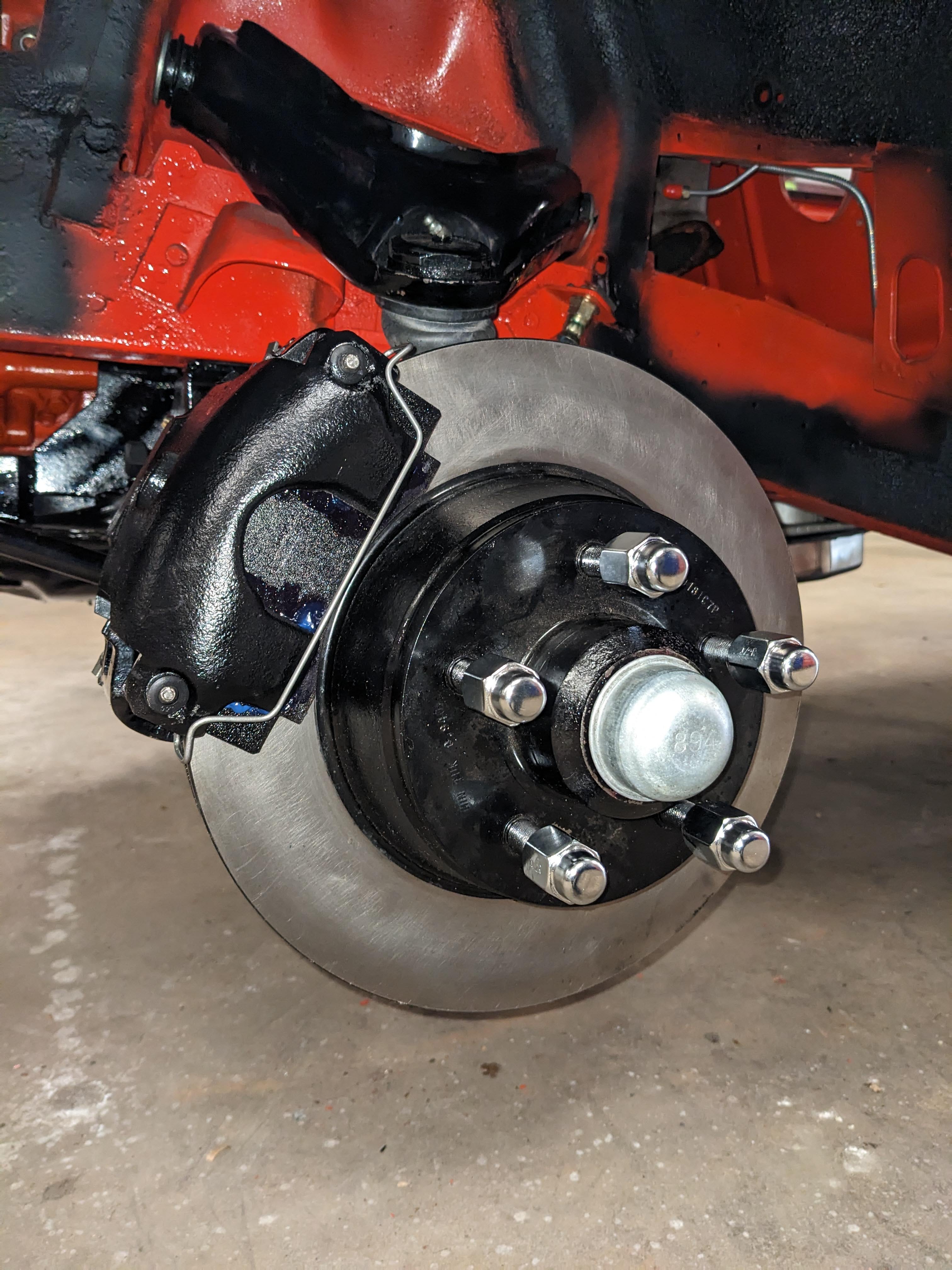

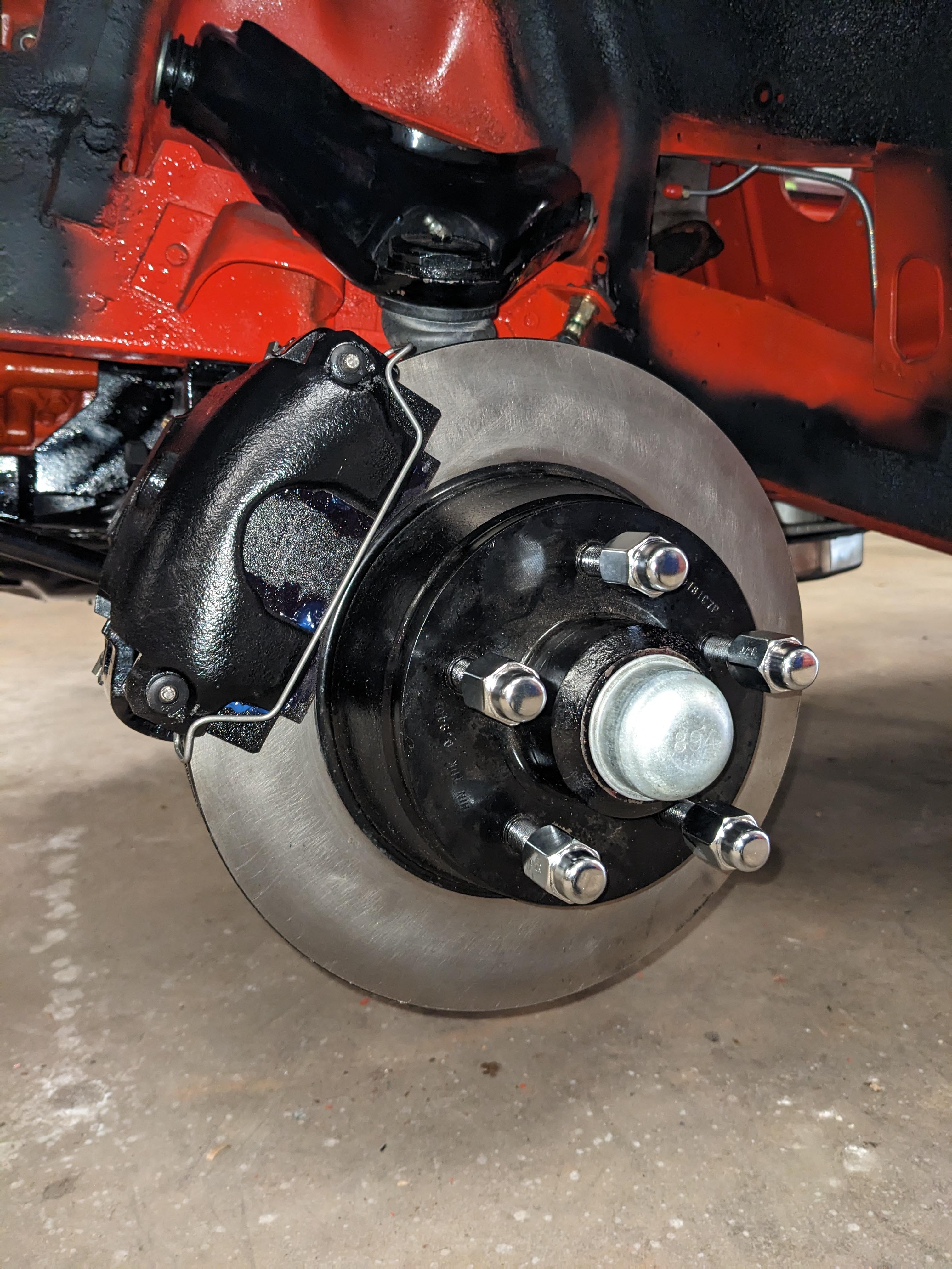

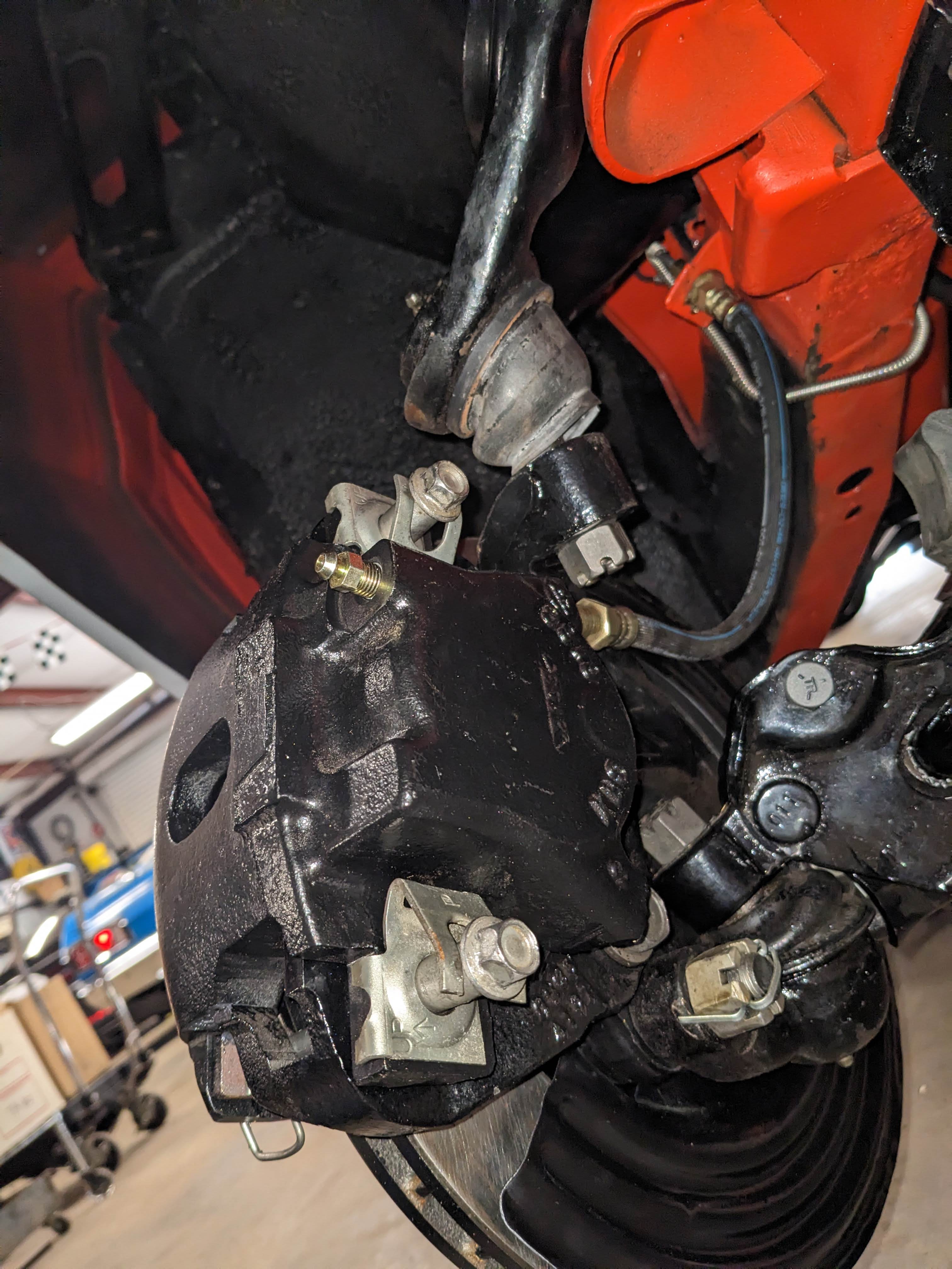

I recently did the conversion from the original discs to the 11.75" on my 1970 Challenger T/A, retaining the original pin type calipers. The following images show the installation:

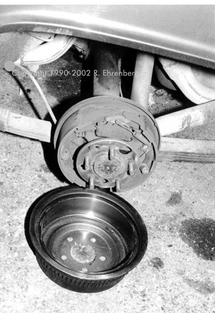

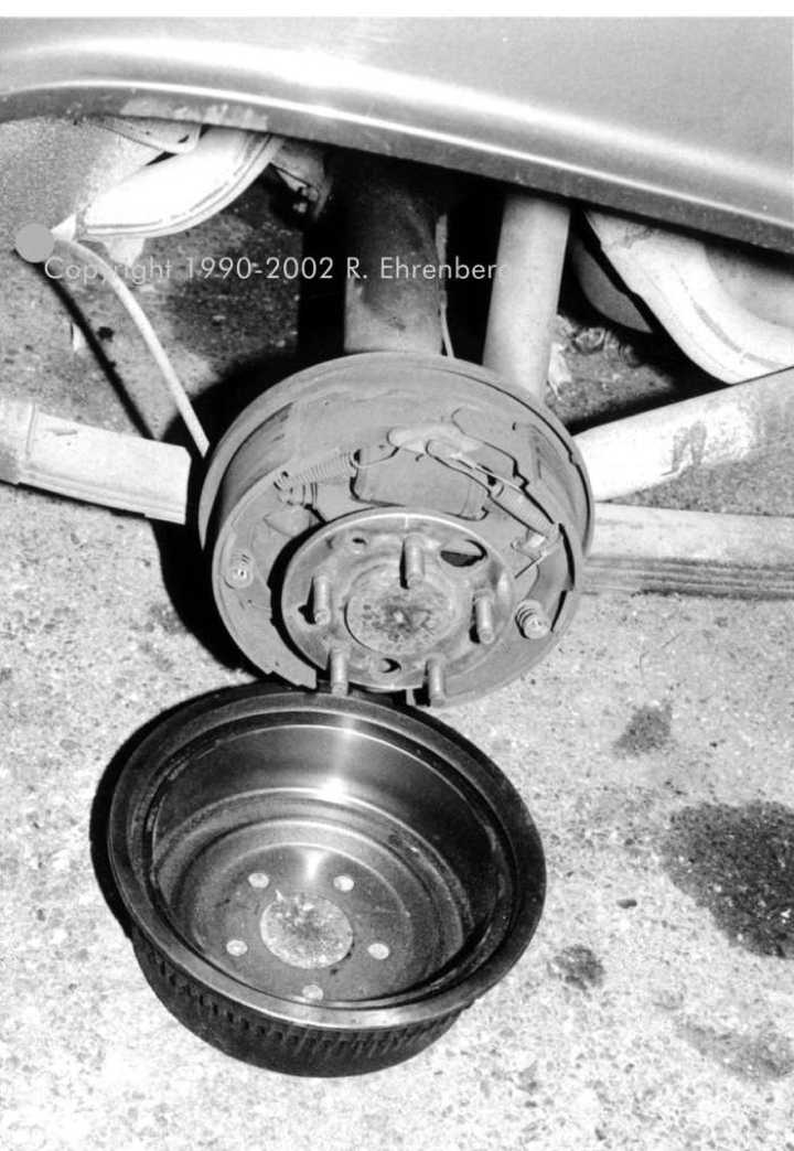

To save you some headaches. 1 Make sure that your drums are adjusted to spec. Meaning the parking brake slack is taken up. If not the brakes will not pump up. 2 The wheel cylinders are moving free.

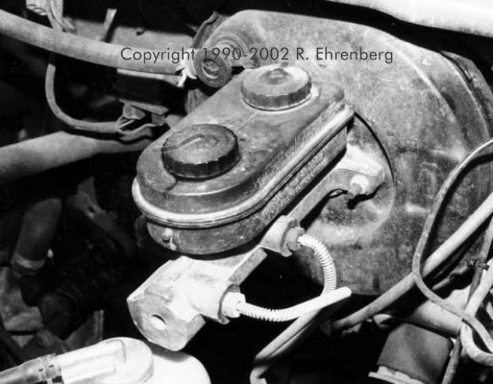

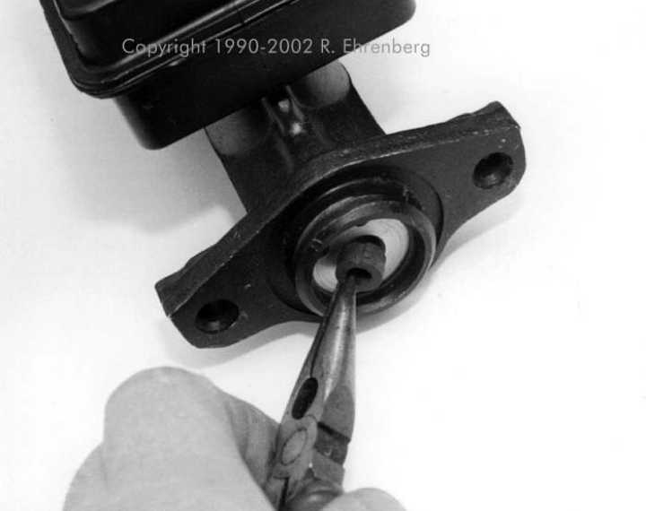

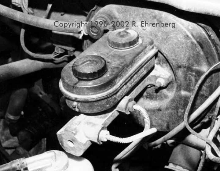

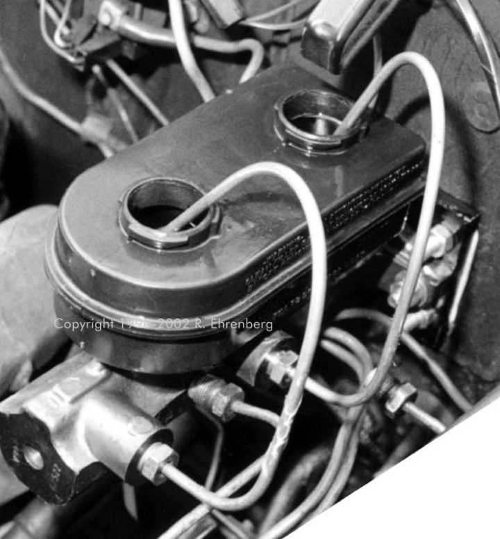

Any master cylinder used with manual brakes must have a machined recess in the back of the piston to accept the rubber pushrod retainer (most have it, but be sure check).

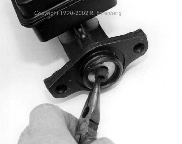

View attachment 146792Each body style requires a specific pushrod, which can be recycled from a drum setup, but be sure to pull the pushrod out of the old cylinder before removing it from the car - way easier that way. Alternately, you can use an new MP adjustable pushrod, p/n P5249316.

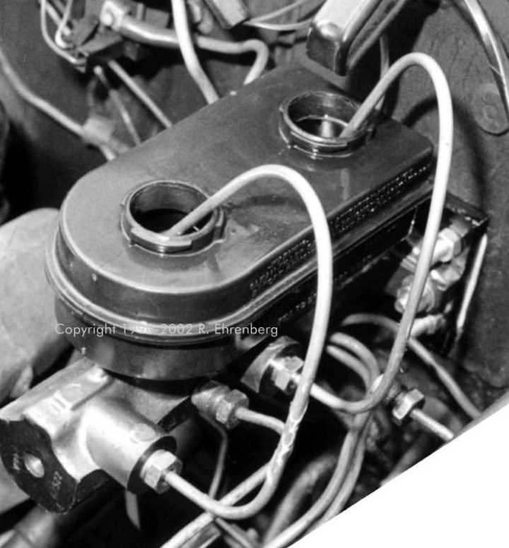

View attachment 146793If you use a 4-to-2 bolt master cylinder adapter with power brakes be sure it places the primary piston in the exact stock location -- not all do (the excellent one from AR Engineering does.) Alternately, you can, on some cars, swap to a later 2-bolt booster such as this.
View attachment 146794Whichever master cylinder you choose, it must be “bench” bled. This is actually way easier to do on the car. All you need are a set of homemade bleeder tubes. Pump very slowly, to the floor, at least 12 times. An even easier, though sloppier, way to accomplish the same task is to hook up the car’s lines, then use each fitting as you would a bleeder screw. Requires an assistant. Makes a mess.View attachment 146795Out back, your drums are fine, no matter what size
Imperial rear discs are more trouble than they are worth. Trust us on this!

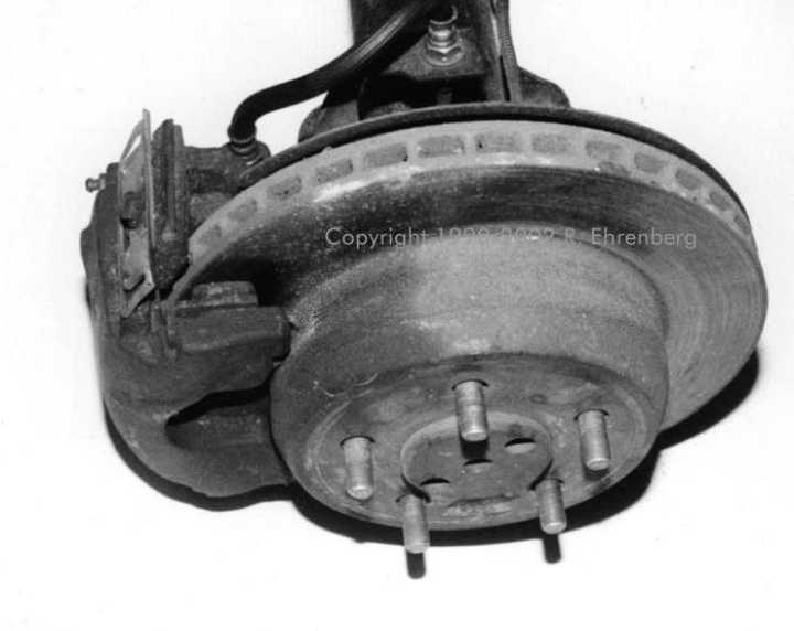

>> To avoid confusion in the rotor size / caliper type selection and parts procurement process, think of the braking components as complete systems. There are two rotor sizes, and two types of caliper (pin and slider). You can swap amongst the setups as longs as you use all the correct, matching components. If you go for the large rotors, you must have caliper adapters designed for such; if you use slider calipers, you must have slider-version adapters.
