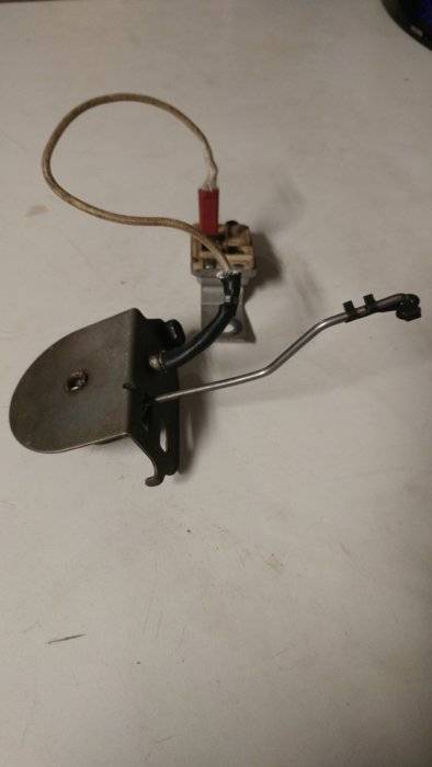

I bought this on Ebay a while ago for mine 73 Cuda and this was how it was listed. It looks identical to the old one with the wire lead on it.

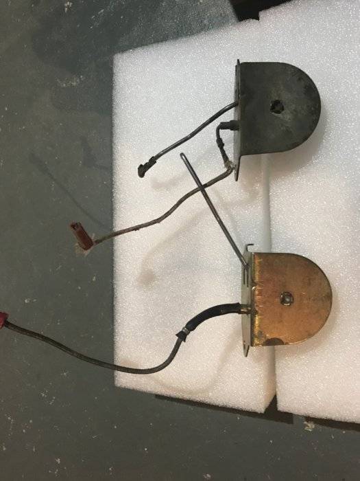

Thanks for the pic. I think the only difference in these choke assemblies is probably the length and maybe the bends in the rod.
I just need to find out the correct part number for the 340 application.

So the parts book show 3698355 fitting ALL Thermoquad setups no matter if it's 340/400/440. I'm a little surprised-I would think there would be different rod styles and lengths.

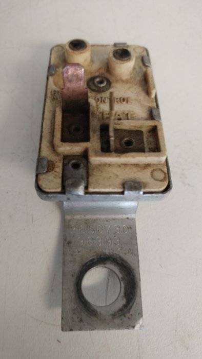

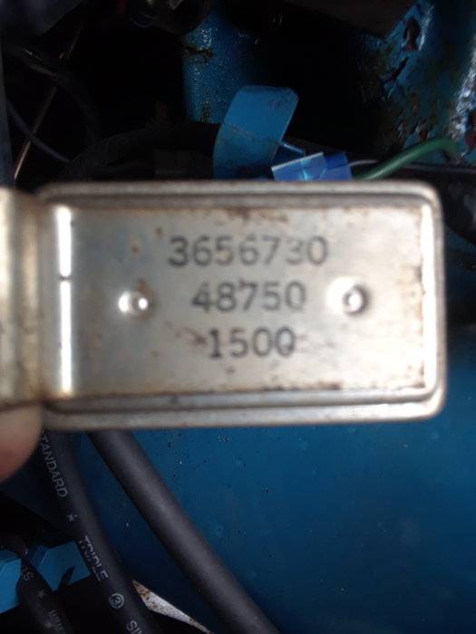

Do you have a part number for the part the choke plugs into?
The part number I found in the catalog is 3656730 (the same one bennydodge posted).
I just looked at the choke control in the car and it says: 48750 Under that is: Choke Cont and Under that is: BAT

Rich
My numbers came from the porcelain, not the metal. I will get the numbers off the metal tomorrow.
