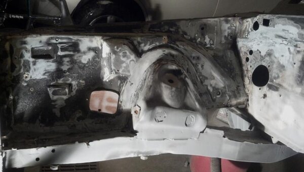

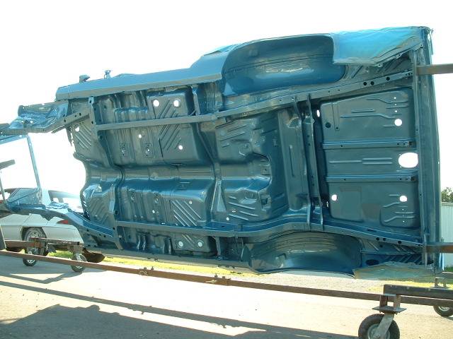

I have my car up on the rotisserie I built. I have taken off all the rubberised undercoating, sandblasted, sprayed some shaker cans of self etching primer on the underside of the car to prevent any surface rust from forming. Patched the frame rails where needed to have some new metal welded in. Built my frame rail conctors and torque boxes that will be welded in after the car is back on it's wheels. The guy I bought the car from last summer already put in new floor pans.
Today's question is what should I use to put on the underbody of the car? I was thinking something called "chassie saver" by magnet paints.

Or you can just go with a rubberized undercoating. Seriously, this stuff gets a bad rap, but back up a minute and ask yourself what did the metal look like under the undercoating you took off?
My '69 Sport Satellite sits on the ground. The rails and the floor pan are fairly clean. And that's thanks to the factory undercoating. Sure, after fourty-three years it's showing some rust. The rockers are gone. So are the quarters, but how many fourty-three year old cars do you know of, after sitting this long, have clean frame rails and a floor pan that are still strong. And this was after being driven in PA and NY winters, too.
Undercoating usually gets a bad rap because of the aftermarket places like Ziebart. Why? Because in order to work correctly it needs to be applied to absolutely clean sheetmetal. Ziebart was usually applied to cars that already had some mileage on 'em. Road film, some rust already starting along the pinch welds, small pockets of dirt already accumulating inside the rails, those are death to getting undercoating to stick.
Use a spray-on truck bedliner if you want. They work, there's no doubt about it. It's proven by all the truck beds out there that have stood up to the abuse. But don't sell undercoating short, either.

If you want corrosion protection, use it externally. It will then protect your sheet metal, insulate against hot exhaust, deaden sound, not affected by petroleum based solvents, fire resistant. Does the same job as undercoating and much,much more. Just depends on your wallet and what you expect from your coating. Anything is an improvement over nothing.

I wouldn't. I had it in a bed of a truck that I bought and it did not hold up to uv rays. I removed what I could and sprayed over the remainder with SPI bedliner and love it. I use SPI (Southern Polyurethanes Inc.) products and they have the best products and unmatched customer service. The best I have ever seen. Can be rolled on also. It's a 2k product and has the texture of LineX if sprayed using the right technique. Give Barry a call. http://www.southernpolyurethanes.com/

Ask yourself if you really need to, or really want to, replace the undercoating that you just stripped off. I stripped the undercoating off my Cuda and left it off. The underside is painted body colour. I don't drive the car in conditions that would warrant re-applying undercoating.

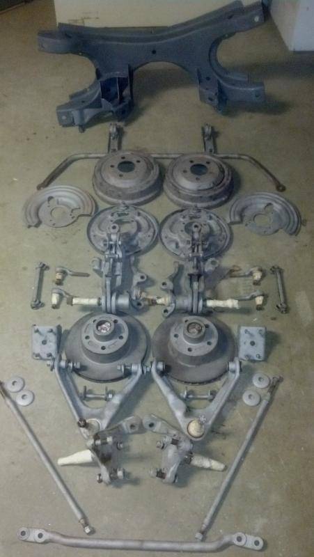

Thank you very much for the input! Nice Cuda by the way! I was going to put POR-15 on it but that is ment for bare metal and I already put some shaker cans of etching primer on the bare metal to keep it from rusting. Soooooo after I finish my metal work that needs to be done on the car I think I will be spraying epoxy primer then a top coat of either paint or some kind of chassis black. Someone reccomented after the epoxy primer to use Rust-Olium?? I want to make this car a "driver" so I would imagine that I would be running into some bad weather from time to time. Although once the salt goes on the road in November or December, the Challenger will come off the road and in my garage. Damn car spent it's life in New England and I keep running into thin metal that needs to be replaced. That's okay, I am having a lot of fun with the car. 2 years from now it will be cool to take a look back at all the work I did. There is light at the end of the tunnel. It will just take a little more time than expected.

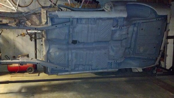

Below is car on my home made rotisserie and my sandblasted front suspension parts that are now coated with silver KBS "Rust Seal" that is kind of like POR-15 but comes in different colors. K-frame is sandblasted and epoxy primed.

Rust-o-leum would be best as the primer not the top coat. Nobody knows but you what conditions you are likely to see with your car. Some people have a museum to put their car in, so it doesn't need any type of undercoat. Some areas are prone to salt and other corrosives so they need more protection. It is always better to do a little better job now than to wish you did it later. I would just stay away from petroleum, tar type coatings. Good luck with your car and keep the pictures coming.

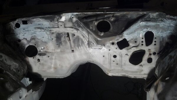

"Pound to fit, paint to match"!!. Sure hope this all starts to look better when I get some primer on it. Looks pretty colorfull right now but there is metal where metal needs to be and for the most part all the rust is gone. Had a question about all the little holes for mounting this and that in the inner fenders. I was thinking of filling them all in and starting over when I start to build. Any thoughts? I was also thinking about going with the ISIS control system and a Vintage Air heating and cooling set up. Happy holidays everyone! It's finally snowing here in Vermont!

Vintage Air is tops in the industry, good choice. If you are going to fill the holes, it is a good idea to photograph the compartment before you do. It will be much easier to figure out where they were. When doing any type of repair or restoration of any part of your car, it just makes sense not to have to rely only on memory how everything went on and where. Looking good. Keep it coming.
You might also consider powder coating your component parts. Contact Dave at Totally Auto. He offers component restoring, Cad,zinc, plateing for screws and other parts that came plated from the factory. Reasonable pricing also. www.totallyautoinc.com
