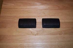

Here's a picture of the type of pads I have

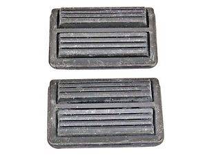

So are you saying the pedals on my car are are tapered. If that's the case I could just get some tapered pads

70 - 72 have slightly tapered pads.
73 - 74 have the completely square pads.
The difference is fairly obvious once you recognise both types.
Post a photo of the kits you purchased.

I have a 73 Challenger that has the square pads as seen in the 1st photo I posted. I also have the bezels for the tappered pads. My question is will the tappered pads fit on the 73 pedals?
