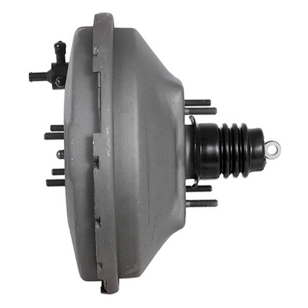

The rebuilt boosters arm that goes into the car, has a hoop for the peg/cotter pin to attach to the pedal assembly.
This hoop was to big for the pedal assembly to fit over, so I had to grind it down a bit, see right side of first pic for the hoop. I did not take much to grind it slimmer.

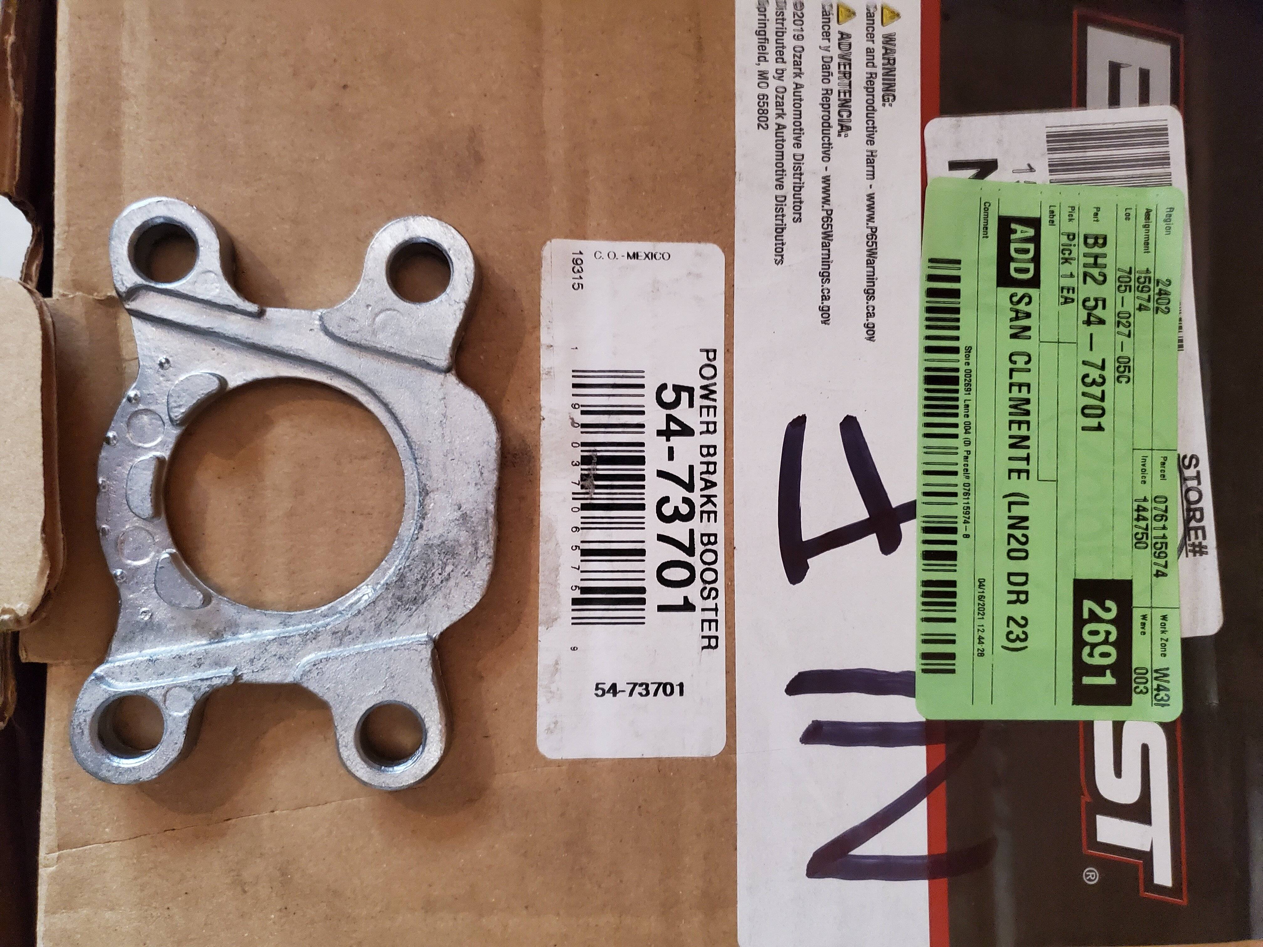

the booster came with a spacer ( see pic 2), at first I thought I needed to include this on the master cylinder side, however with it installed the pedal goes to floow meaning to much space between the booster rod and master cylinder. So I just removed it and all is well.
