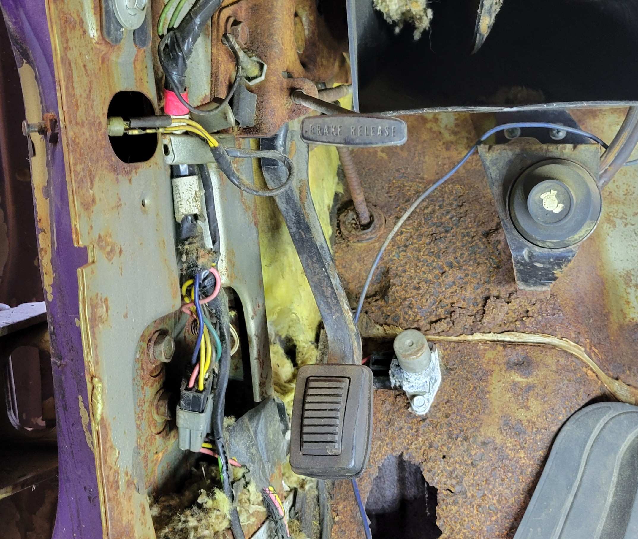

I replaced the parking brake cables and all is working great. I am trying to determine what color wire connects to the Parking Brake assembly switch (it was not connected prior to my repairs).

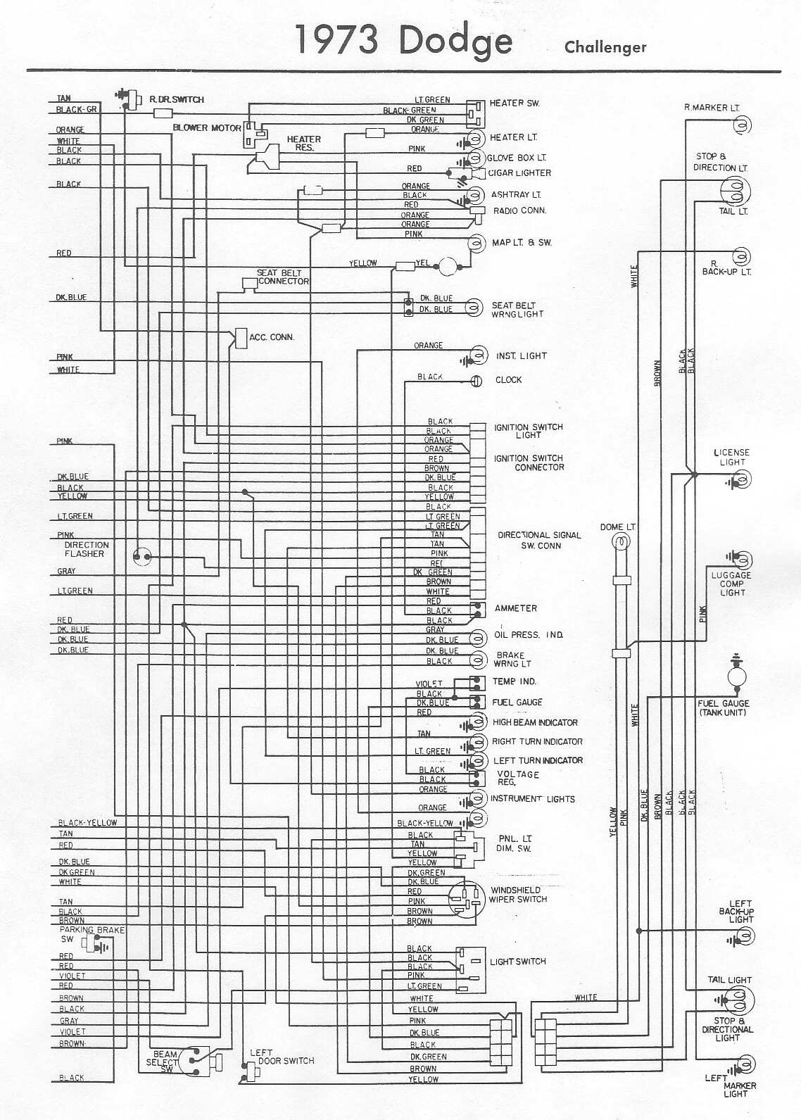

I checked my factory manual but only find the wiring color codes for the engine bay switch.
Can anyone tell me what color wire goes to the Parking brake assembly?
Don't know if this helps, My car is a 70 Challenger, but wiring here appears to be the same. I took this pic just before removal. As ItsJustMe points out, it is Black!
Circling back to say thank you to those who responded. I pulled gauge cluster out and found the resto shop 1) mis-wired the hot side to the lighting circuit and 2) the switch side to the Tach line :( . Rewired correctly and all is right with the world.
