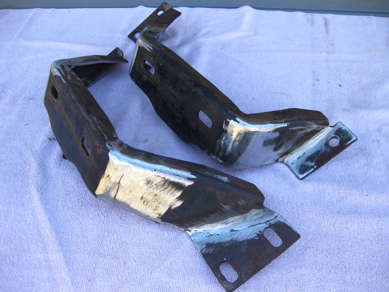

    I'm doing 70 bumpers on my 73. I Bought 70 brackets to bring the bumpers in closer to the quarters & fenders. Much cleaner appearance too.

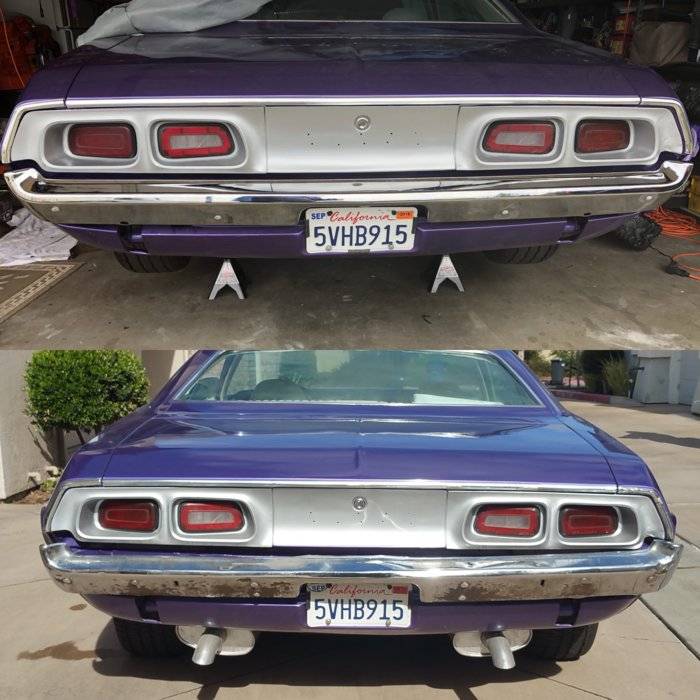

    Here are the before and after pictures
