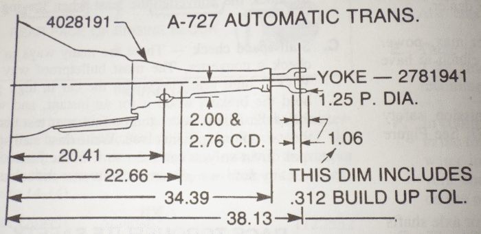

You might check your slip yoke fit in the new trans.
Some dims from the MP Chassis manual...…….
